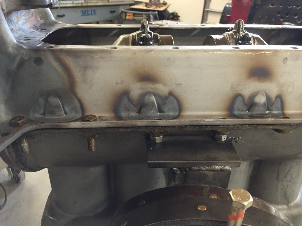

I’m probably gonna catch some flack for this...

Crap - I wish my c.c. dimples were that CLEAN !!!

The spacer is only half of the solution... the dimples at the pan flange are needed as well. Take note of the rod nuts in my pic above. The 12 point nuts are much lower profile and so will require a much smaller dimple

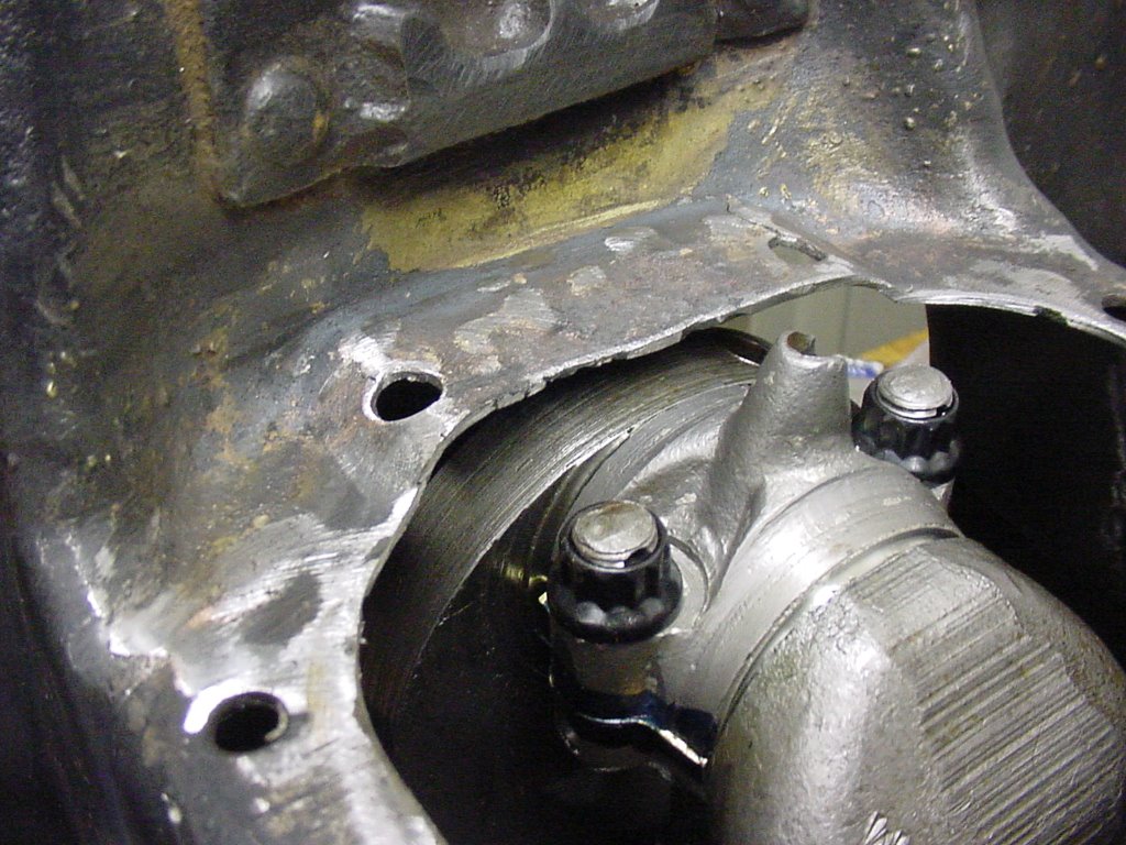

I used the Lang’s pan spacer on the motor pictured above. The rear horseshoe is a notorious clearance problem at the 2 rear most bolts. Typically a section of the rear horseshoe is cut out, and the 2 rear most threads are nearly removed to clear the rear crank web.
With this motor, I abandoned the 2 rear most bolts in the horseshoe, and threaded the corresponding holes in the aluminum spacer. This allowed me to cut off the horseshoe and prevent the tight clearance area. No leaks so far (from this area), and didn’t worry about stripping the threads either

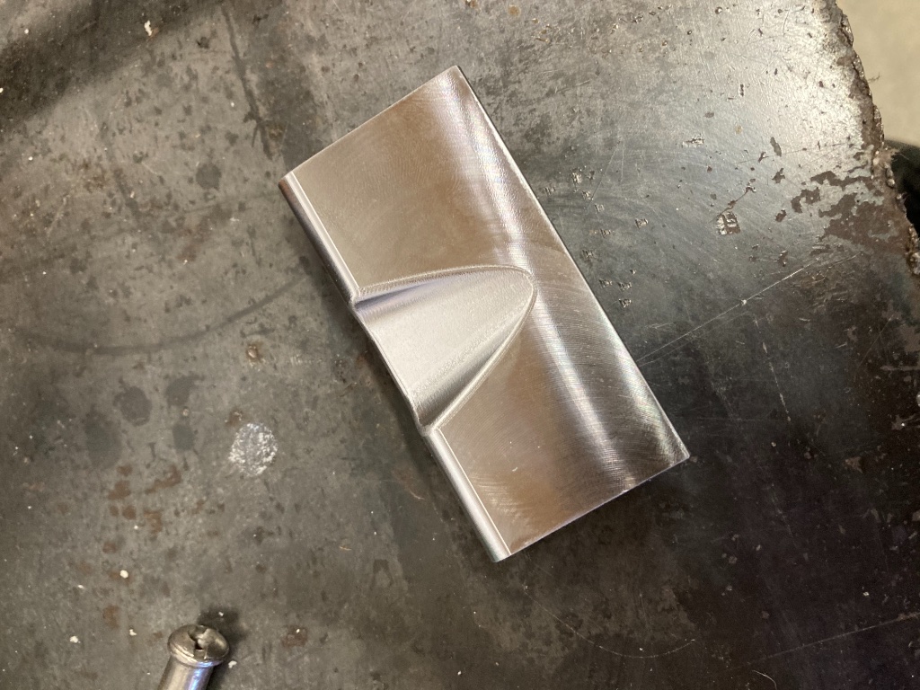

Kevin, thanks for the picture. I have seen it elsewhere before and I thought it looked like a die was used. Makes for a real nice job. Is there a male portion to it? I am using forged rods with cap screws, no dippers and inserts from Antique Engine Rebuilding so only need minimal clearance. I was hoping someone had a secret method like "use a piece of 1/2" black pipe and a rose bud, heat and beat to fit". I hate to ball peen it to death.
Dan, your picture shows my next issue after rod clearance. I am using a 4 dip pan with no dipper plate and a Sherman aluminum pan (pressure oil) so no spacer required, I think, but I will need to make room for that crank web similar to what you show.

I made a special hammer to form the dimple into the die. Basically a bunch of scrap steel welded together in the shape of a hammer, with a piece of 1/2” rod for a striking surface. With this hammer, a #2 welding torch tip, and a few vice grips holding the die in the right place, the dimples are a piece of cake!
