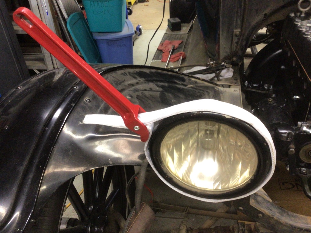

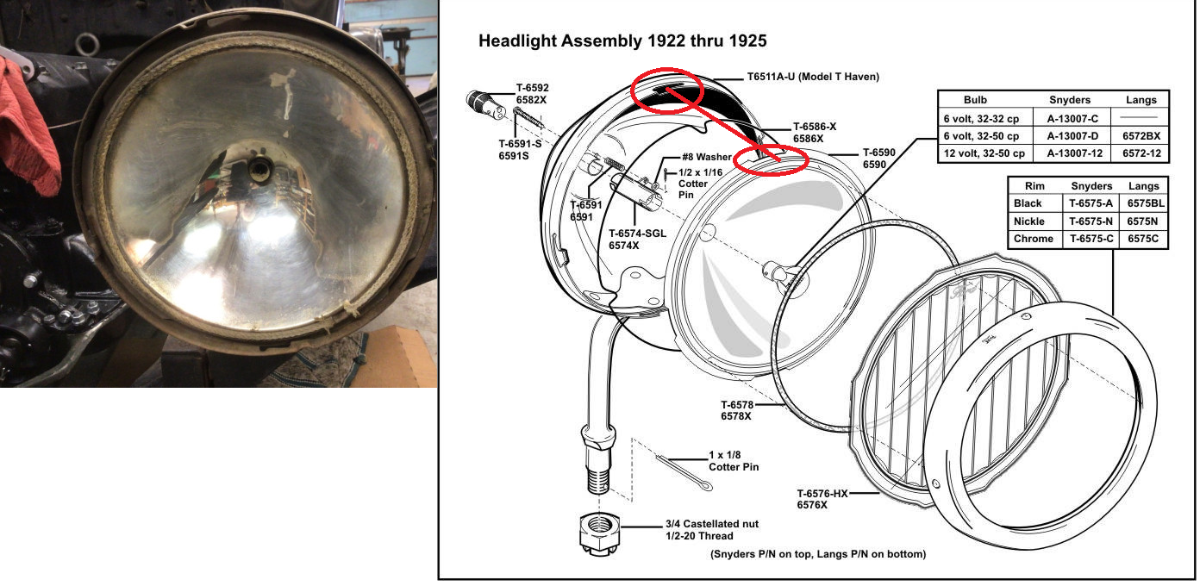

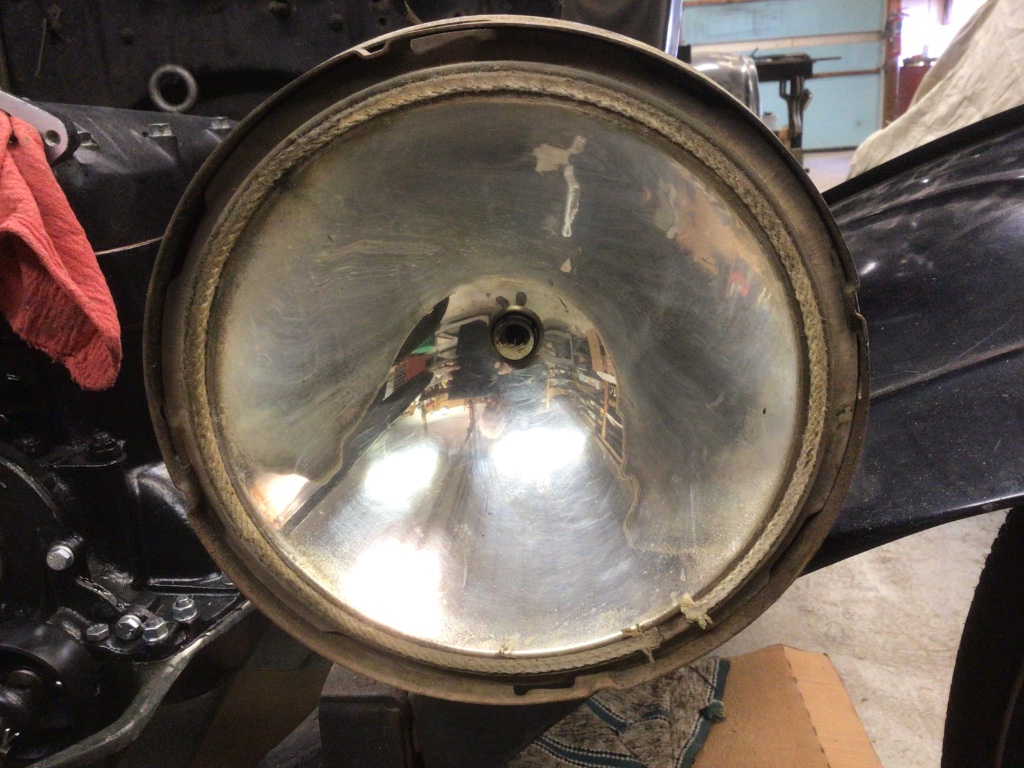

How do you remove reflector on a 24 ? The parts list shows a wire spring. The reflector will push in and looks like slots could be turned line up with tabs in bucket.
Also this inexpensive strap wrench that I had worked good to remove rim.
https://aboloxtools.com/Williams-40221? ... %20%2411.1
John

he reflector slots need to align with the cutout on the bucket and you may need to rotate i. Chances are things are a bit sticky. You may need to compress the reflector to rotate it into position. Sometimes kneading the edge or the reflector helps loosen things. A gentle prying around the edge of the reflector as a last resort
