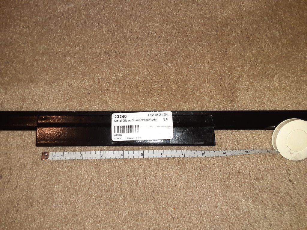

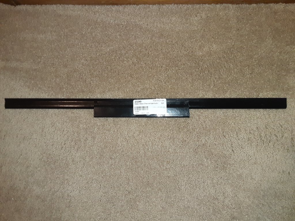

I have ordered new glass for the doors in my 1927 coupe and have purchased the medal channel that attaches the glass to the window regulator. The portion of the medal channel that will engage the regulator is 8.5 inches long as shown in the attached photo. The same part on my existing channel is 12 inches. Will this be a problem?
I understand the new medal channel is actually for the Model A, and that there is no new channel for the T.

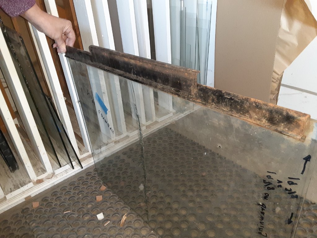

there does not seem to be anything wrong with the original channel, based on this picture and the others you posted on another thread regarding replacing glass
Why are you replacing it, and regardless of reason, why replace it with the wrong part?

Ditto. Replacing correct original parts with incorrect new parts is not good policy. From what I have seen of your T, I would guess that virtually every part is in good reusable condition. You should always try to reuse the original parts instead of replacing them with new parts. It is ashame to discard good original parts that have traveled through the decades with the car since they were installed by Ford workers on the assembly line in 1927. New is not always better. In the case of Model T’s, it is almost always worse when considering how well the original parts were made. Jim Patrick

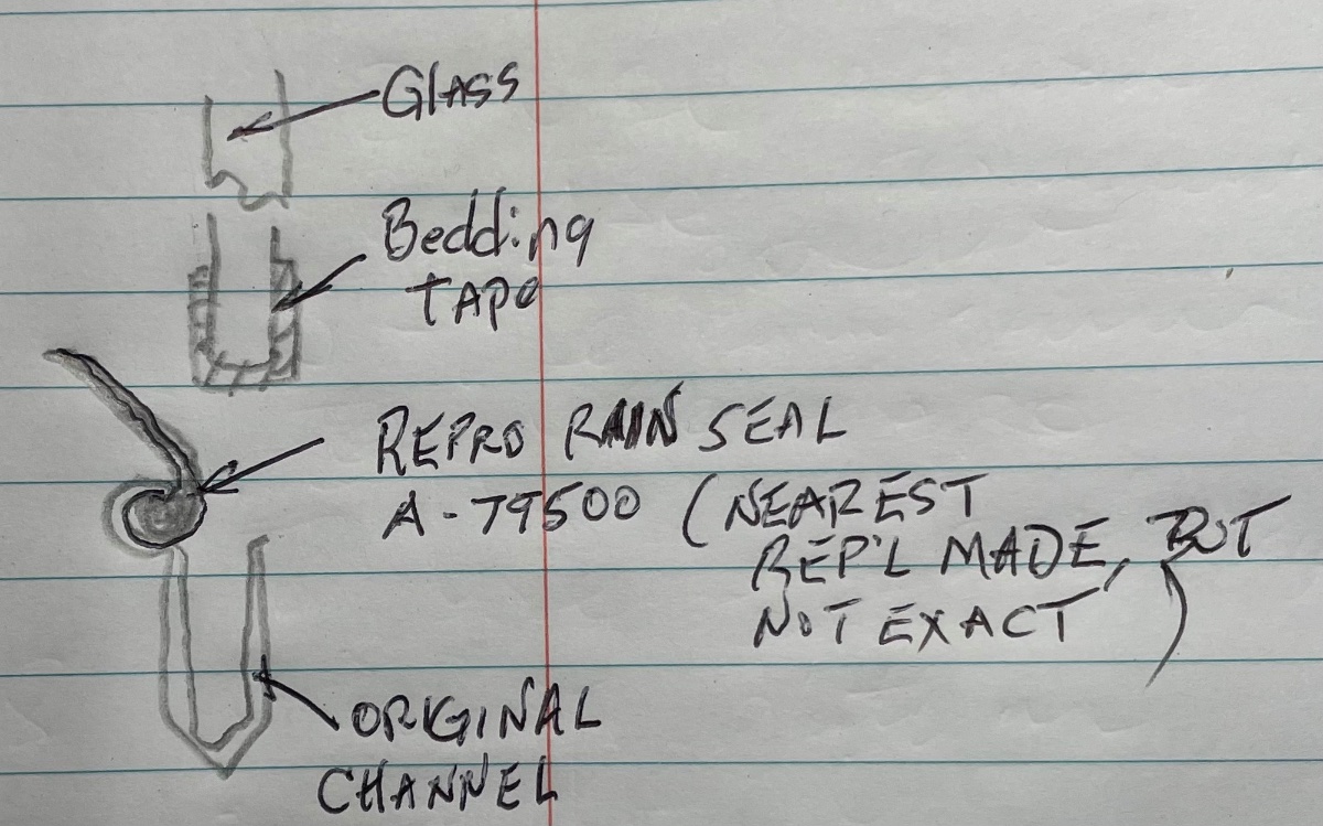

Would be best to use original, as the lift bar length may be necessary. Plus your original has the rolled outer edge for the rubber rain seal, when the window is up, helps prevent water entering. Can just see the old hard remains of the original seal against the plate glass in your widow.
Believe the only rubber replacement is Model A closed car windshield seal, comes in shorter lengths but likely you have to trim a bit to fit. That seal must go in before the glass is fitted. You can check earlier posts by google ‘mtfca forum coupe window seal’

The new glass channel you have is the wrong part. If you insist on buying a new part it needs to be for a 1928 Model A pickup door, not a Model A coupe/tudor door which is what you have. Throw it away and use your original glass channel.

Going forward, if a part is not broken, worn through, irretrievably bent, rusted through, or rotted you should re-use it, Rust is okay. Even if it is rusted through, it can be repaired with rust remover (I prefer Muriatic acid on steel only. Not on aluminum or cast iron), body filler, primer and paint. Except for some minor splits in a couple of slats that could have been repaired stronger than the wood with Titebond yellow wood glue, even the wood in your roof looked great to me and having originally been fitted by Ford woodworkers who made wooden roofs on the assembly line everyday for years, there is no way to duplicate the experience they brought to the table. Even the wood was better and harder back then having come from old growth forests instead of harvested soft, new growth wood. You seem to think that old is bad and new is good. Not! Always keep in mind that you have 95 year old car with original parts that are better made and much better fitting than the thin repro parts available today. You can prove this to yourself by holing an old part in one hand and a new part in the other. Having more steel, the old part will feel heavier and more solid. Try to keep it as original as possible. Best of all, using the original parts will save you a fortune. Jim Patrick

Going by your pic of the original channel it’s still in solid usable condition and just needs a good cleanup and repainting. It can be tempting to use “new” parts when restoring an old car when it’s not really necessary. I have 3 T’s and in my limited experience original parts that are still good are the best fitting parts.
It’s your car and if you can find a channel that’s new or a good original that’s fine too.

I just replaced the windows in our 1927 Tudor and used new channels with 8 1/2" regulator track. After everything was back in place, the regulator ran right off the end of the track due to it being shorter than original.
I had to cut the channels down to be able to shift them 1 1/2" towards the front. This relocates the regulator track and keeps the regulator arm trapped even when the window is at the bottom of its movement.
Not sure why the window channels come up short but both Lang's and Snyder's window channels have the same 8 1/2" regulator track length.

Since you haven’t used the reproduction window channel now would be a good time to call the source you bought it from and tell them the section that the roller goes in is to short. Others have had the same issue.
They can tell their supplier and hopefully that will correct the issue.
They will never know about the issue unless a 26-27 owner calls and tells them.
Lang’s has the bottom window channel listed in their catalog and the cat. no is not the same as yours.
Lang’s is 8020CH. I think yours is different.
But if you got it from Lang’s call and tell them about it. They have always been helpful to me.
