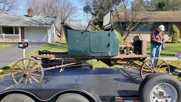

Re: Lurker no longer - Now a 1915? Model T Owner - Body # questions
I'm digging the old paint on the body.
Looks like a good start to a T.
Me too... the green paint just look 'right' on this car.

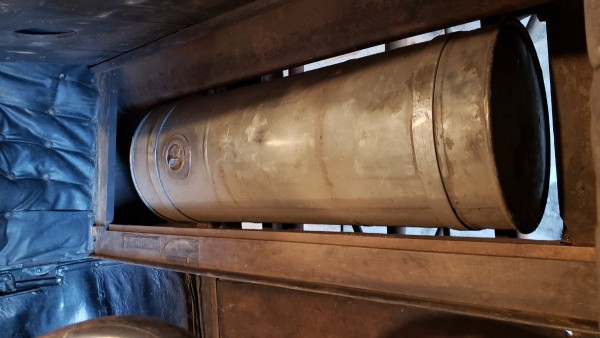

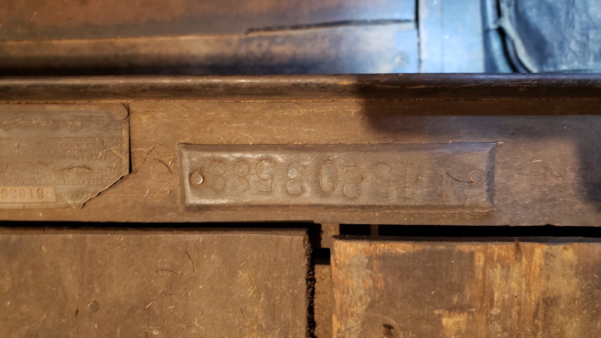

I can see the metal body tag on the seat riser in your last photo.
It appears to have a Beaudette body tag. If the body is from January 1915, then there should be a dot between the month, year, and serial number as follows:
1 * 15 * 203588 (the dots, represented as asterisks here, would actually be more on center)
The patent plate firewall tag that someone mounted on the seat riser would not match the serial number on the original block as those numbers diverged earlier in Model T production.
I can see in the photo that your door handle is the 1915, 1916 and early 1917 style.
The high armrests are not indicative of a 1915 body. However, that may be neither here nor there as something "Mickey Mouse" going on there because the top bracket is too far forward for a touring (or a roadster, for that matter). Someone has added roadster top brackets to the back of the seat.
If you want someone to scrutinize the body, I suggest contacting Royce Peterson at his website, https://modeltfordfix.com
Your car is a collage or a marriage of various parts so discussing what is or isn't correct is somewhat beside the point.

You may very well have a very early 1915 touring car. The wider/shorter tag appears to be the body tag and someone did you great favor when they tacked it on the seat frame!
It was located on the left of the dash just under the cowl which has marked the tag upper left corner if I'm seeing it correctly. Please show us another closeup of the tags if you will.
"Real" 1915 Touring cars are few and far between. The "1 15 203588" tends to confirm early '15 as well.
Other examples of tags at this time tend to show that your car probably had an engine number in the vicinity of #620,000. I also believe that the body is probably a Beaudette. You may find a "B" on the heel kick panel just under where the tags are tacked. See if there is a B there when you have a chance.
Very interesting car and look forward to some more photos!

The 1915 style open cars were delayed due to difficulties manufacturing the new cowl design. The sheet metal presses used for the earlier style bodies did not quite handle the more complex shapes for the new cowl. Therefore, real production of the '15 style cars did not begin until January 1915. The body number indicates that your touring car may have been among the first few hundred such cars built, assuming the body tag is original to the car. Under the front seat is not generally the original location for either of those body tags. The steel tag (beginning 1 15 xxx) was generally nailed to the floor sills or risers, under the front floor mat. The fancier brass tag should have been on the inside of the firewall above the steering column base. The serial number on that brass plate was sometimes called the "car number", however, it was NOT the car's serial number which officially was the engine's serial number. In the beginning of model T production, the car and engine numbers did match, at least on some cars. However, after a couple years, the two numbers drifted apart and the "car" number became a combination of meaningless, and downright confusing. Sometime fairly early in 1915 style production, Ford quit stamping those brass firewall plates with any number, although the same plate with the boss to stamp a number continued to be used as the patent information tag (without the number stamped) for about two years. That tag was then replaced with a smaller aluminum tag for the rest of production.
The "serial" number stamped on the brass tag does not give a real manufacture date, although it can narrow down the time-frame a bit. For most of brass era model T production, there was no reliable comparison between the three numbers. Body's dated numbers give an approximation what month it was built, and engine serial numbers can tell you what day the engine was officially assembled. However, what day those things were put together is still open to a lot of speculation. Original intact cars have been found with bodies dated well before the engine's date. They have also been found a month or more the other direction. There are many explanations for such discrepancies, we just need to accept much of that.
A great looking project! Make it roadworthy. Enjoy it! Then, maybe, make it a bit more "right" as you go along. It may be one of the earliest real '15s around?

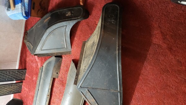

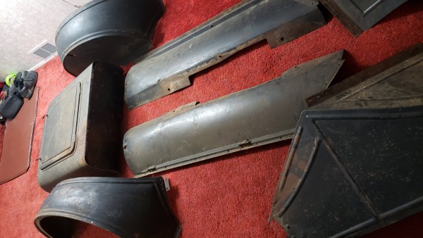

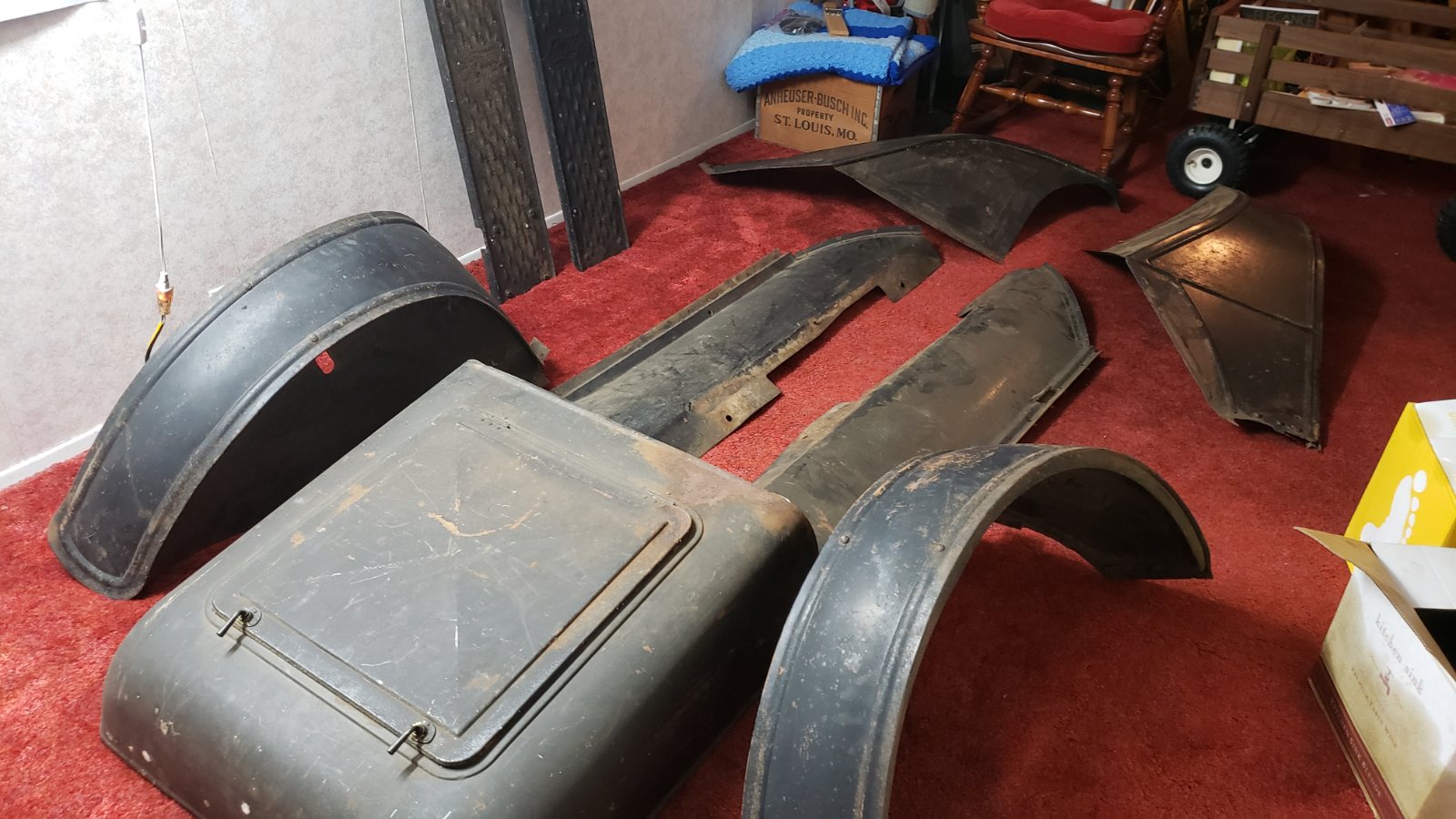

Few more sheet metal shots...

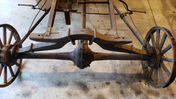

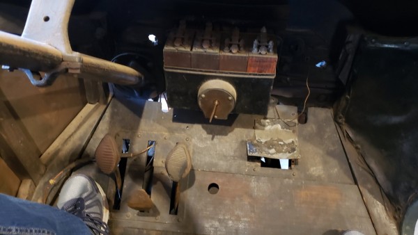

Correct rear axle.
A number of quadrant variations could be found on this early of a 1915. Even a '14 style brass one.
Probably an original dash, bulb horn.
Beautiful T and simply gorgeous turtle deck with the battery cut out in the tin at the front for the 19's! I think.
I'd personally love some pics of the runs in the dipped paint on your turtle deck. I have one that looks almost the same currently on the '18 here! Lotsa runs, drips but no err's.
Whew, it's already apart. You're not going to paint it are you?
