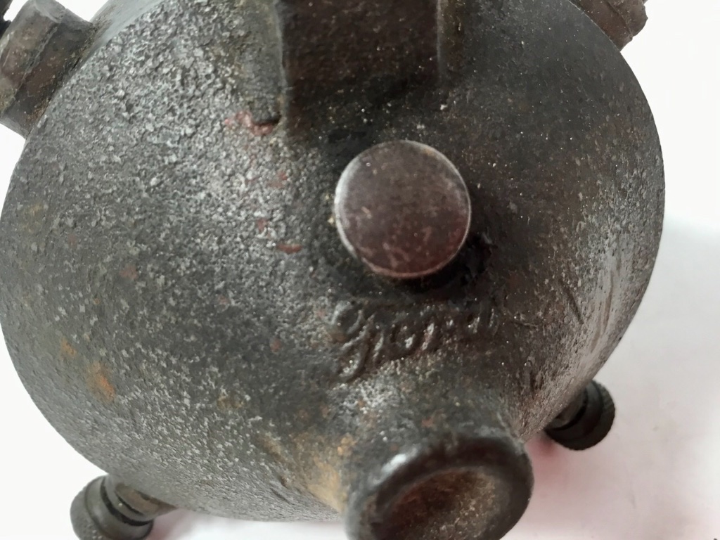

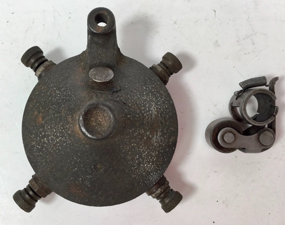

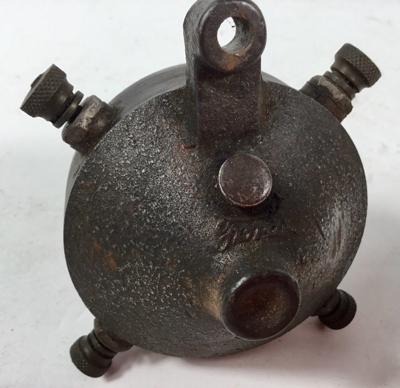

What year did this cast iron Ford script roller type timer come out? Would it be correct for all Model T’’s or is it specific to certain years? I would guess that, due to its’ very old appearance, it would have gone on a very early T, but I don’t know. Jim Patrick

1916-1920

Thank you. I thought it was earlier than the more recent pressed steel ones. I suppose it will fit and work in all Model T’s? Jim Patrick

... I suppose it will fit and work in all Model T’s?
1912-1927 timers are interchangeable.
