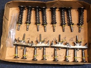

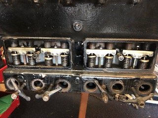

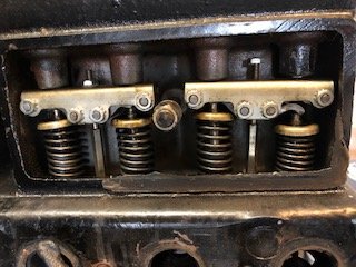

Anybody have any idea how much these Riley Multi-Lifts are worth? I have a full set with valves, springs, lifters etc. that I pulled out of a members '16 engine. Her deceased husband had installed them in an engine that ran but was switched out for another engine but not sure why. As we disassembled the engine it seems to be in working order. They look to be in great condition. Any thoughts on pricing would be helpful as we will probably not use them in the engine we are putting back together. Thanks

Why are they so short lived, just a general lack of oil up to them or something else?

Not having ever actually touched a set of them, I could only guess at things related to wear,and I prefer NOT to guess about stuff like that

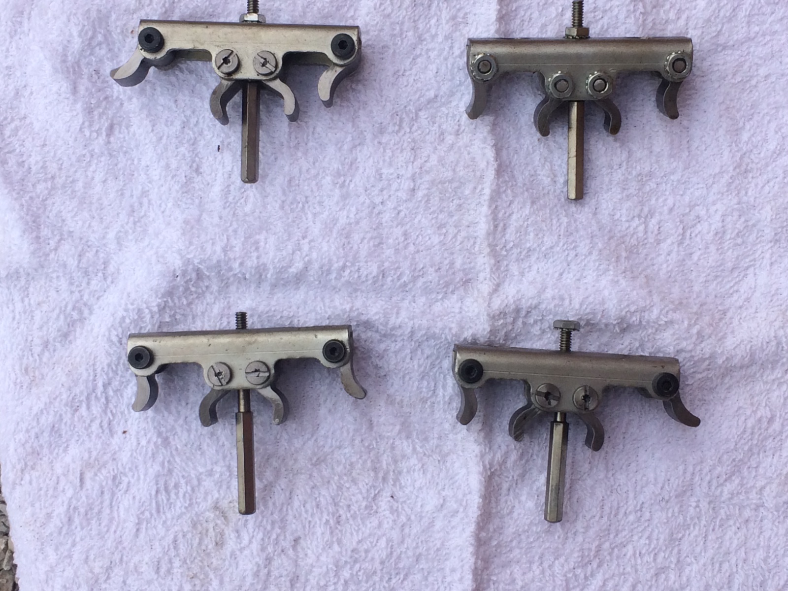

I have received the multi-lifts. Thank you Dean Yoder, a true gentleman!!
I have now had several conversations with Harry Lillo, the only person I know that has had extensive operation experience with them.
Yesterday I did some research and have now concluded that the “cams” are investment cast and heat treated 4140.
Studying the pictures of the originals, I believe that they had a a “locating ring” that coencided with the lifter boss, that is missing on the reproduction ones. I believe this may be the root cause of some operational issues that have been experienced
