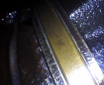

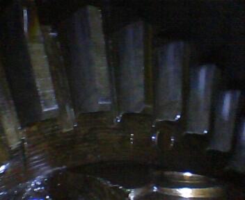

I got most of the oil pumped out of my ‘24’s differential and probed around a bit with a borescope. Is the yellowish component in the first picture the bronze axle thrust bearing everyone says should be there in place of the original babbit? Sorry I couldn’t get a wider view. The second photo is the ring gear for scale (hopefully). There was no evidence of anything silvery in the oil.

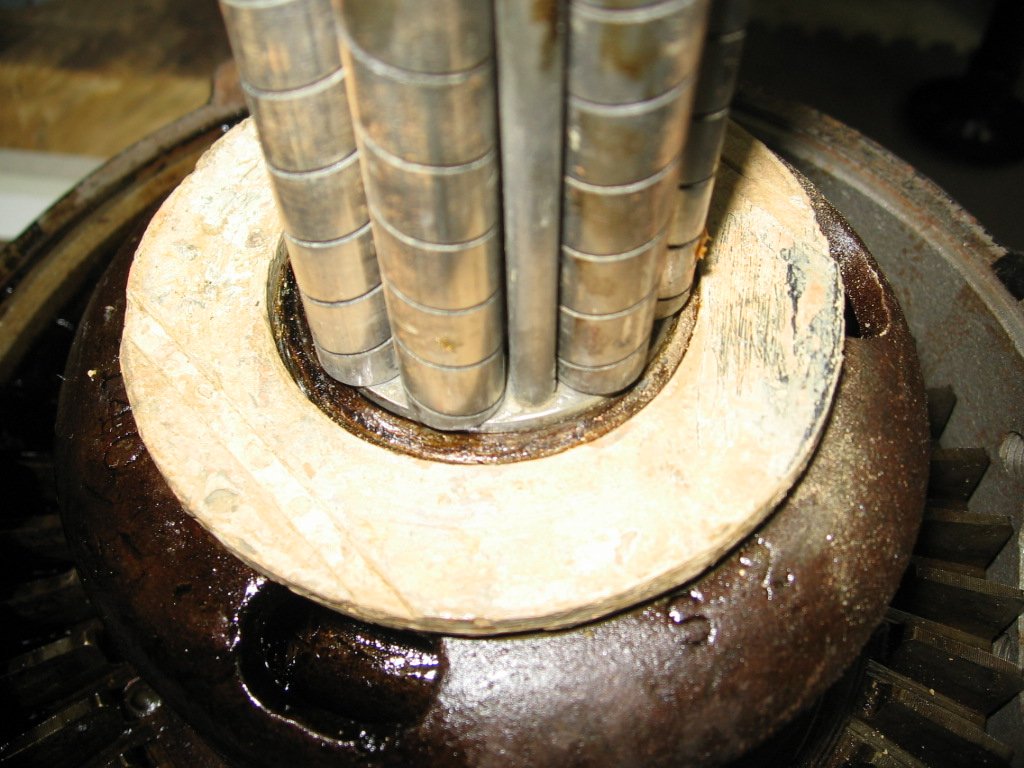

Yours sure looks like bronze to me. Here is a picture of one of the Babbitt thrust washers that I removed from my rear axle when I tore it apart to convert it to a Ruckstell.
Posts: 4458
Re: Bronze Differential Bearing?
Post by Jerry VanOoteghem » Sun Mar 13, 2022 7:10 pm
Sure looks like the bronze thrust bearing to me Miles. Others will contest that you still don't the bearing on the other side is bronze, since it can't be seen. However, I can't fathom anyone changing only 1 of the 2 thrust bearings, especially the one that takes the least beating and is less likely to need replacement. I say you're good to go.

I am relatively sure the component in the first picture is bronze; I just wanted confirmation I was looking in the right place and that it is the thrust washer. From Mark’s photo I’m pretty sure it is. Also, the ring gear teeth show little wear so that makes me better too.

My understanding (and what Lang's sells) is brass for such washers. The brass / bronze thrust washer is sandwiched between two steel washers of a little less than half the thickness. Sure looks like what you have in the first photo.

Surely if it was the Babbit style of Thrust Washer, there would be a large space between the Steel Plates as it would be non existent by now! Bronze for me too.

Yes that is a modern brass one. and every once in a while you find a whole babbitt one. But usualy they are a pile of pieces in the bottum of the Diff.
