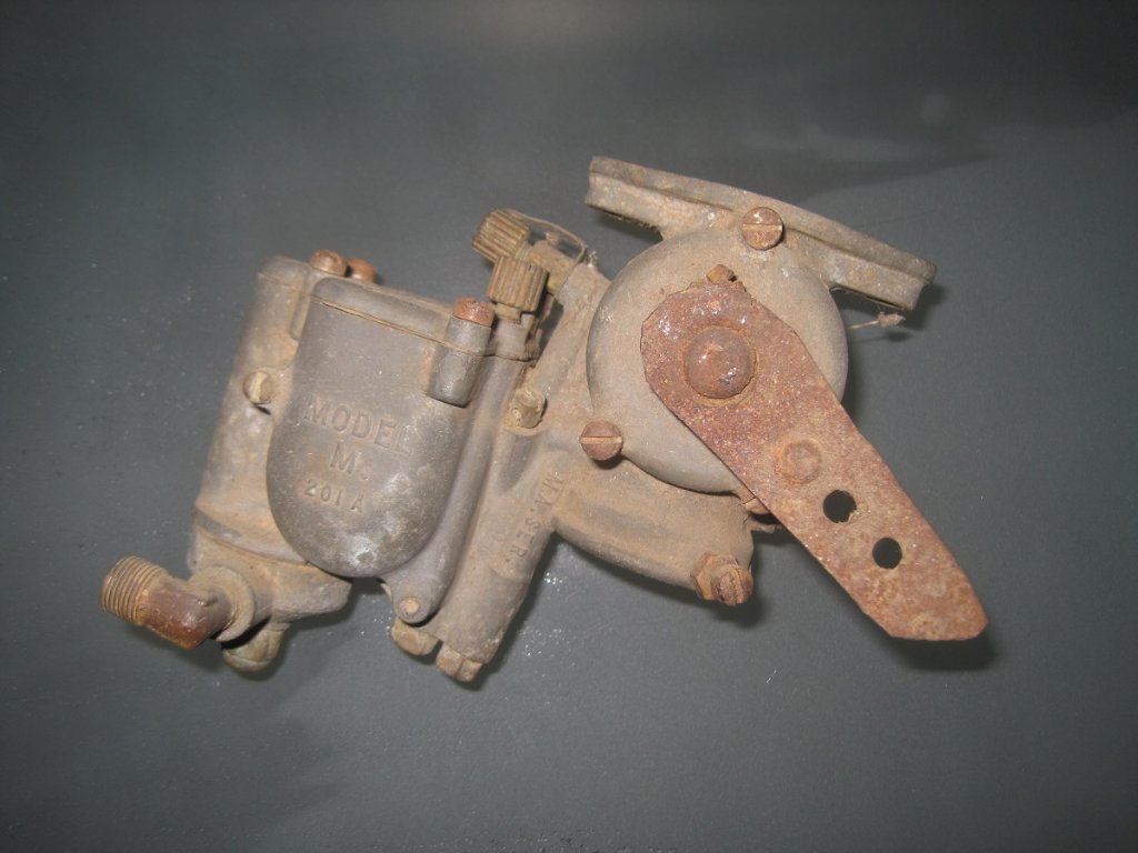

I have a pot-metal Winfield Model M, in Barn-Find condition - which means the barrel is stuck and all the steel parts are rusty. The castings themselves are apparently in good shape but they happen to be made out of Unobtanium and Easibreakium. Has anyone out there successfully rebuilt a Winfield in this condition? What can I do to get it apart without wrecking it?
Dropacent
Posts: 3384
Last Name: Morsher
Location: Norwalk Ohio
Re: Need Advice - Barn Find Winfield Model M
Post by Dropacent » Sun Mar 20, 2022 2:21 pm
I owned on years ago. I believe they were made from better metal than the later models. They are also more period correct for a T My advice would be to take your time, a good penetrant and lots of heat/cool cycles. Looks like a good one!

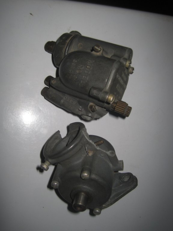

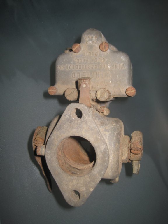

Here's another one I have but it doesn't look as promising as the first one.
Someone drilled holes in it and tied both pieces together with a piece of bailing wire.
