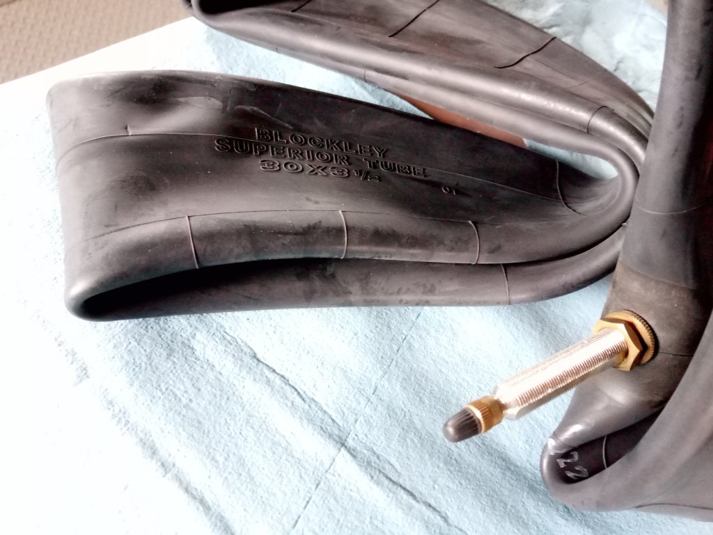

Some may recall my pique at the price quoted for delivery to the USA for 5 tubes from Blockley. Hopefully those same people also read that the price quoted was in serious error and was experienced by another Forum member as well.
Well, here is the upshot. After discovering that the shipping quote was in error and promptly followed up with the correct cost, I purchased a set of 5 tubes. Within 2 minutes, the Blockley System emailed me confirmation of the order and 2 minutes after that, the system followed up with a Tracking Number (how on earth did they manage to pull that off??). This was May 12. Today, 4 short days later, May 16, in the middle of no-where, Wyoming, I am holding 5 gorgeous tubes. I cannot get mail from the East Coast that fast much less a heavy box from the UK.
The tubes are HEAVY! I think heavier than any vintage USA-made tubes I've ever seen. Stems are metal, and if one is offended by them being a different size stem than OEM Model T, then don't order them. Wrong size "cheap-y's" should be available (eventually). I personally believe that the purchase price once converted to $US is a terrific deal relatively to other metal-stemmed tubes and for the weight and speed of delivery, the shipping price was very reasonable. I can easily recommend them and if they serve me like I expect, I will be able to REALLY recommend them.
Lesson from this: Blockley has what appears to be a superior product at reasonable cost. if you think you've been given a bad shipping quote, then by all means question it! It probably is!

Scott, is the stem brass ? It looks "white" in the photo. Thanks for posting all that went into your purchase. The tubes look great !

The stems are bright plated. However, they are brass. Don't ask me how I know.
The stems are the larger era correct size, very close to a number of original era stems I have. They are basically half inch, somewhat larger than the common era model T size. I mounted a four of them into my original wooden felley wheels. Two of my original wheels took the Blockley stems right in with no extra effort required. The other two, had minor burrs inside the steel sleeves through the wooden fellies. I ran a 31/64 drill bit through them, which did not harm the steel sleeves, but knocked down the burrs allowing the stems to slip in easily.

I am told by Blockley that it is nickle, per original stems of the era.

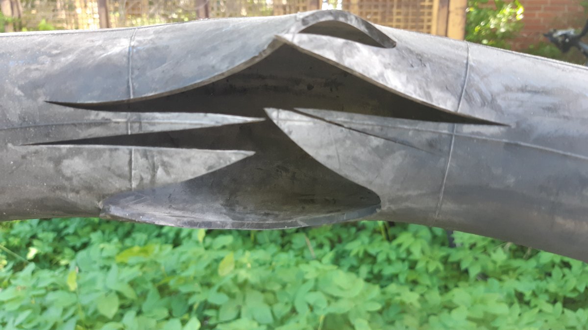

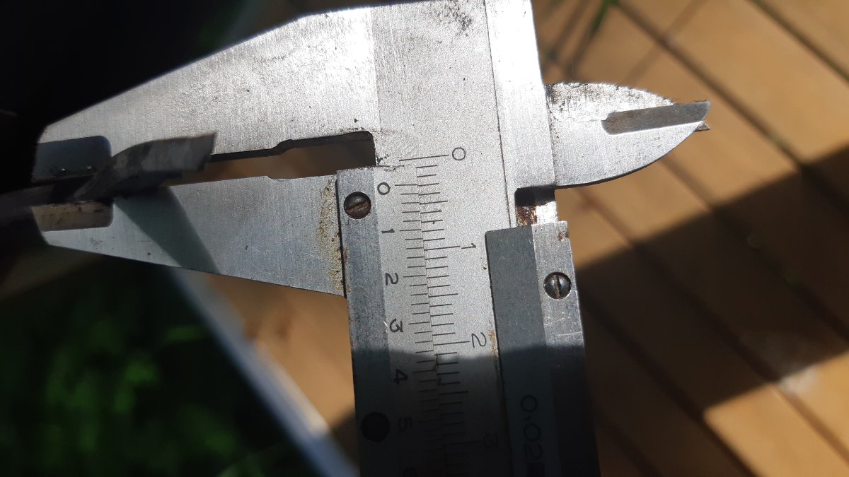

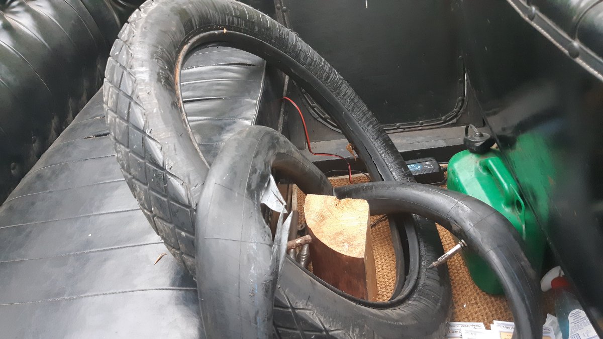

Before anybody cuts their Blokley tubes, I experienced one explode the other day and I can confirm that they are thick! 2 mm I think (0,08").
I'll take a picture and measure with a micrometer.
Oh, why it exploded? Not sure, but I suspect it was squizzed by the tire. 2 years and maybe 1000 miles and it gave up. Tire and tube. Tire was ripped off the wheel

I have several questions. Why doesn't Langs, Coker, Universal or Lukas import these tubes for us in quantity so we don't have to go through all this?
Also, I question the tube pictured above. It obviously has the incorrect valve stem, but are the standard rubber valve stems available too?

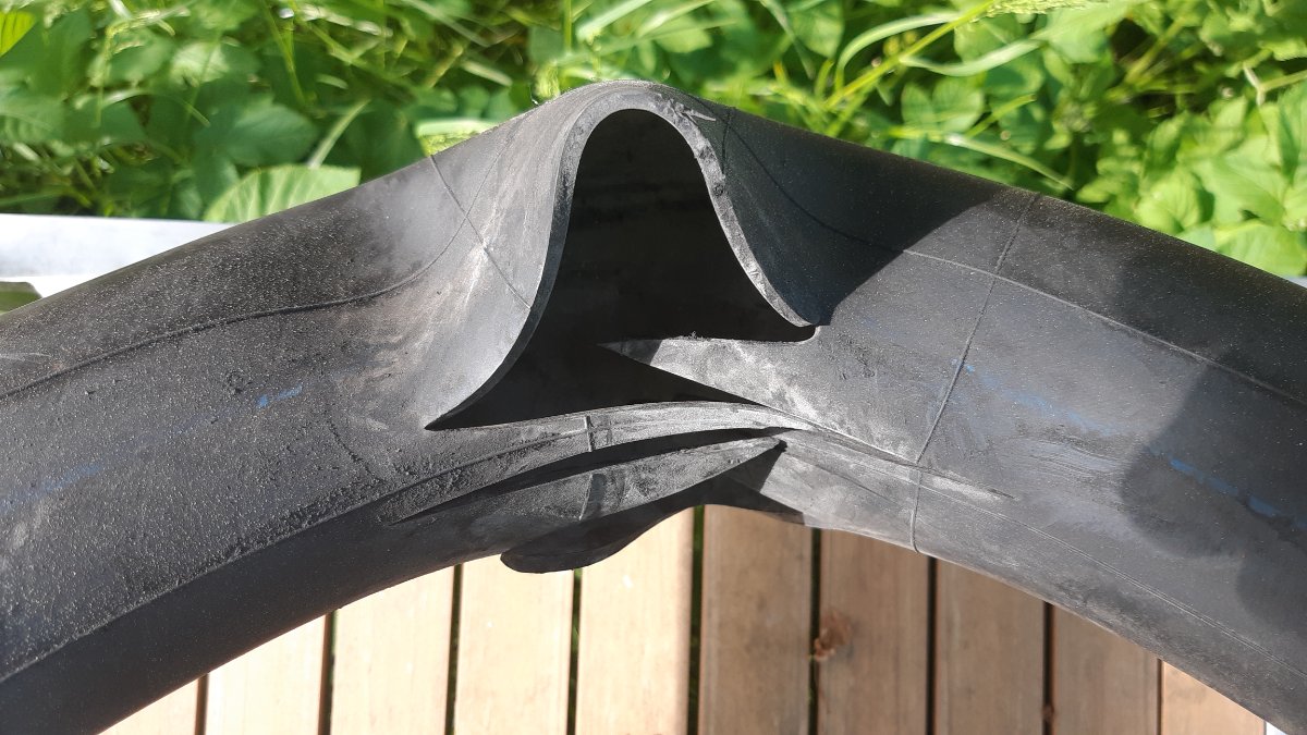

I finally got my blown tube out in the daylight to take some pictures and meassure the thicknes of the rubber.
An exploded Blockley tube - uncertain of reason, but it either was squeezed by the tireflaps OR I drove with to little tirepressure so the tire went of and the tube went off when in contact with the tarmac. I was driving 35 - 40 MPH when this happend on a straight road. Tube wall is 3 mm (0,12") thick:

Why did they choose to not use bridge washers? The tube above appears to be the same thickness as the Firestone tubes I used to buy in the 60's. I now can also see why the tubes back then didn't require flaps.

Michael, for a tube to explode like that there must have been a way for it to expand before it let go. I have only ever seen that type of damage when a bead on the tyre let go, allowing the tube to blow out. Perhaps your suggested low pressure allowed the tyre to run off the bead and away went the tube. That I have seen on a National tour, the tyre rolling on down the road in front of the car as it pulled up.
- Posts: 4381
Re: Blockley inner tube purchase - report
I am pretty sure the tire would have to have come part way off the rim before a tube could blow out that way? The tube would have to have had a lot of air in it after the tire came off to do that much damage to the tube, so not a stem first blowout. The last time I saw a tube like that? The bead had ripped and one side of the tire lifted off the rim allowing the tube to blow out between the tire and rim. I managed to see it just before the Kaboom!
So the question becomes, WHY did the tire lift off the rim?
I see Alan fdu beat me to the post!

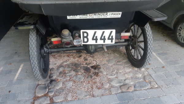

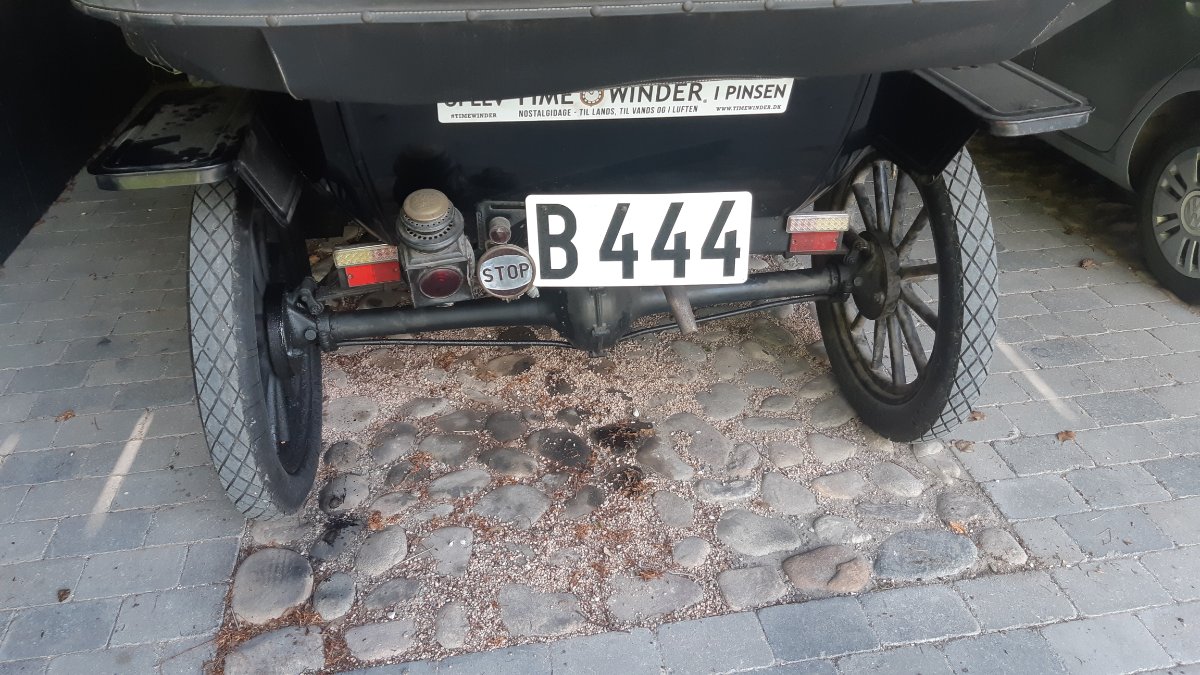

The seal in the rearaxle in that side is not good, so oil leaks out and the inner side of the tire is quite messy in oil. Too little air pressure and the beads may slip free of the rim and the rest is history. I have examined the tire and it have no visible defects so I guess this is what happend.Wayne Sheldon wrote: ↑Sat May 28, 2022 7:50 pmSo the question becomes, WHY did the tire lift off the rim?
(and this was how I unintentional stealed the thread, sorry, Scot!)

OK - to end up this subthread I managed today to put the tire back on with a new spare blockley tube. I had had fears it would be a nightmare to do that with the wheel sitting on the car, but it was remakable easy! I'm tempted to say "Piece of cake"dykker5502 wrote: ↑Sun May 29, 2022 1:17 amThe seal in the rearaxle in that side is not good, so oil leaks out and the inner side of the tire is quite messy in oil. Too little air pressure and the beads may slip free of the rim and the rest is history. I have examined the tire and it have no visible defects so I guess this is what happend.Wayne Sheldon wrote: ↑Sat May 28, 2022 7:50 pmSo the question becomes, WHY did the tire lift off the rim?
For obvious reason I can't say what the tire pressure was in that wheel, but it was just 30 psi in the other rear wheel and also to low in the two frontwheels - so...... circumstancial evidence tells that the tire pressure had been waaaaaay to low.
Ford Model T 1914 Touring

"For obvious reason I can't say what the tire pressure was in that wheel, but it was just 30 psi in the other rear wheel and also to low in the two frontwheels - so...... circumstancial evidence tells that the tire pressure had been waaaaaay to low."
The "usual" pressure-low failure is that the preponderance of friction resistance is between the tube and the tire. Pressure being low allows the tire to slip around the rim, the tube follows the tire (that preponderance of resistance thing!), with the valve stem being held back by the felloe and rim. The tube eventually pulls hard enough that the tube around the valve stem tears resulting in an almost instantaneous total loss of pressure! That then results in the tire coming partially or completely off the rim.
However, if there is a serious problem with the rim or the tire, causing the clincher beads to not hold as they are supposed to? It is possible for the tire to escape the clincher hold, and roll out allowing the tube to blow out the side rather than the usual tear at the valve stem. A significant amount of oil at reduced pressure could allow that to happen.
With properly maintained 65 to 70 psi in the tire, it likely cannot roll out (condition of both clincher beads and rim being good!). HOWEVER! Even at proper pressure, with enough oil in the clincher beads, the tire could slip around the rim and still cause a torn valve stem failure.
Better ry to get that oil leak slowed down!
