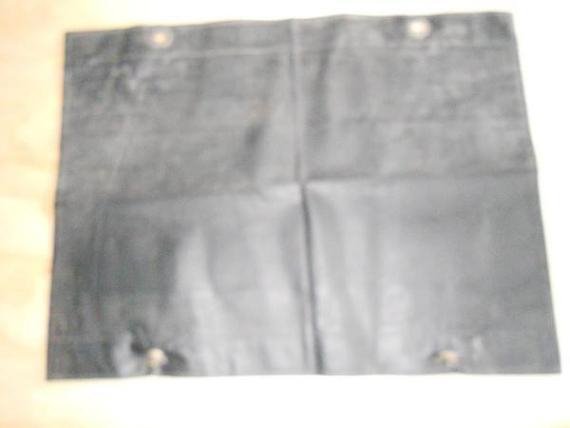

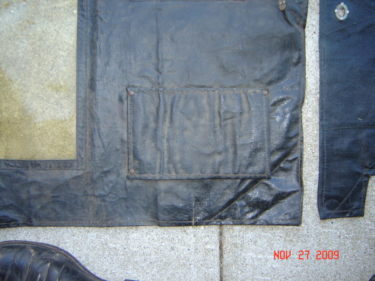

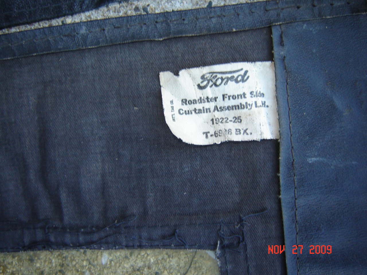

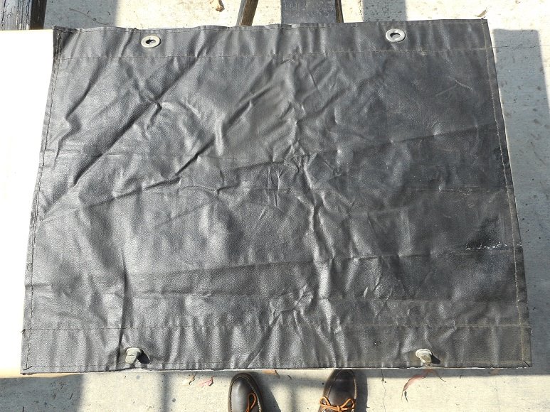

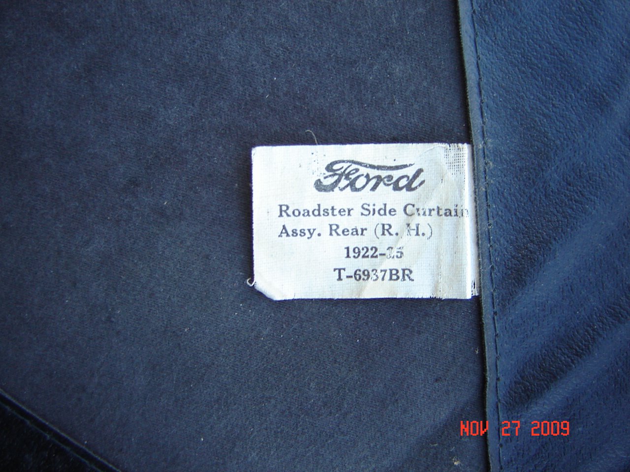

Here are photos of NOS original side curtains that we have. I can only post 5 photos in a posting, so first I will show the right side.

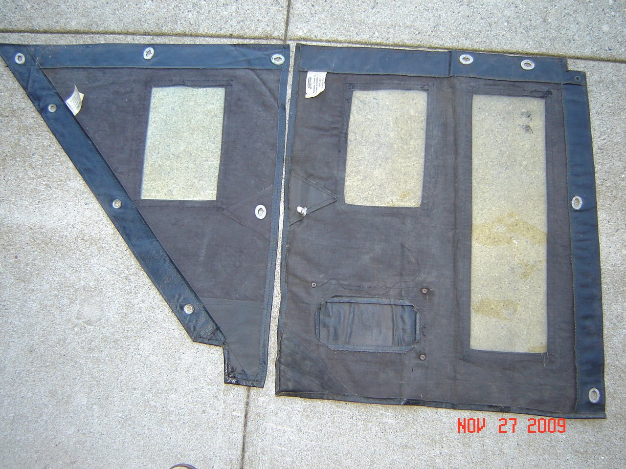

Post by Jim, Sr. » Mon Apr 29, 2019 11:03 pm

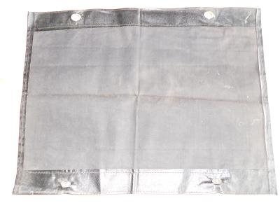

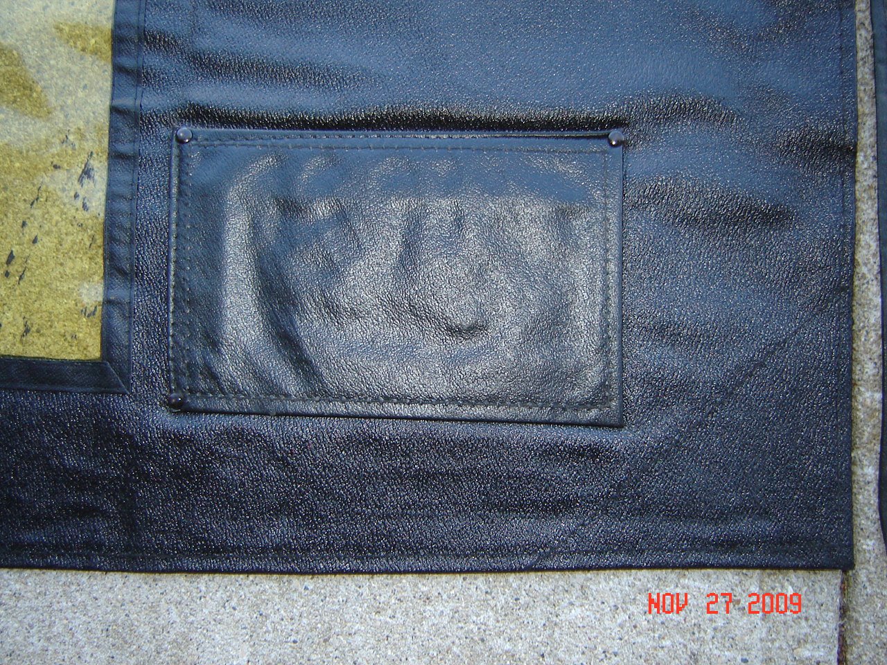

Here is the left side.

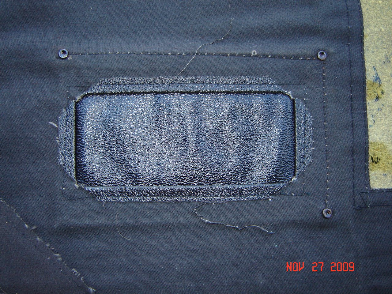

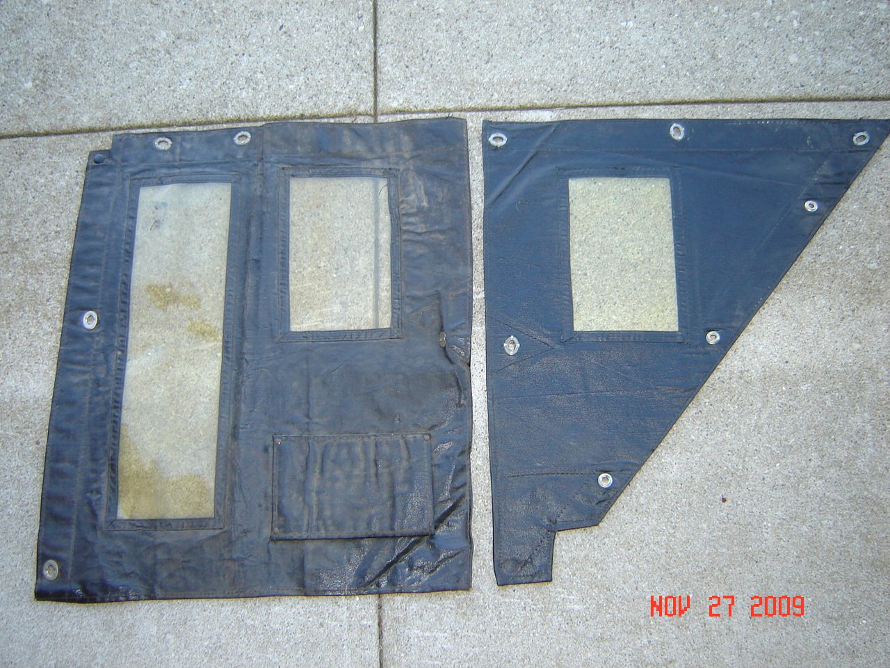

Post by Jim, Sr. » Mon Apr 29, 2019 11:42 pm

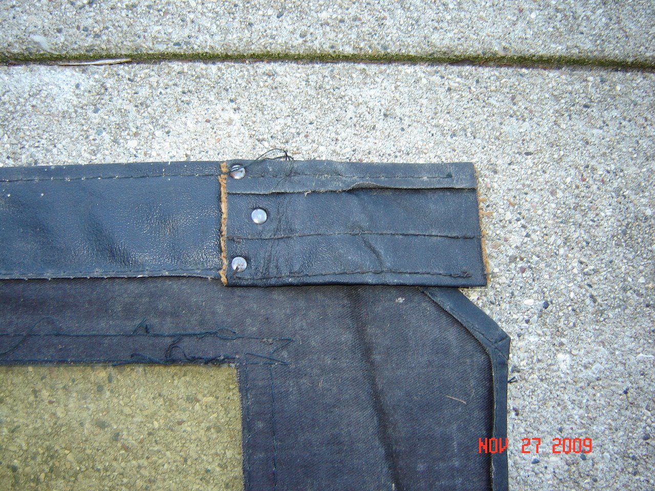

Here is another variation of the left side. The hand hole is located further ahead. Maybe it is easier to get an arm out to make arm signals for turning???? Or, if you are crank starting, maybe it is easier to reach in to adjust the spark and gas levers????

Post by namdc3 » Tue Apr 30, 2019 12:08 am
Great photos! It seems odd that there's no common sense eyelet at the upper rear corner of the left side front panel, as that would be sandwiched between the top bow and the upper front corner of the left side rear panel. It seems like the bow would have a double-height male fastener there to accept both layers, but it appears the front panel doesn't have an eyelet.
Posts: 2549
Last Name: Strange
Location: Hillsboro, MO
Re: 1925 Roadster Curtains
Post by CudaMan » Tue Apr 30, 2019 9:18 am
Wow, great pictures! I also note that there seems to be no fastener down at the lower rear corner, seems like it would flap in the breeze and be somewhat drafty. :)

I agree, and the other thing I'm not understanding is the top of the door arrangement. It appears that the fastener half-way up the door is the only thing that holds the rear of the door curtain up, so the top rear corner of the door would fold down. It also seems like the end (rear) of that upper strip would have an eyelet to hold it up similar to my comments on the left-hand side curtain. I'm sure there's just something I'm not fully seeing/understanding about how the door curtain works.

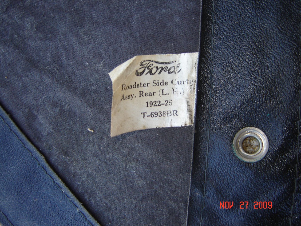

Here is something you must be aware of. Many of the roadster side curtains are labeled 1925 roadster. They are not. They are for a 1926. The ones you must get are the ones that say 22-25 on the tags like Jim posted.
Ford must have had a fixture for aligning the bows before everything was assembled. How else could you assume that every side curtain you bought would fit every car that was made? Today, we don't have the luxury. Another item. Those side curtains like Jim posted have all shrunk slightly, so you can't be absolutely positive they will be 100% correct. I used original curtains to make mine, plus I had the Ford drawings too, so I was able to copy the stitching details to get an identical curtain. I also made paper patterns of every part, and fitted them to the car BEFORE I started punching holes. When a fastener hole was off a bit I put masking tape over the hole and re-punched it until I got it right.

The photos of the side curtains that I posted were never "fitted" to a car. I think that when curtains were made for dealer stock that some of the fasteners were omitted and that would allow the dealer or owner to place the final fasteners where they would make the curtains fit well. Where you see fasteners missing on the curtains, those would be added in the "fitting" process.

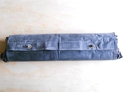

Since we're on the subject, here are some photos of two different side curtain rolls I have. The overall size is 19X25, with a 2 1/2 hem on the top and bottom, and a 3/4" hem on the sides. These are two different rolls, both the same size.
Side Curtain Roll.JPG (25.82 KiB) Viewed 10345 times
Insdside Curtain Roll.JPG (24.96 KiB) Viewed 10345 times
Curtain Roll Outside.JPG (28.58 KiB) Viewed 10345 times

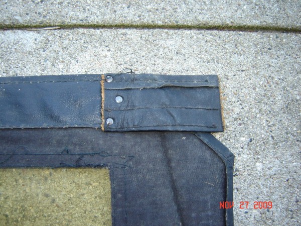

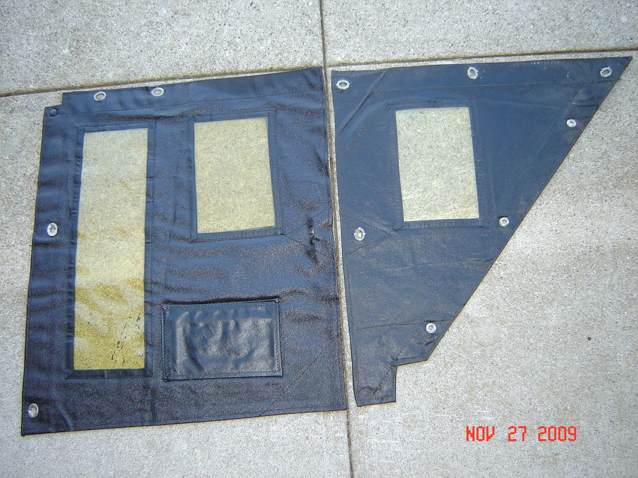

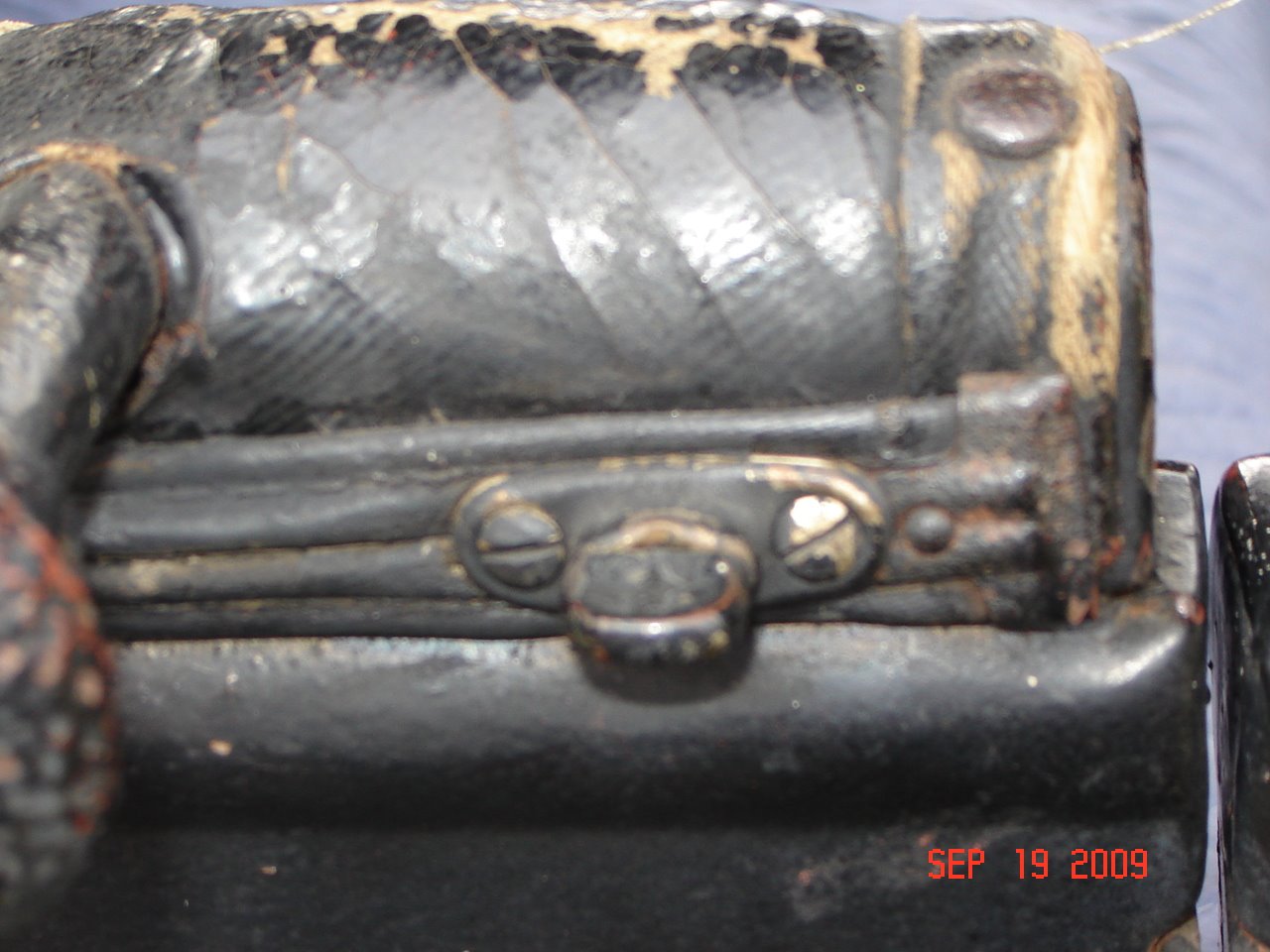

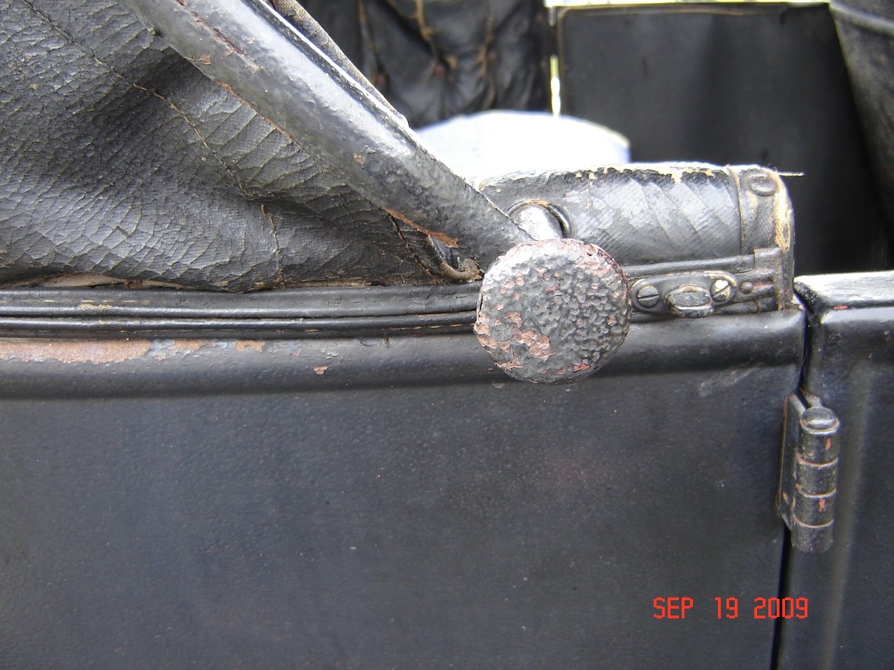

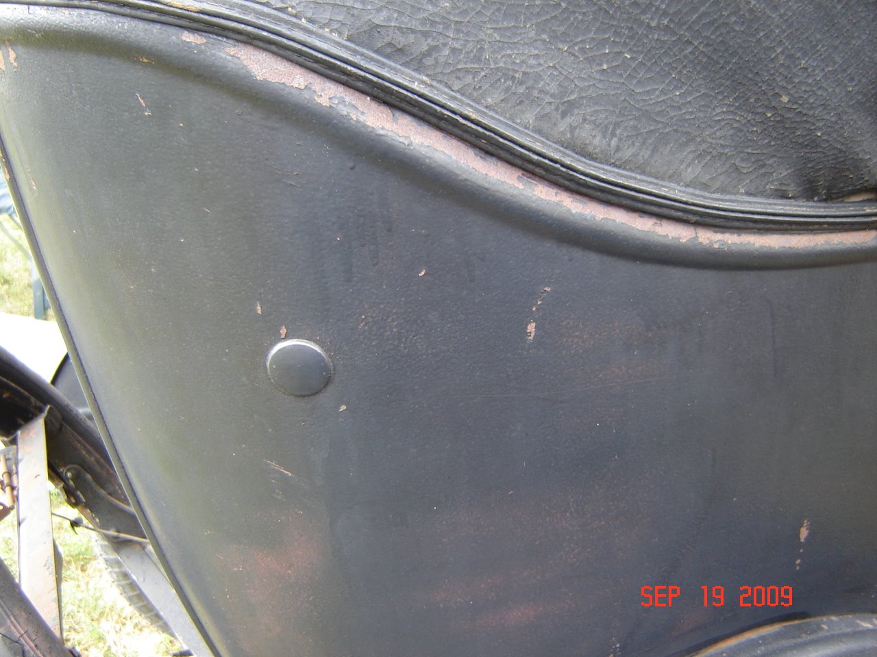

About ten years ago I took many photos of an original 1924 Touring that was at a local tractor and engine show. It still had its original top and interior, so it was nice to capture some details of the special caps on the ends of the hidem welts, fasteners, and stitching, etc. Many of those details apply to the Roadster as well.
1922 Coupe , 1926 Touring

Post by Original Smith » Sat May 04, 2019 10:16 am

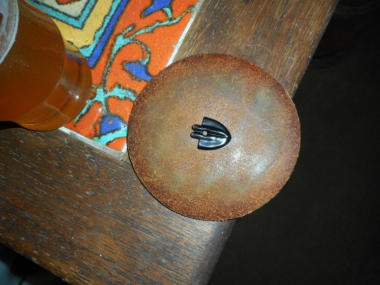

More great photos Jim! The hidem welt tips are very hard to find. I suppose the upholstery shops just threw them away when redoing tops, and replaced them with generic ones. I looked for years to find some, and one day at Hershey, a guy had a bunch of them in a jar. That made the trip to Hershey that year worth while.
