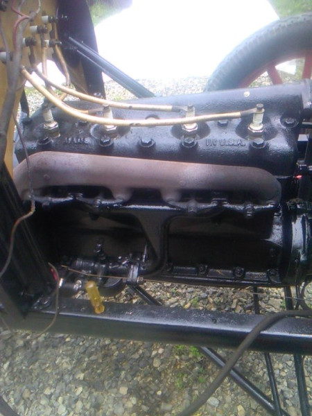

I painted the engine & exhaust with Rustoleum 500 degree engine paint waited about a week and started the 1916 T and it burnt the paint off the manifold exhaust and tail pipe. Is that normal or do I have a problem?

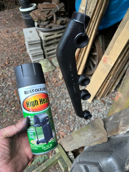

KBurket
- Posts: 178
- First Name: K
- Last Name: Burket
- Location: Seattle, WA
Re: engine paint
I’ve used Rustoleum High Heat after cleaning the rust off with my wire wheel. It’s held up well.
