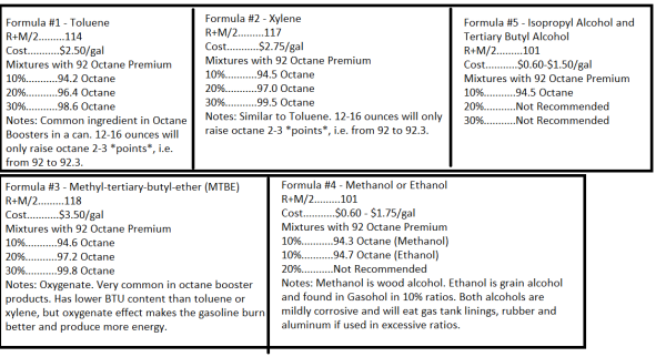

The Question: Does anyone know the octane rating of lacquer thinner?
Oh you talking about Banana Oil? Isoamyl acetate
https://www.aftonchemical.com/SBU/Fuels/OctaneAdditives
https://sds.interlinksupply.com/44988_MSDS.pdf

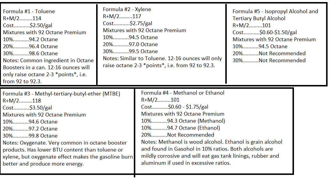

Posts: 6581
Re: Did Ford design the 1908 Model T with two fuel tanks?
Post by TRDxB2 » Thu May 26, 2022 3:20 pm
Been Here Before wrote:
Tue May 24, 2022 5:22 pm
https://patents.google.com/patent/CN106566583A/en
Based on the possible combination of ingredients finding a specific answer may not be recorded.
Lacquer thinner may include a combination of the following solvents: toluene, xylene, methyl ethyl ketone, acetone & butyl acetate
BUT Individually they can boost the Octane ratings (old prices being referenced)
