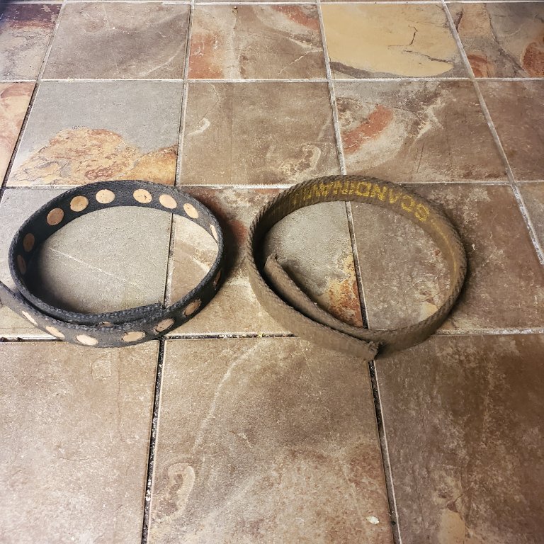

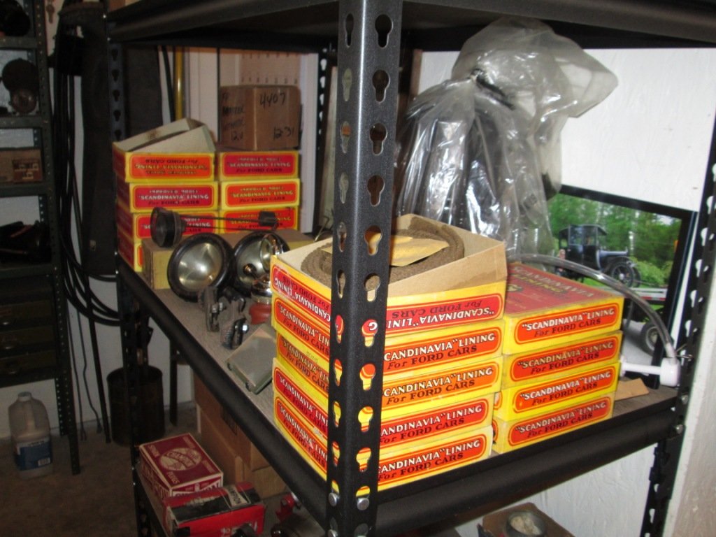

Relining bands on my 1910. Going thru my stuff I found some NOS Scandanavia, the light colored stenciled ones, and an NOS set of cork embedded cotton linings. None have shrunk with age and I'm wondering which I should use. It's no fun at 76 pulling the engine to change bands so I don't fancy doing this again any time soon. I am intrigued by the cork ones but have no experience with them. I would assume the cork is unforgiving of any drum imperfections but I'm only speculating. I am not a fan of Kevlar linings so that is not a consideration. Which would you use?

I would use the Scandanavia and leave the cork on the shelf as a display item. Who knows how long the glue holding the cork in will last and when if the cork inserts do come loose, what a mess all that cork would make along with any loose ends around those now empty holes.

FWIW, the cork inserts were not glued in, they were tapered so the woven liner held them in place against the steel band. "In the day" they were in common use, and marketed by several manufacturers. Trade journals in the era gave them positive reviews for smoothness of performance and longevity.Mark Gregush wrote: ↑Sat Jun 04, 2022 2:14 pm. . . Who knows how long the glue holding the cork in will last . . .
That said, regarding them and the NOS Scandinavia linings, one must be sure that the materials have not suffered mildew, damp rot, dry rot or other attrition during long storage. Beware of a musty odor, and examine the materials carefully to determine if they are sound.
Given that regular use of cork insert liners is long out of the living experience of today's T drivers, I'd consider using them as experimental, and though I would love to try a set myself, I'd only do it considering that I might have to fall back to a conventional lining sooner than later if something went afoul.
As far as the condition of transmission drums goes, scores, grooves or (horrors !) cracks spell trouble for any lining materials, and need to be corrected to avoid problems.
Good luck, if you opt for the cork liners, I hope you'll share your experience with them !

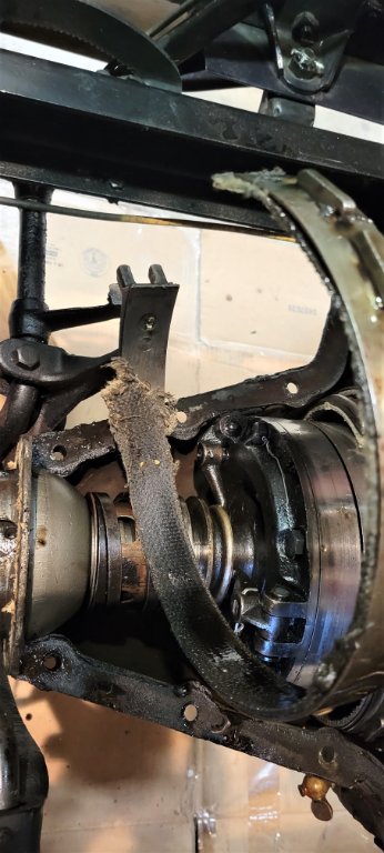

Keith, your bad lining torn or worn off at the top is exactly what my brake band looks like. I wore it out on a hilly tour last year after I was falsely reassured it was flat land. I found most of those on the tour were set up for the challenging terrain in that they had auxiliary underdrives and outside brakes.
Although I had a Ruckstell and used both reverse and slow speeds bands to slow the car, the terrain proved too much for the Scandanavia lining on the brake band.

There appears to be remnants of a gasket between your 4th main & drive shaft flange. There should be no gasket here. This is a ball joint & an unneeded gasket adds extra looseness. In fact, most are a bit too sloppy from decades of wear & can use a ball shim.KWTownsend wrote: ↑Sun Jun 05, 2022 11:01 amRichard-

I had probably had only a couple of thousand miles on those bands. I've had it on the road since the 2013 Kanab Tour and have been on a couple of Annual tours, but of course sometimes drive different cars for different occasions. I could tell the brake was getting bad pre-covid, so lined a set of bands with Kevlar in anticipation. However, last year on the tour in Spokane, is when I really noticed the fading.
John-
Your observation is very astute. I also noticed it when I was taking the hogs head off.
