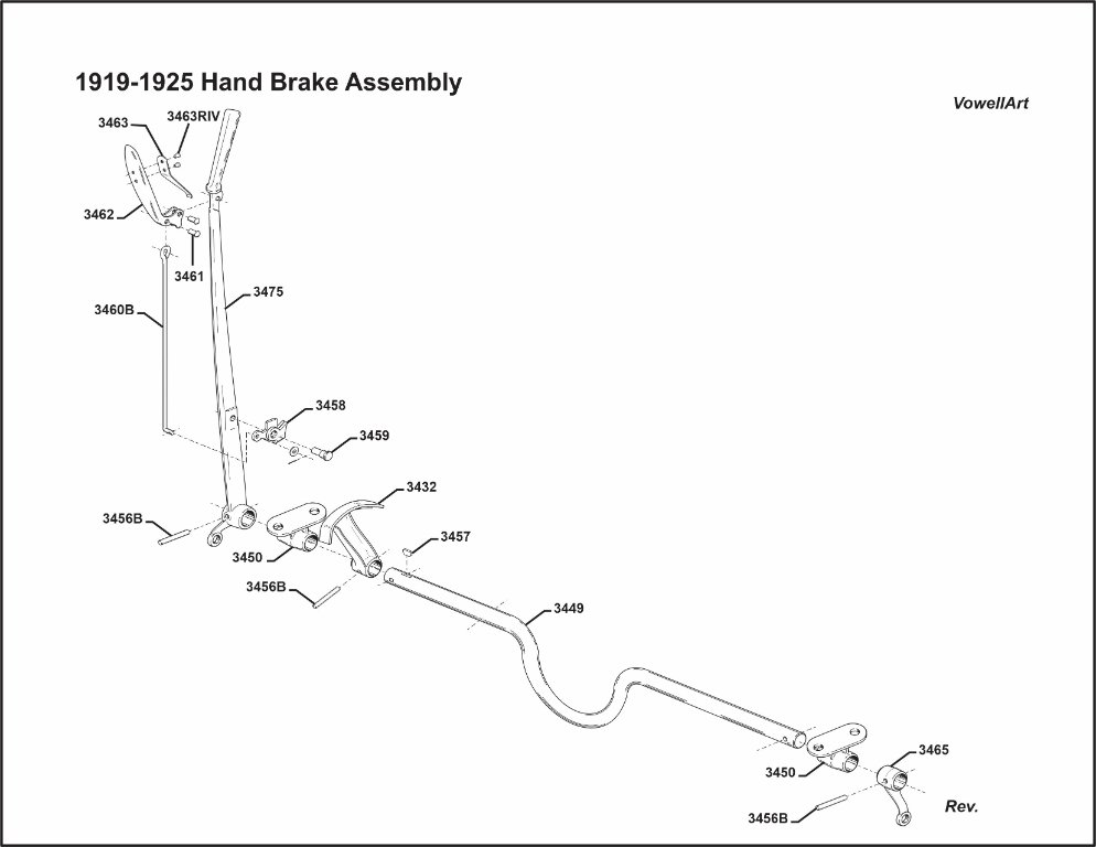

Post by VowellArt » Fri Jun 10, 2022 5:54 pm

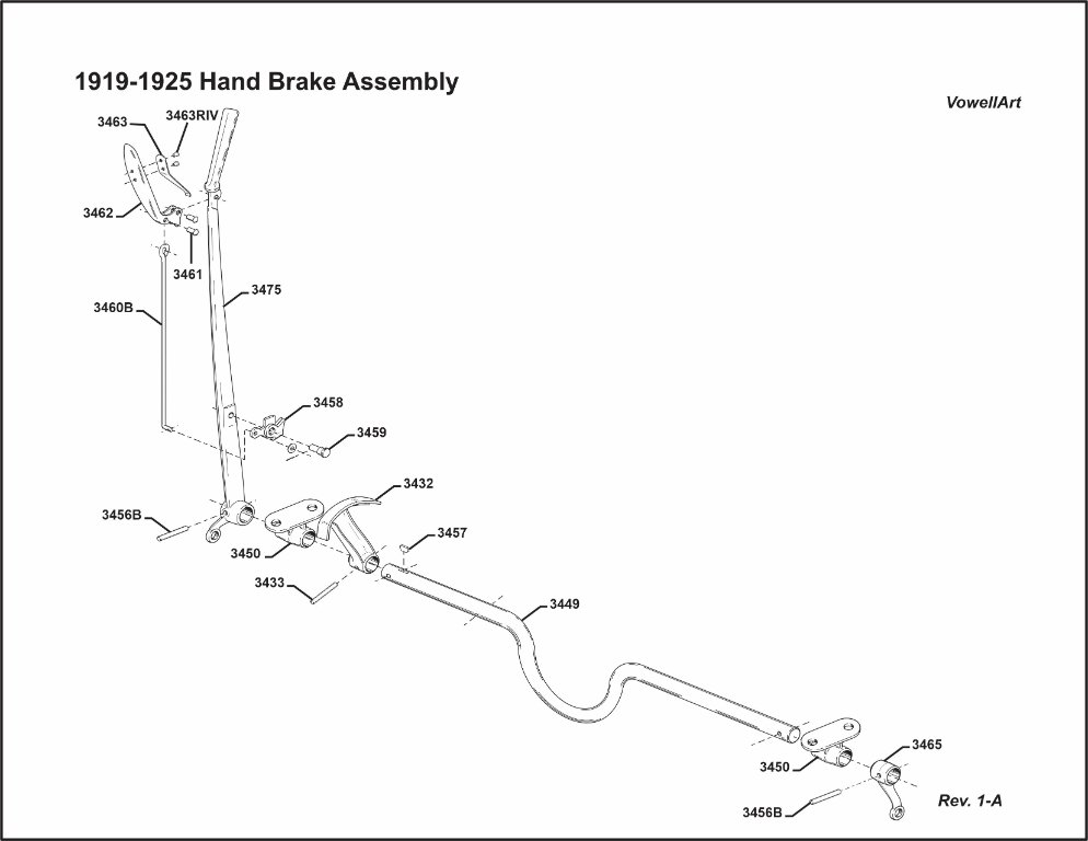

Got a question, it is obvious why you'd need a key on the Hand Brake Lever side, but shouldn't there also be a key on the other side too, it also pulls a brake rod. But I can find no pictures, notations or even a reference to such a key on that side. I also couldn't find a different number/size for the pin that holds the right side rod pull nor the pin that holds the neutral cam either. If anyone of you knows if these pins are different sizes and therefore have different part numbers, please let me know....also let me know if there is indeed a key on the right side rod pull arm too, thanks. ;)

Martynn, the key is responsible for transferring the torque applied by the handle to the other side of the shaft. The load on the short end is not something the pin cannot handle. So, I believe there is no key on the short arm end. I have never seen one there.
Posts: 4100
Re: ***1919-1925 Hand Brake Assembly***
Post by DanTreace » Fri Jun 10, 2022 8:56 pm
Haven't taken a speed lever off the shaft but don't think a key is used with the speed lever 3432? Can't find a Ford part number for it. That speed lever is pinned to the cross shaft, and believe it was a brazed joint at the factory to provide the needed strength to prevent rotation.
CORRECTION. Found that part # 3457 in a 1924 Parts Book, it notes the use of the key as 1909-1917. So the early assembly used a key. The later are brazed.
And your very nice sketch should show the hole in the cross shaft to pin the speed lever farther down the shaft, as Allan noted, no key there, I have taken that end apart. The end of the cross shaft goes into the Hand Brake Lever hole, with the gap between to slip in the 3450 bracket.
The hand brake lever 3465 is pinned to the shaft with the same rivet used for the u-joint. The Parts Book notes to order 2574 u-joint pin for the 3456B hand brake lever pin. The u-joint pin is .275" x 1.5"
Post by VowellArt » Sat Jun 11, 2022 7:11 am
Dan, that key is for the Lever not the cam...I just put it where it goes, not in the order in which it goes there. Also, you'll notice that the cam goes almost to the "U" bend, there is a center line for the pin further down where it goes....but if it is brazed, then did it not also get pinned as the set up for brazing? Something has to hold it in place whilst they brazed it, right?
Perhaps I should make the center lines bolder, they're very had to see in a 16 bit drawing. I usually draw in 32 and 64 bit, but the forum won't accept either of those two sizes of drawings. Face Book accepts 32 bit drawings, but not the 64's, those I'm reserving for a printed hard copy book and they've got Factory Numbers and Change Dates not Part Numbers, but maybe I should add the part number too, might make for a more complete parts reference.
Hmmm, gonna have to cogitate on that some.

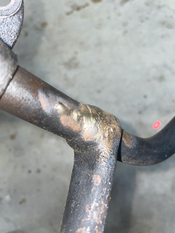

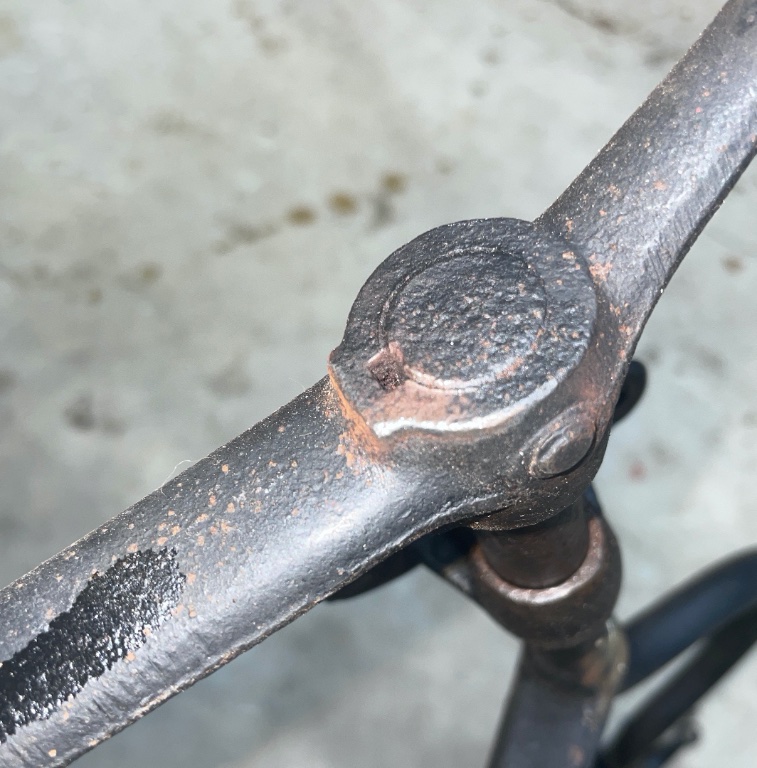

Martynn
Opps, thanks for that correction.

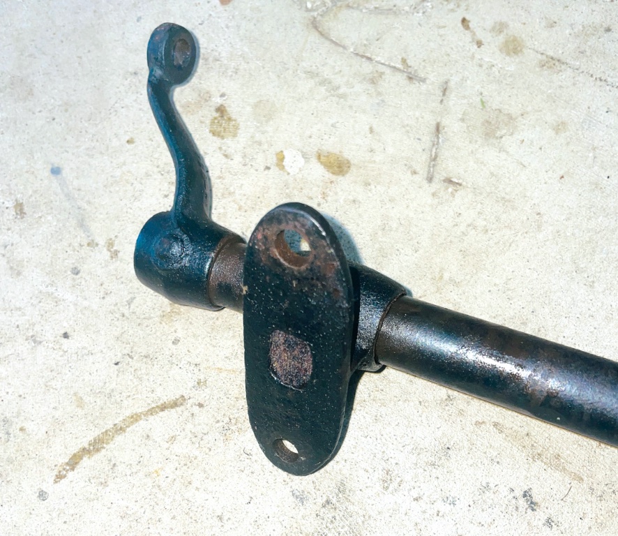

So had to go to the parts pile and inspect the construction of the control shaft 3449 that includes the 3432 speed lever and the hand brake lever.
That speed lever is brazed to the control shaft, so much so could not tell of there is a rivet pin there, don't think so as the Parts and Price list pic is without a tiny hole for one in this 3432 part. That brazing does the job.
As for the hand brake lever, did see that keyway for a key in the shaft, so that is correct.
And the hand brake lever is also pinned with a rivet 3456B that the Parts Book notes to order 2574, the U-joint pin. The 2574 is Factory #6, and the size is 9/32" x 1 1/2".
For for the 3465 hub brake lever, the rivet pin is 3466 and Parts book notes to order 3405. 3405 is the rivet pin for the clutch release fork 3406C. That 3405 pin is Factory # 1553 and the size is 1/4" x 1 3/16"

Post by Original Smith » Sat Jun 11, 2022 10:20 am
The one you have pictured was only used in 1921. Notice there are no oil holes for lubrication. He brought back the oil holes after a year + of this type.

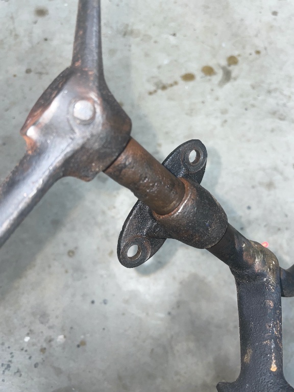

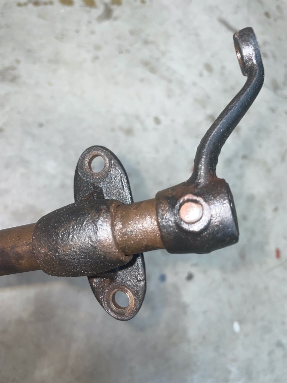

Post by DanTreace » Sat Jun 11, 2022 11:52 am
Larry
The 3450 bracket in the control shaft photographed above does have the oil felt recess.
That accommodates the felt pad 3005, Factory #314.
Is this the 'oil hole' ? Where else is an oil hole on the controller shaft? What makes this part only 1921?

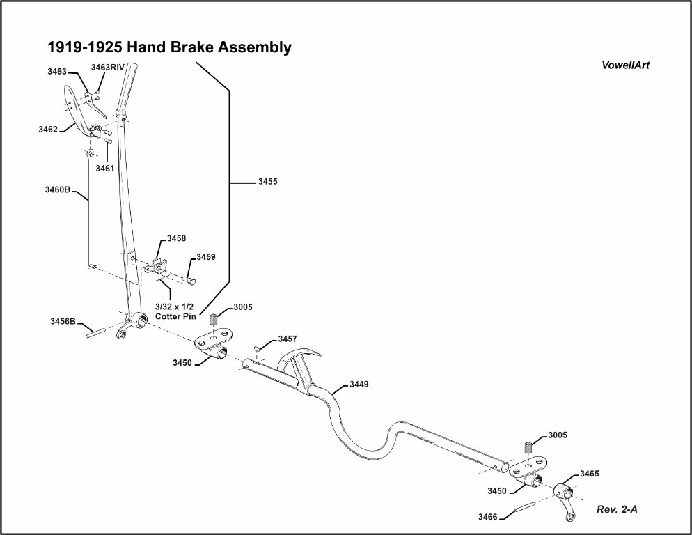

Post by VowellArt » Sat Jun 11, 2022 7:15 pm
Dan, woo, good stuff, didn't know about that oil felt, saw it listed in the alpha parts list of Bruce's, but couldn't find the bloody thing....now I know, only problem is I don't know what one looks like. It is obviously part of 3450, but if the factory parts list calls it out it must be shown not assembled into that bracket.
I made a mistake showing the cam 3432 pitched so far forward, in the neutral position of the Brake Lever 3475, it should be almost straight up, not canted forward where it would be if the lever was pulled all the way back. So I went back and re-adjusted the cam and whilst I was at it, thought since it was brazed at the factory and indeed many of the later parts book show as part of the cross shaft, I decided to just show it already affixed to that shaft as one assembly...the key is separate because it isn't added until you put the Brake Lever 3475 onto the end of the cross member shaft.
I will also make a note of the Factory Numbers, I'm pretty sure they'll come in handy at a later date.

Larry, you don't seem to understand why I post here....I'm a Technical Illustrator, I draw based upon whatever I can find on the internet, my own car and from my own paltry stores of documentation. I post here not expecting to be correct, but to be corrected, by you guys who are the experts in all the different years of this car. I try to get close as I can, then let you guys handle the corrections.

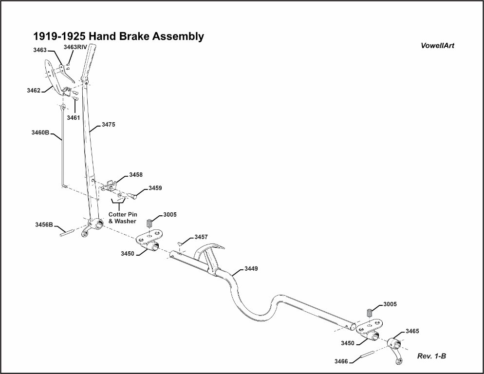

Post by VowellArt » Sat Jun 11, 2022 9:03 pm
Ok, one more change, Steve Jelf brought this to my attention and not finding anything else that disputed what he said, I've made this change. The Brake Lever 3475, doesn't seem to exist as the lever, but the Pawl Rod for the Torpedo runabout. This changed later to 3460 or 3460A (7/32 x 14 21/32 long) somewhere prior to 1919. In 1919 it changed again, the diameter was the same but the length changed (7/32 x 14 25/32) and is numbered as 3460B, but are under the Ford Factory Number of T-877, whereas the Torpedo runabout Pawl Pull Rod Factory Number was T-1593. The Brake Lever was sold from Ford as an assembly "with attachments" under the number 3455 from late 1909 through 1927. But all the other parts do have numbers too, so I guess those parts could be bought separately as well as the assembled Brake Lever.
Post by DanTreace » Sat Jun 11, 2022 9:10 pm
Allan wrote:
Sat Jun 11, 2022 8:22 pm
Apart from Larry's 3450 part without the oiler hole, the only other variation I know of is the earlier samples had a square hole cast into the body of the part, rather than a drilled one. They look bulkier between the mounting foot and the eye for the cross shaft.

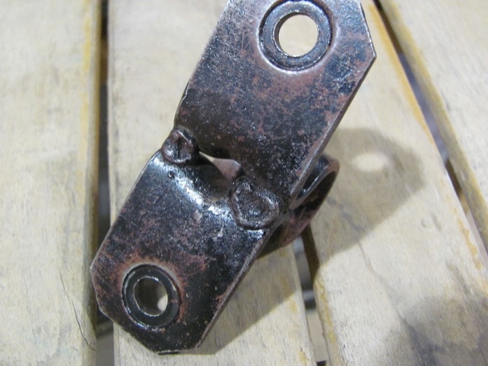

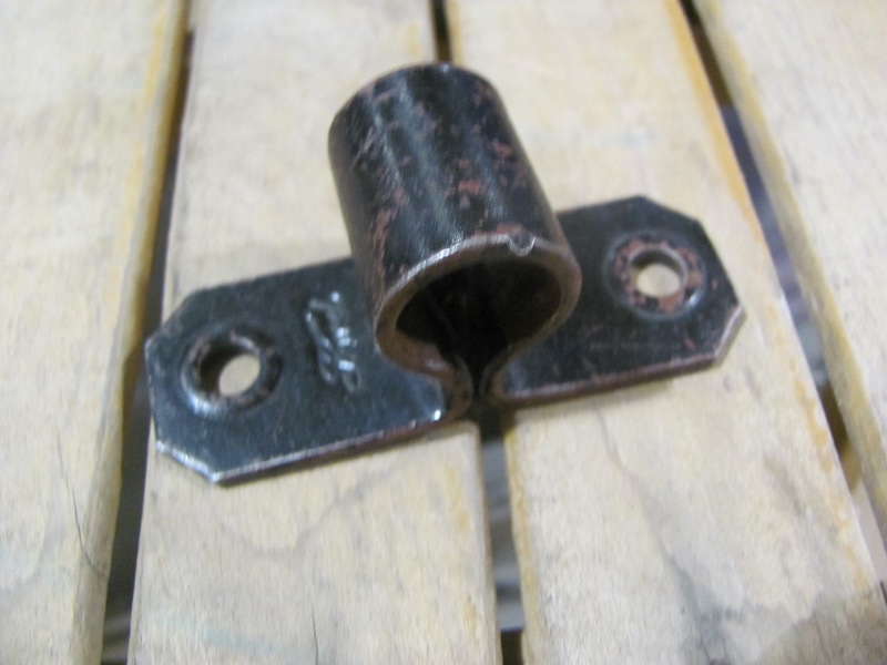

And this the another, with a round hole in the casting for the felt recess, and the felt used is a round pad!
Remains of felt, replace with new.jpg (84.89 KiB) Viewed 5691 times
For more fun, anyone seen this variety? Ford script, but made from steel stamping, not cast. Maybe a very late change for saving $$?
Post by VowellArt » Sat Jun 11, 2022 9:39 pm
Another change, cotter pin size and took out the washer.

Dan, the squared off hole in your second post is the earlier version. The later one shown with the felt and the round hole followed some time. The body of the square hole type is also squared off somewhat between the shaft hole and the mounting face, making it look bulkier.
Posts: 5601
Post by RajoRacer » Sat Jun 11, 2022 11:26 pm
I have one or two of the strap iron style Dan - I thought the same - late production cost cutting.

Post by Original Smith » Sun Jun 12, 2022 8:20 am
I posted a photo of the strap design a week ago. It is rusty, but still shows the Ford script.

Okay, the strap iron bracket, when do you guys think it was used. Since it has a Ford Logo on it isn't an aftermarket replacement, do you think then it might be from one of the early cars? Need to know, I'm moving that direction and want to put it in the proper timeline.

Post by speedytinc » Sun Jun 12, 2022 8:06 pm
I have never seen a cotter pined version. I have worked on 13-27 & bought many loose units, including TT to make into rux shifters.
At the least, your time range cant be right.
Post by speedytinc » Sun Jun 12, 2022 8:25 pm
You show a woodruff key to attach the cross shaft to the lever. This is an earlier version, I believe. I have seen it, maybe to 15?. Others would know better. The key is not in tune with your time line.
It gave me an itch in back of my neck, so I looked at my pile. None of the 10 or so I have are keyed. The lever is held on only by the pin.
Post by Pep C Strebeck » Sun Jun 12, 2022 8:38 pm
The cotter pin is for the pawl rod to the pawl itself, attaching parts 3460 and 3458.
sorry bout that. I should have blown it up.
Post by VowellArt » Mon Jun 13, 2022 5:42 am
John, my car is a 22 Touring and it has a key in the Cross Shaft for the Hand Brake Leverm George Clipner's 26 Touring also has the same set up. The Factory Number parts list also notes that it was used on 09-27, now whether this is a select few cars or ones made domestically or whatever, I don't know....all I know is that it is on mine and George's cars.
