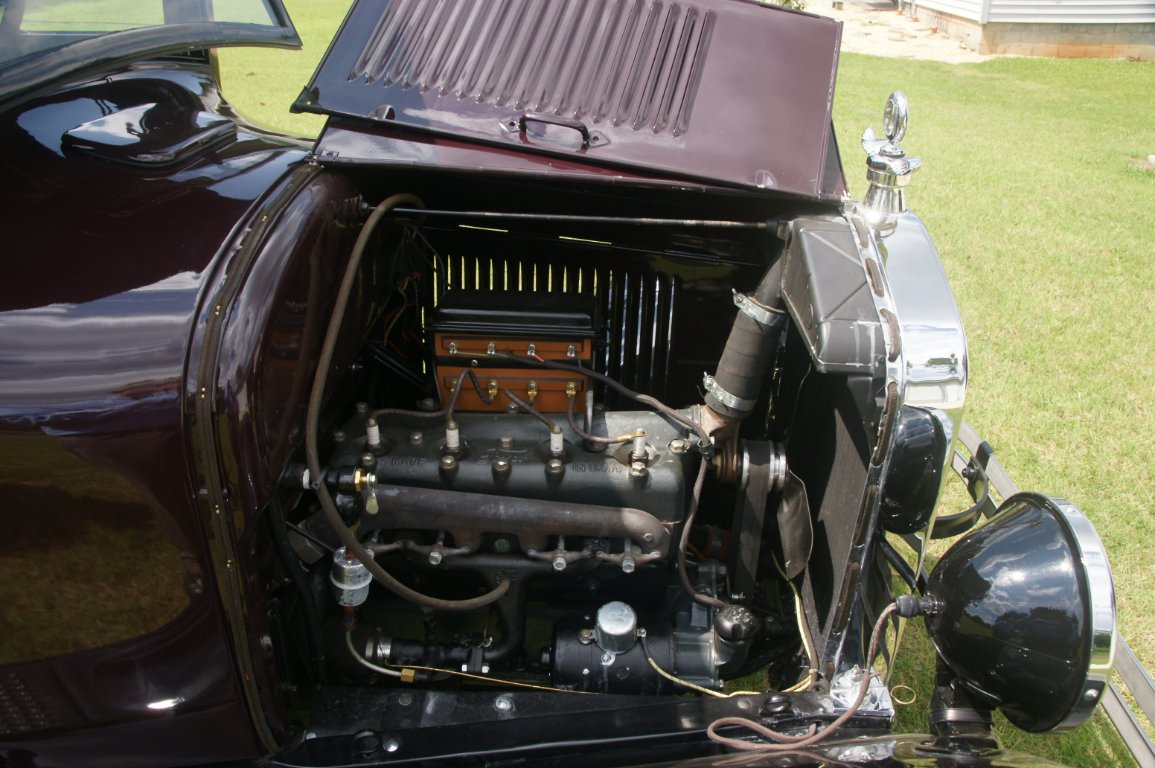

I can’t remember where the spark plug wire on 27 coil box go. I have the timer wires on the top and spark wires on the bottom row

Yes Sir. Sounds right to me. Bob
That is correct. Just make sure the firing order is correct at the timer. 1-2-4-3
