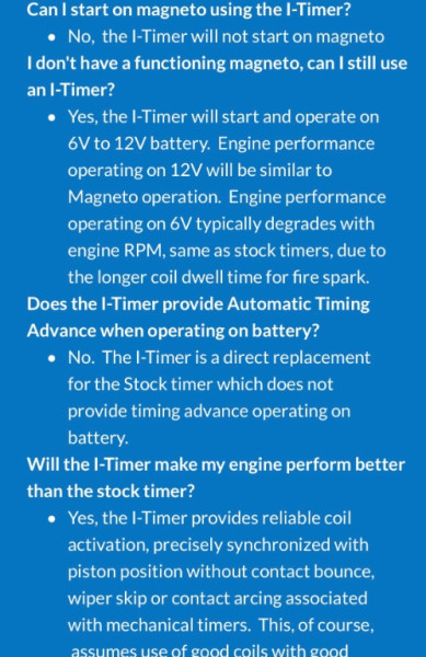

From Mike’s website
The I-Timer is 6-12v DC only.

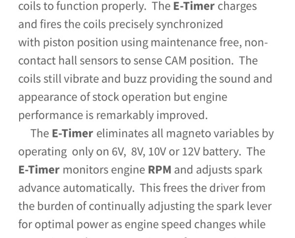

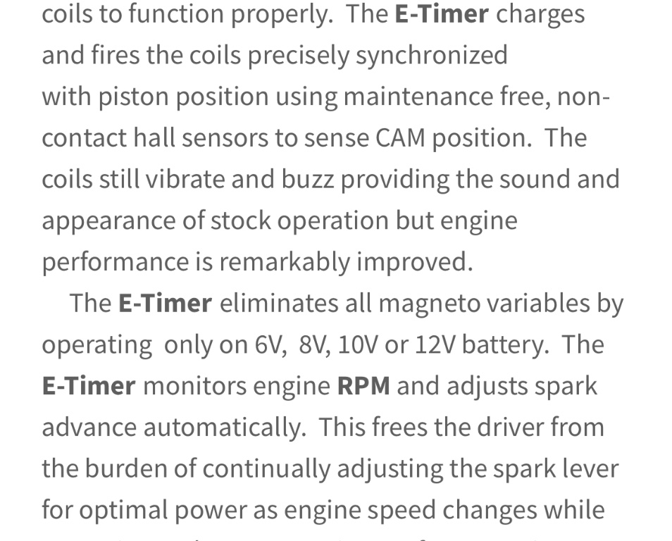

Then here are the voltage requirements for the E-Timer.

Sorry for the delayed reply, very busy lately. The E-Timer was designed to operate on 6V to 12VDC. It will accommodate battery charging to 14V maximum. Had an incident where an alternator VR went bad and the output voltage exceeded 15V that damaged the E-Timer.
The E-Timer operates very efficiently, a small 9V transistor radio battery powered it for almost an hour. It's difficult to say with certintity how long a particular battery will last without charging without additional information. A new 6V or 12V car battery will likely last a week of touring 3-4 hours a day (no head light usage) without recharging but I don't have solid data to back that up, perhaps someone else does. Certinally will last all day then can echarge over night to ease concerns.
