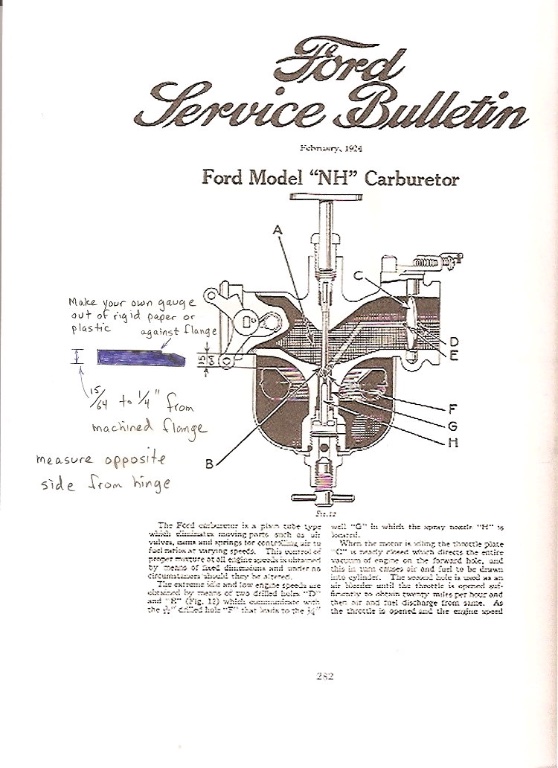

What is the float set at? Jim Patrick

Good question. I will check it and make sure it’s in spec. When I first put gas in the car, it poured out of the carb. A couple of taps with a hammer handle sorted that. I did get some dripping out of it later, but only a little. I took the carb off to see if there was crud in it that could be blocking things, but it was all clean and looked new.

I took the carb off and checked the float for leaks (none) and adjusted the float, which was app 1/8 inch low. I am going to throw the carb in the sonic cleaner with some hot soap and water in case there is some crud in the high speed passage. Everything else looks good. I am going to put new gaskets on the carb when it comes out. I also found there were two gaskets between the carb and manifold. Not sure if that was an issue, but a new one can’t hurt.
