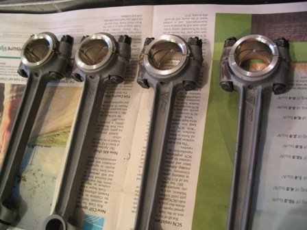

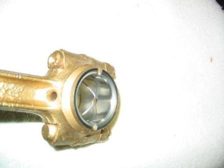

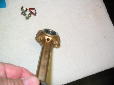

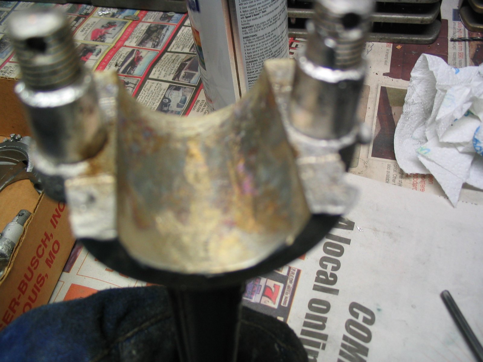

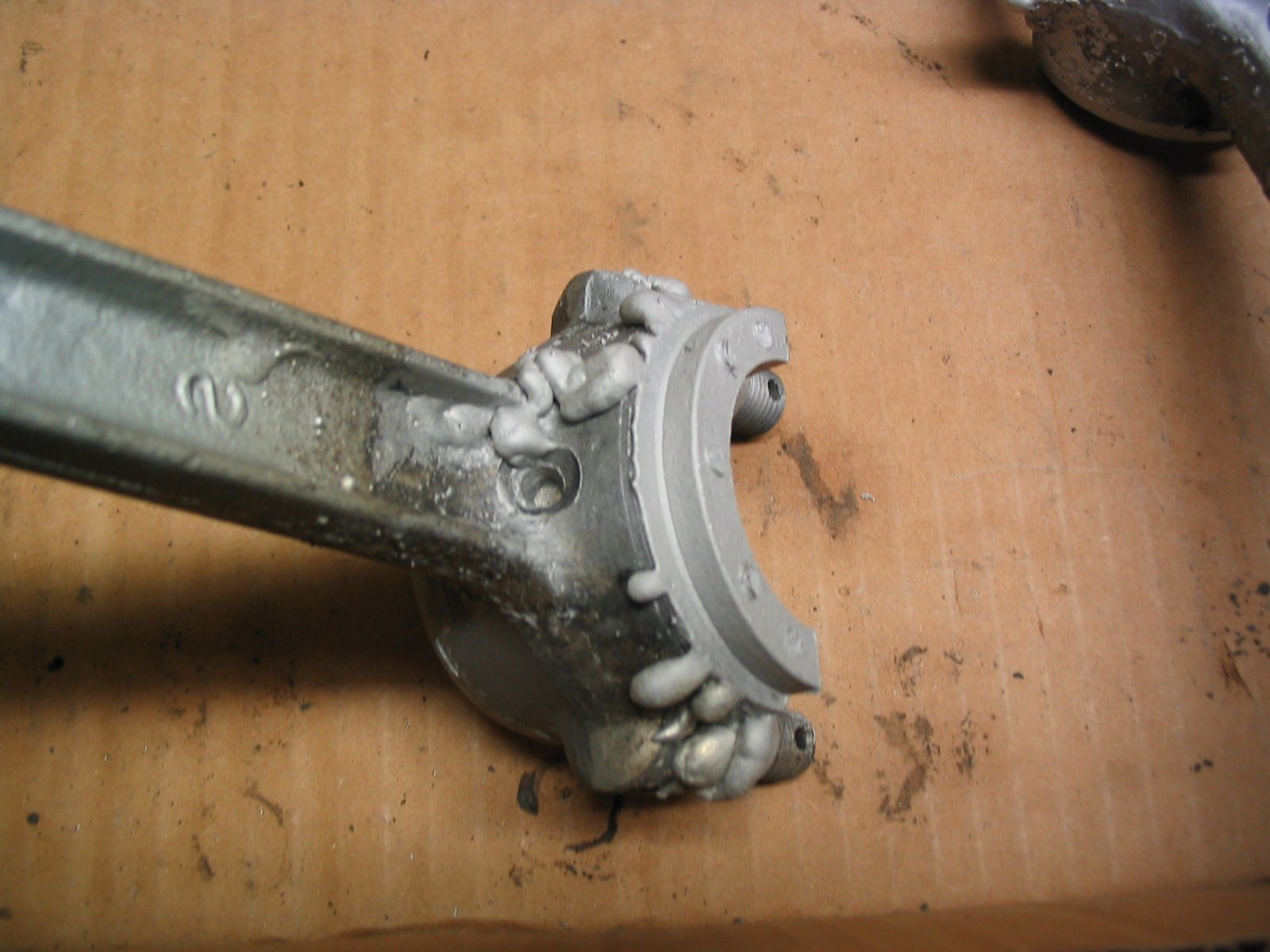

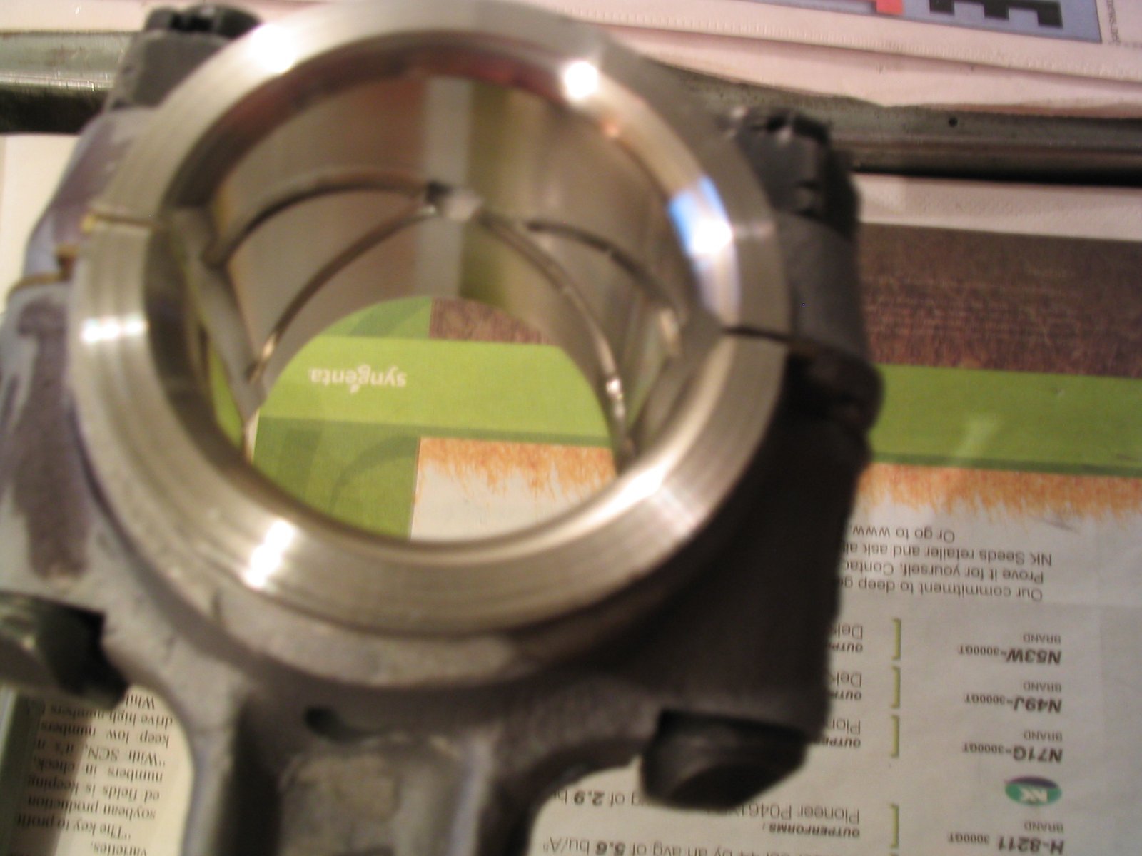

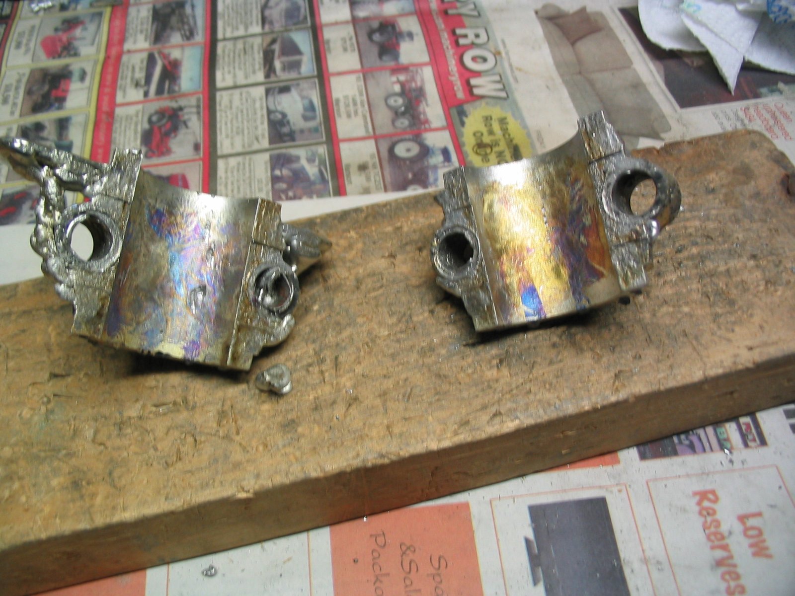

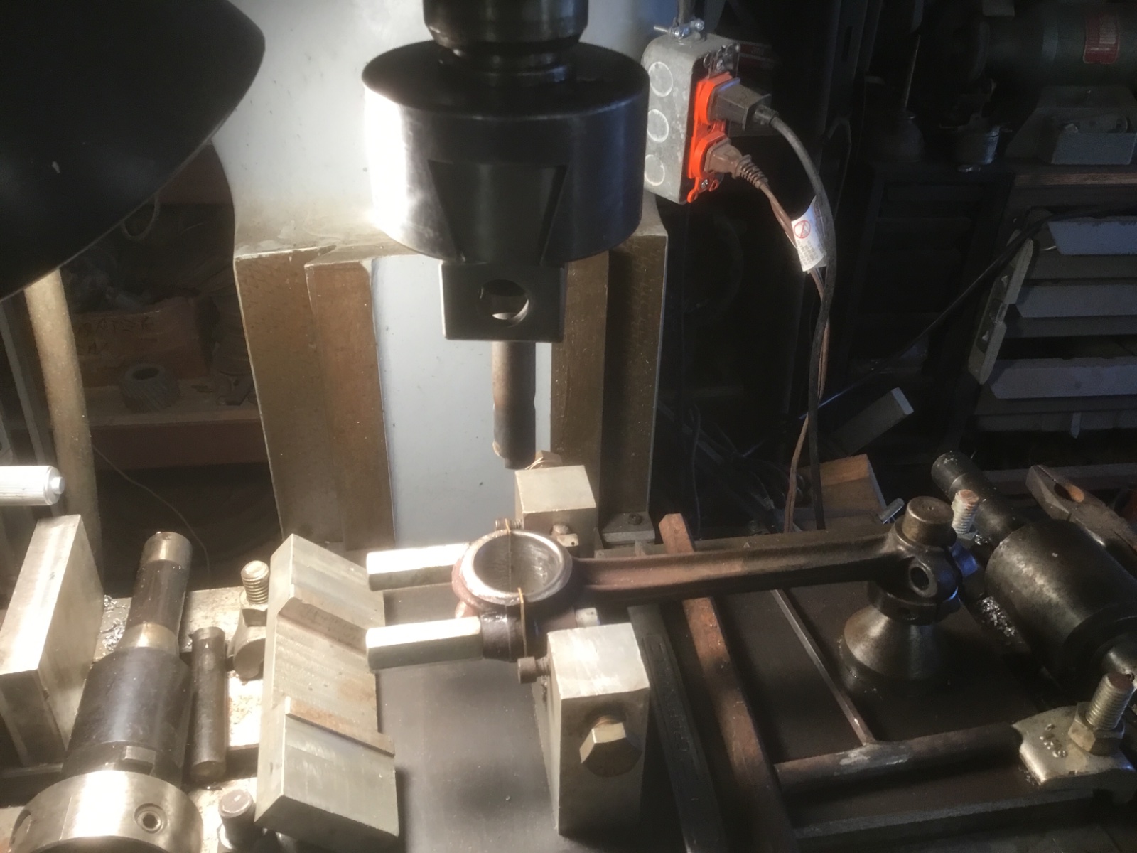

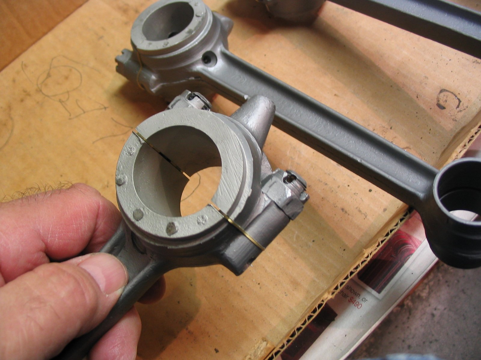

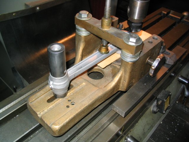

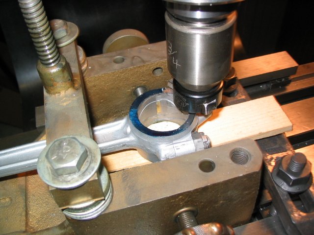

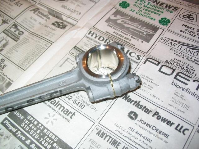

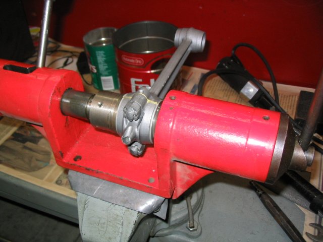

We never bore out any Model T caps because they have been filed. I built a Jig that takes T, A, and B caps, and also the rod, and machines the part lines on both. They fit together, perfectly. Also, they are machined flat to the bolt hole, both directions. If that isn't done, the Rod, and Cap will not slide together, with out binding, so you would have to beat the cap on, and beat the cap off.
The best way to pick for same weight, is to weigh each rod, before the babbitt is melted out, afterward, is tough.

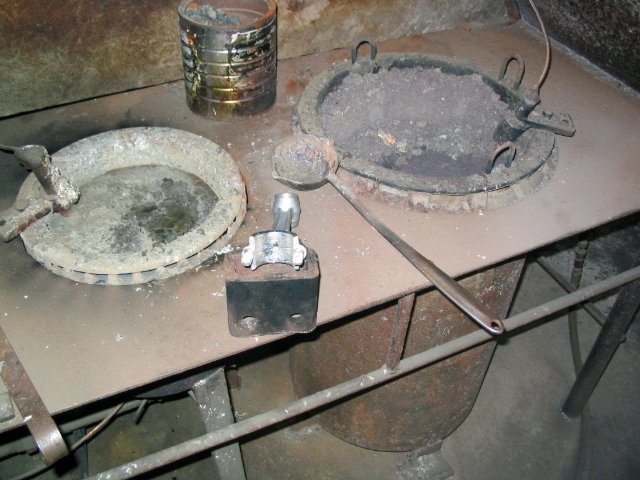

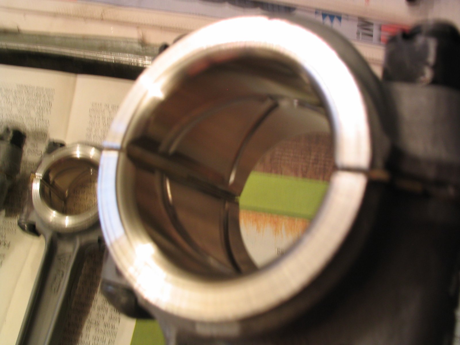

With the spun poured Rod, we machined the Model T rods on the out side, thrust area, on each side, at 30 degrees. also bored the hole, in one shot. We made our own shims, as they have to encircle the bolt hole.
If we jig pour T Rods, we cut the thrust sides flat. The centers are still bored the same size. I will see if I can find some pictures.

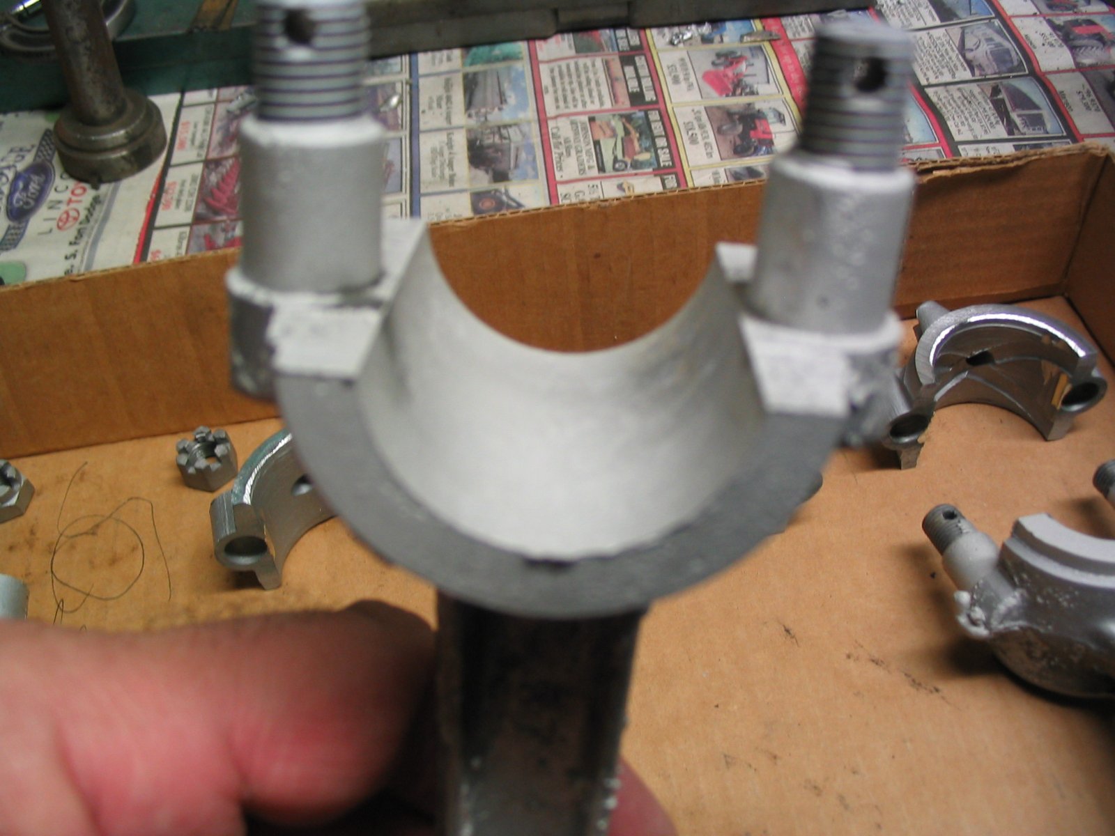

We always use shims in the rod to set the cap out to where it belongs. The spun poured rods, took two solid shims of .032 first, and then one piece of .032 laminate, 16 pieces, of .002. we have never built any bearing with .003 thousandths thickness.
We never cut a rod or cap that wasn't in the same position as the Ford factory. The practice of boring metal out of the cap, to make more room for babbitt, because of the cap being filed, is, very, very pour practice, and then use Chevy rod bolts, be cause the originals, are to long now, is also shabby.
To find out any given rod, of how many shims, are needed, the cap is slid on the original bolts, and the nut is screwed on the bolts, and the cotter pin holes are aligned, and the hole in the bolt, should align with the bottom of the slot in the nut, then you will know how many shims are needed in the rod.
By boring out the cap, you weaken the trust of the rod cap, and also are making a smaller, thinner thrust on the Cap, from moving the cap forward.
T, and A Rods.
Herm.
Jig Poured Model T Rods, Jan, 2012 012.jpg (25 KiB) Viewed 6896 times
Jig Poured Model T Rods, Jan, 2012 010.jpg (26.21 KiB) Viewed 6896 times
Jig Poured Model T Rods, Jan, 2012 002.jpg (33.92 KiB) Viewed 6896 times

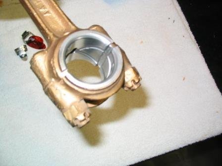

More pictures.

Pictures.
Giles 338.jpg (31.54 KiB) Viewed 6888 times

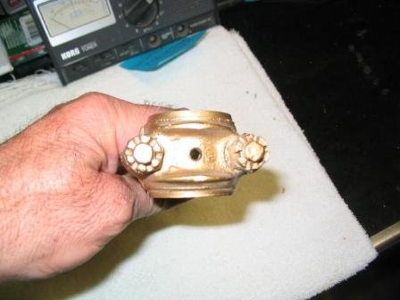

pictures
Model T Spun Poured Rod 012.jpg (21.79 KiB) Viewed 6879 times
Model T Spun Poured Rod 017.jpg (16.67 KiB) Viewed 6879 times
Model T Spun Poured Rod 010.jpg (13.52 KiB) Viewed 6879 times
Model T Spun Poured Rod 007.jpg (20.37 KiB) Viewed 6879 times

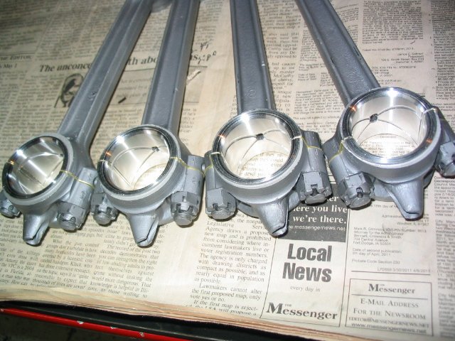

Beacon Banjo FF-Professional, Rebuilt 060.jpg (39.35 KiB) Viewed 6822 times
Beacon Banjo FF-Professional, Rebuilt 049.jpg (28.14 KiB) Viewed 6822 times
Beacon Banjo FF-Professional, Rebuilt 036.jpg (31.73 KiB) Viewed 6822 times

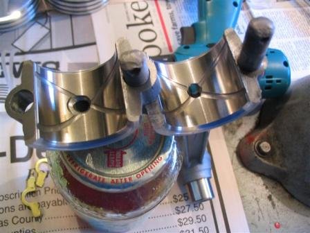

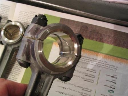

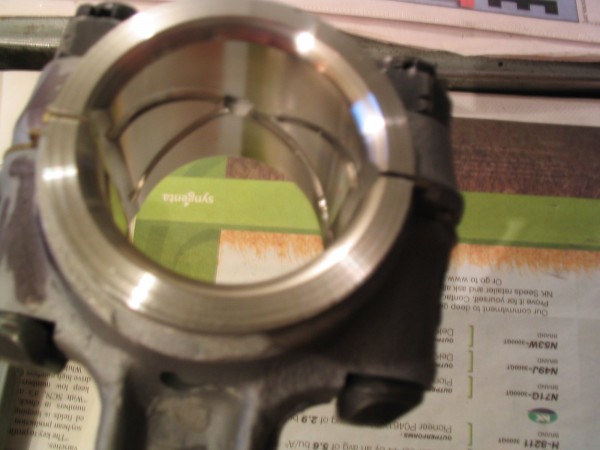

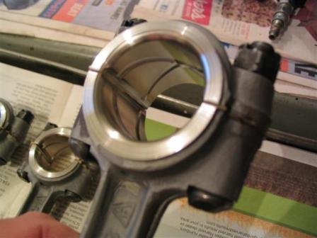

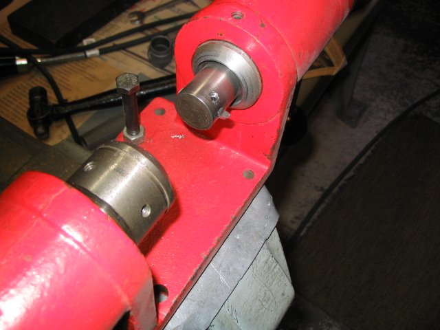

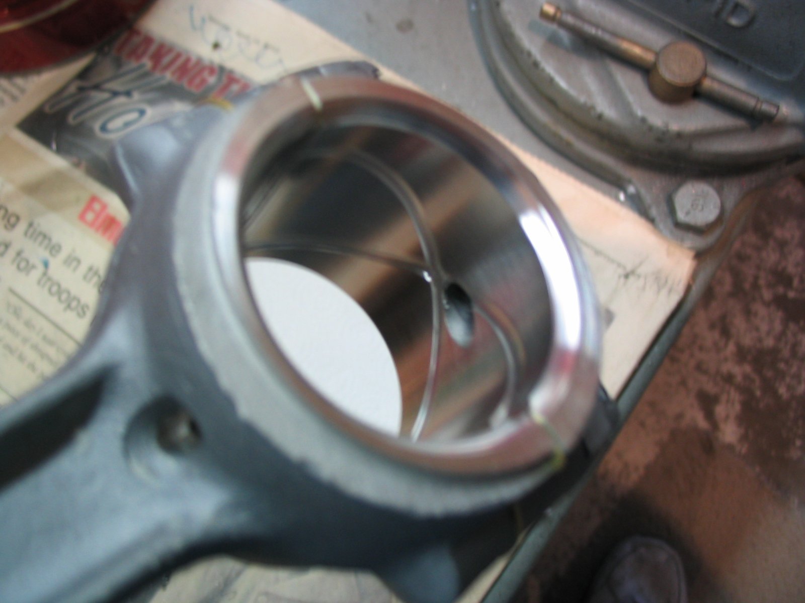

Hey Herm: Those X-Grooves look pretty clean. Are they done on a Waterbury or similar machine or do you use another of your home-spun jigs?
Sean Butler
Huntington Beach, CA
Kohnke Rebabbitting
Posts: 144
Joined: Sat Jan 26, 2019 3:12 pm
First Name: Herman
Last Name: Kohnke
* REQUIRED* Type and Year of Model Ts owned: 1914 Roadster, 1922 Coupe
Location: Clare, Iowa
Re: Sizing rods before babbitt
Post by Kohnke Rebabbitting » Wed Apr 17, 2019 1:00 am
Sean Butler wrote:
Tue Apr 16, 2019 7:49 pm

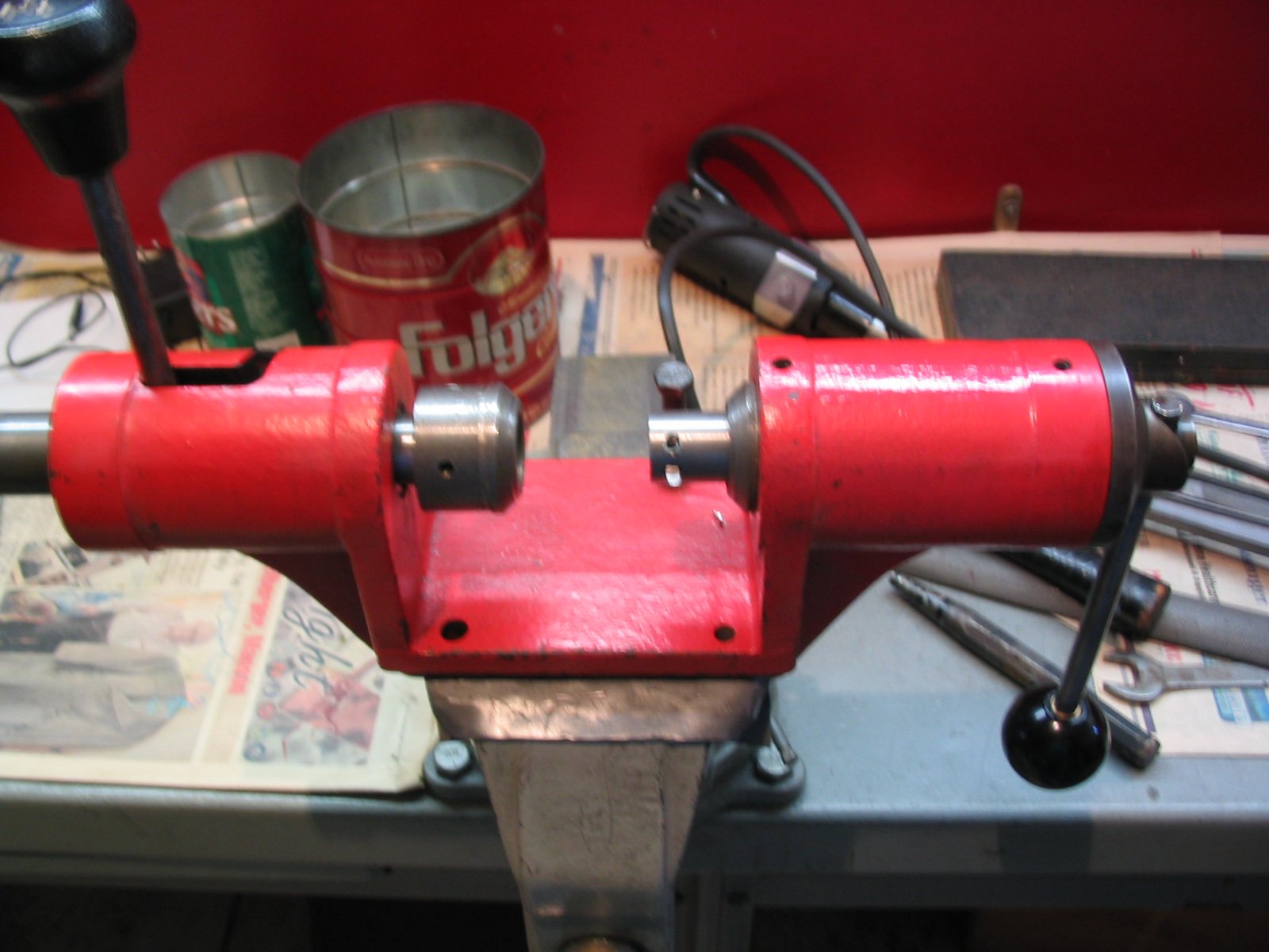

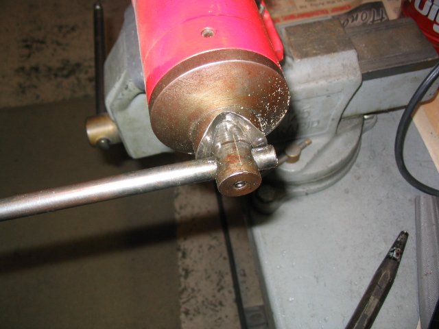

They were put in with one of 3 Storm Vulcan bearing groovers .
Herm.
