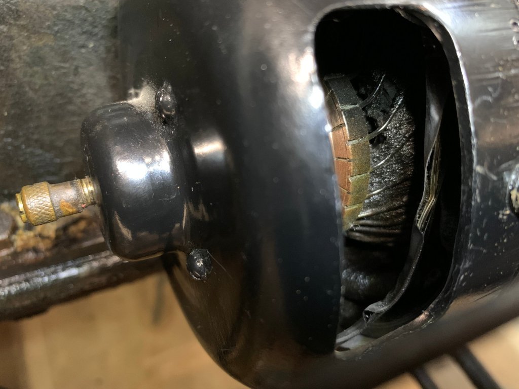

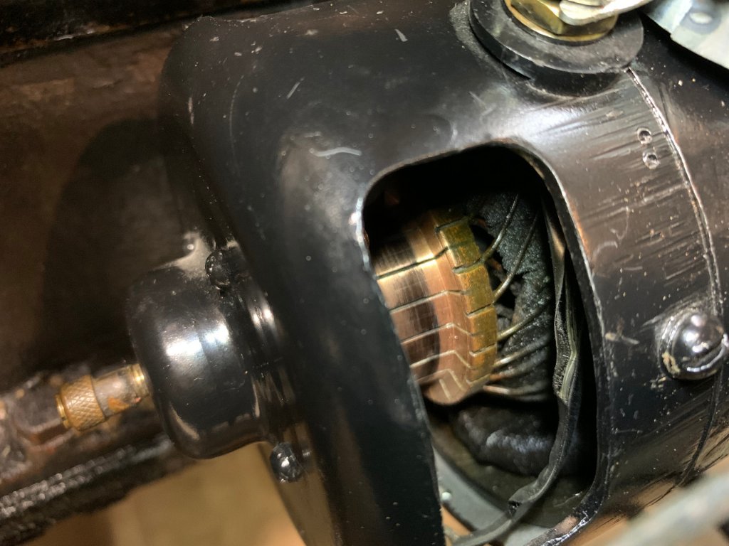

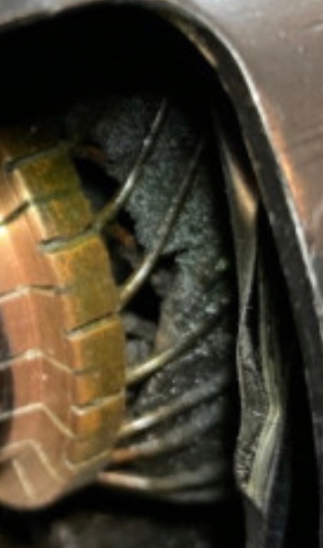

Does this generator look right? Should the 'black stuff' be crumbling off? Would that cause it not to charge? What should it look like?
Posts: 8642
Re: Does This Look Right?
Post by TXGOAT2 » Mon Jul 18, 2022 3:26 pm
The commutator looks OK, but I don't see much solder where the windings connect to it. The black, crumbley stuff on the armature is probably burned insulation. Exactly why it does not charge is not evident by looking at it. It may have been damaged by being run with no load connected to it.

This is a rebuilt unit. Is it normal for it to look this way? It worked for about 30 seconds and then quit.

Take it back to the re builder. A reputable guy will stand by his work or be able to tell how you burned it up.
Selling rebuilt generators is risky business. Its a constant worry unless a new cutout goes with it.
What you have doesnt look like a full rebuild from the limited view.

It appears that the armature is toast. Did you have the cutout connected? You have something cross wired I think but you’ll need another generator judging from the solder, that bad boy got HOT QUICK!

Could I have done that much damage in just a few minutes of running the car? I never saw or smelled smoke.

If you had a bad cutout/open circuit & ran @ moderate to hi speed, yes, a few minutes would be enough, but I would expect to see a bunch of slung solder.

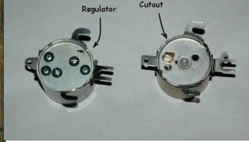

I was trying to verify if you have a VR or just a cut-out. Since you purchased the car from someone, they may have said it was a VR but it may not be.
The simplest way to verify what it truly is to view the underside. The 2 screw positions and the triangular hole are what the Fun Projects VR has. There are variety of cutout undersides in fact the Fun Projects cutout had just 1 screw next to the 2 pop rivets and the triangle slot was closed. A photo of it would help verify it.

Also there were Fun Project VRs for 6, 8 and 12 volt systems so he could have a wrong one.
By John F. Regan on Friday, April 15, 2011 - 04:14 pm:
All of our voltage regulators are easily discernible as to 6,8, or 12V as follows:
On the underside of the base the 8V units are stamped with a letter "A" while 12V units are stamped with a letter "B". No stamp at all and it is then a 6V unit. Positive ground Voltage Regulators have a steel washer in place of one of the center insulating washers. As pointed out - a rivet in one of the center locations designates that it is a cutout. Hope this helps.

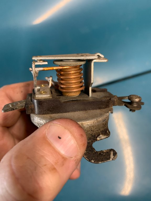

This is what I had. In answer to your previous question.

This is one of those really cheap "CUTOUTS" that are known to fail & kill a generator.

Your saying the is what you "had" - that's a solenoid cutout. Need to know what you "have" now. The cutout your holding may or may not have been an issue at some point. But if you replaced it and are having the same issues then it wasn't the cause

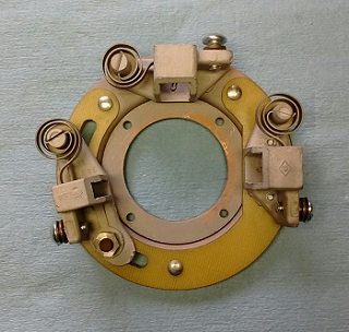

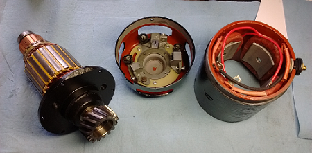

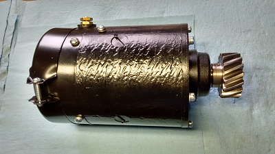

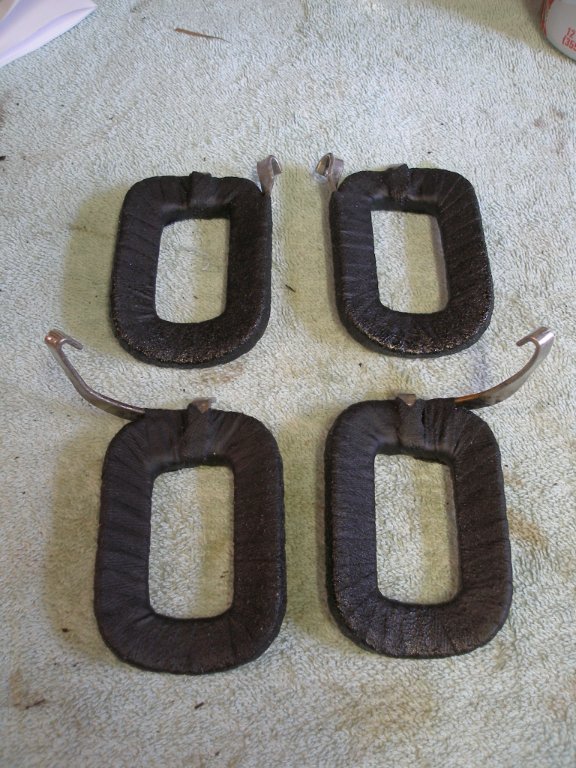

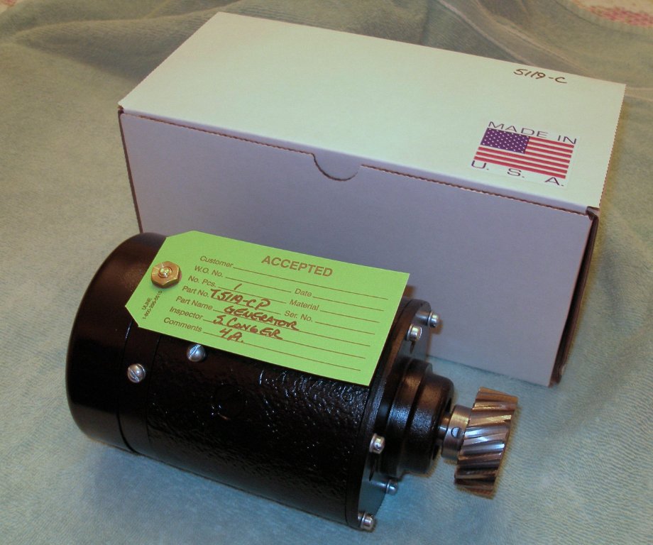

Post by Scott_Conger » Tue Jul 19, 2022 1:52 pm
There's a huge difference between a repaired generator and a remanufactured generator. A repaired one can be expected to last out the door; a remanufactured one can be expected to outlast the purchaser. A remanufactured generator really ought to look like this:
Generator Brush Block 1.png (204.15 KiB) Viewed 3752 times
Generator Side.png (181.92 KiB) Viewed 3752 times
Remanufactured Model T Generator.png (203.86 KiB) Viewed 3752 times
windings should either be new or rewrapped
I quit remanufacturing generators when I realized I was competing against eBay Krylon rebuilds, and explainations that a rewound armature cost me more than an entire Krylon Rebuild would cost the buyer all too often fell on deaf ears. The Krylon all to frequently won out. 50 or so generators out the door and never a complaint, so they can in fact, be made to be reliable.
For an experiment, I once reworked a half-dozen armatures...turned, polished, undercut, insulated and tested...and attempted to sell them. Couldn't sell a single one. Am thinking about sending them to Hank and let them go to China, too. ;)
Key up the alternator sales pitches now.
