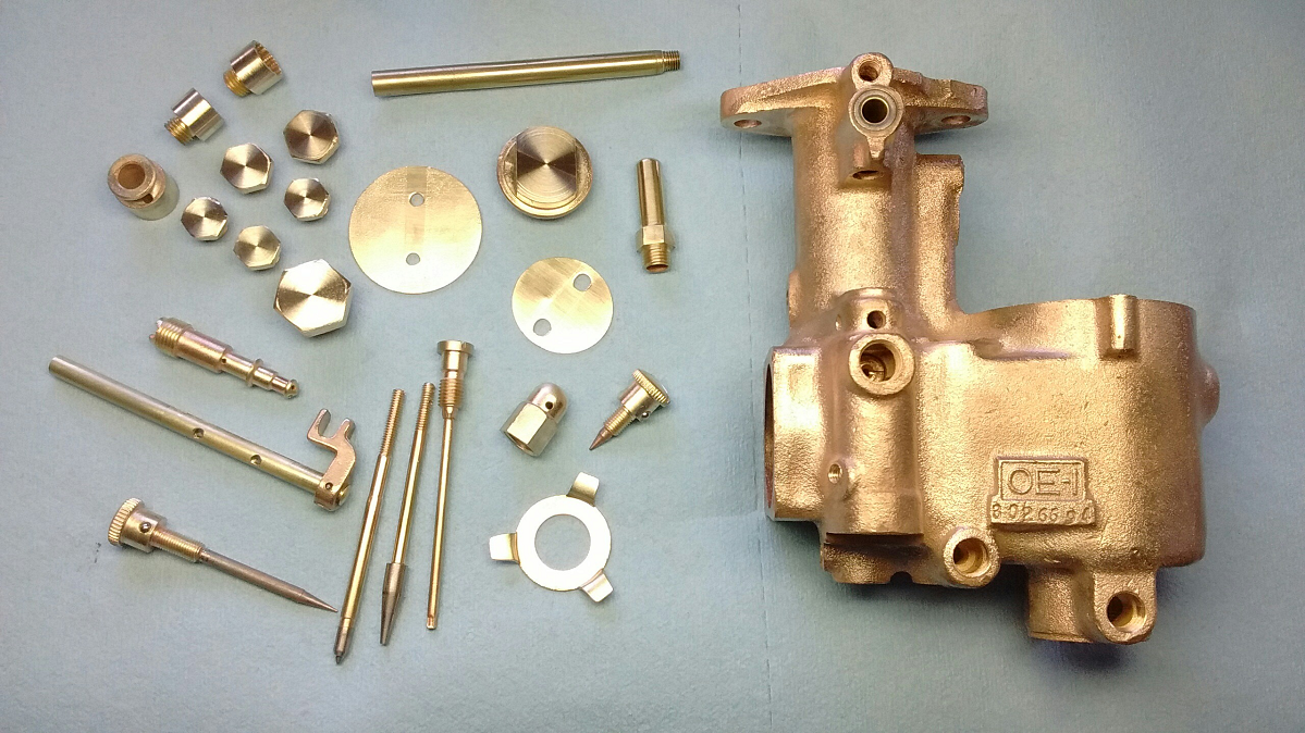

Glad you have it sorted Paul!
Nice pic for obvious reasons Scott.
