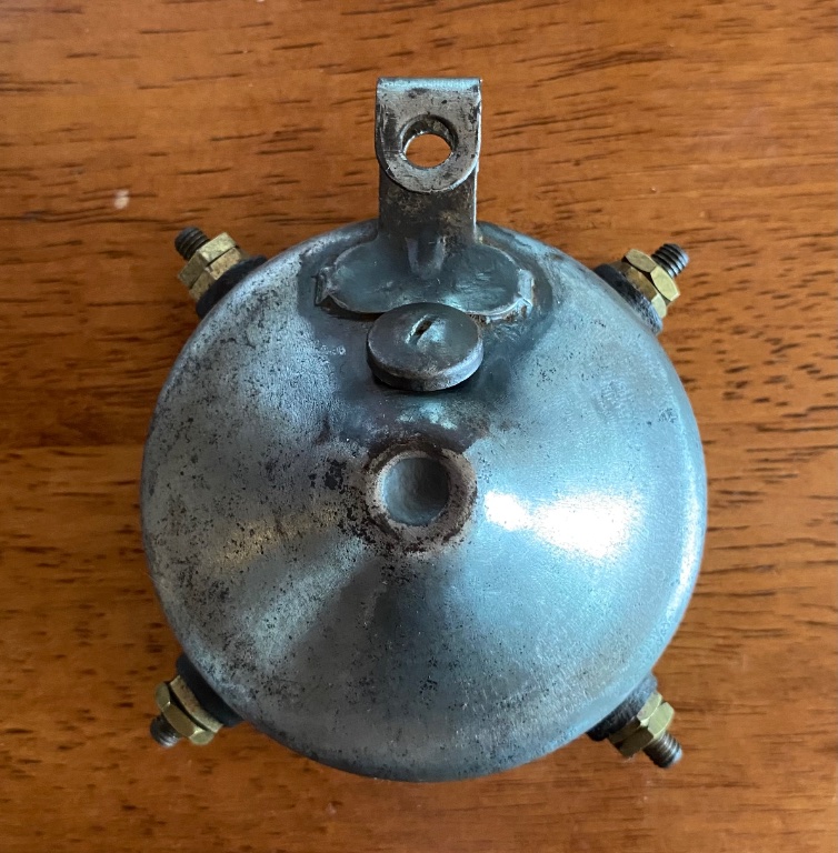

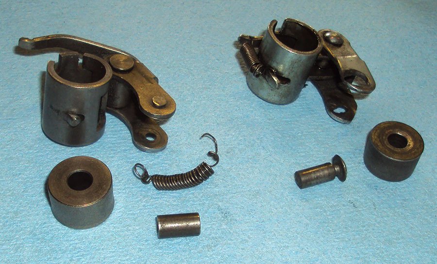

Got some USED TIMERS in the mail. The contact rings look serviceable. I might get some rollers and test them out.

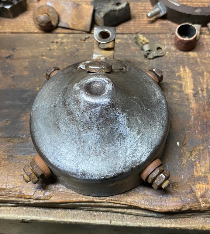

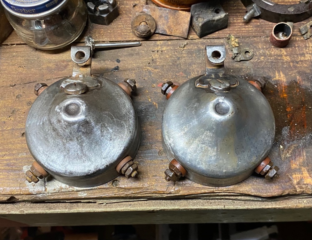

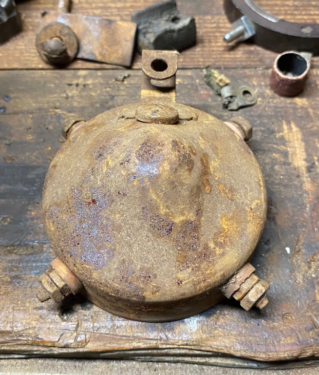

Second timer on the right I attempted to polish. Both looked like the last picture when I started

That is excellent. Get all the good out of them. Check the rollers and pins. They are the next to wear out. I wore out 3 rollers in one timer on a tour due to worn out pins.
Too many good timers have been discarded. Some only need better insulation around the terminals.

I got 11 of them for the price of shipping. None had rollers. New rollers are 25 bucks.Rich Eagle wrote: ↑Sun Aug 07, 2022 5:23 pmThat is excellent. Get all the good out of them. Check the rollers and pins. They are the next to wear out. I wore out 3 rollers in one timer on a tour due to worn out pins.

Will, great job on cleaning up. I agree with Rich, plenty of life and serviceability in these old timers! Not trying to misdirect your post, but if you are looking for rollers, please let me know. I have several that are taking up shelf space and will cut you a deal compared to that $25 list price.Will_Vanderburg wrote: ↑Sun Aug 07, 2022 5:35 pmI got 11 of them for the price of shipping. None had rollers. New rollers are 25 bucks.Rich Eagle wrote: ↑Sun Aug 07, 2022 5:23 pmThat is excellent. Get all the good out of them. Check the rollers and pins. They are the next to wear out. I wore out 3 rollers in one timer on a tour due to worn out pins.

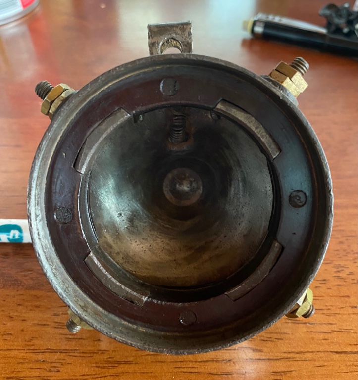

What is important is the smoothness & concentricity of the contact & insulator rings.
They will need to be trued up on a lathe. They must be PERFECT or the roller will bounce @ the higher rpm range.
What do they look like inside? pix?

The insulators on these two look very smooth and round with no ridges or gouges. Lite surface rust on the interior body
A lathe is out of the question.

This one turned out better than the other three

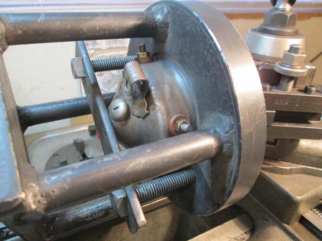

- Posts: 5594
Re: Cleaning up some timers

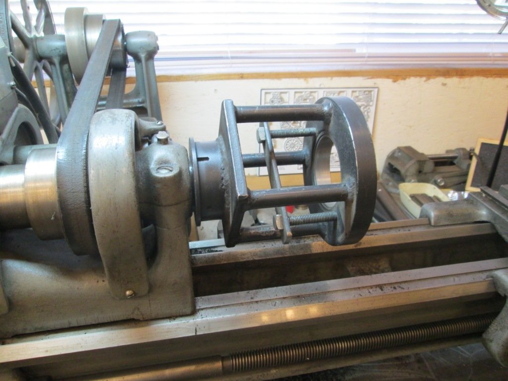

Here's what I use to true up timer runways. I inherited it from Otis Clinton of Seattle, WA many years ago.
- Posts: 6802
Steve
that's a nice early S/B! I have two, with one being a 1936 version all but identical to yours (right down to the Aloris AXA tooling).
- Posts: 5594
I bought mine from an old friend, deceased now but he purchased two new ones at a school surplus auction around WWII time. This one was slightly used in their gravel co. machine shop for "little" stuff - he sold me this one & bolted his new one to the bench !
