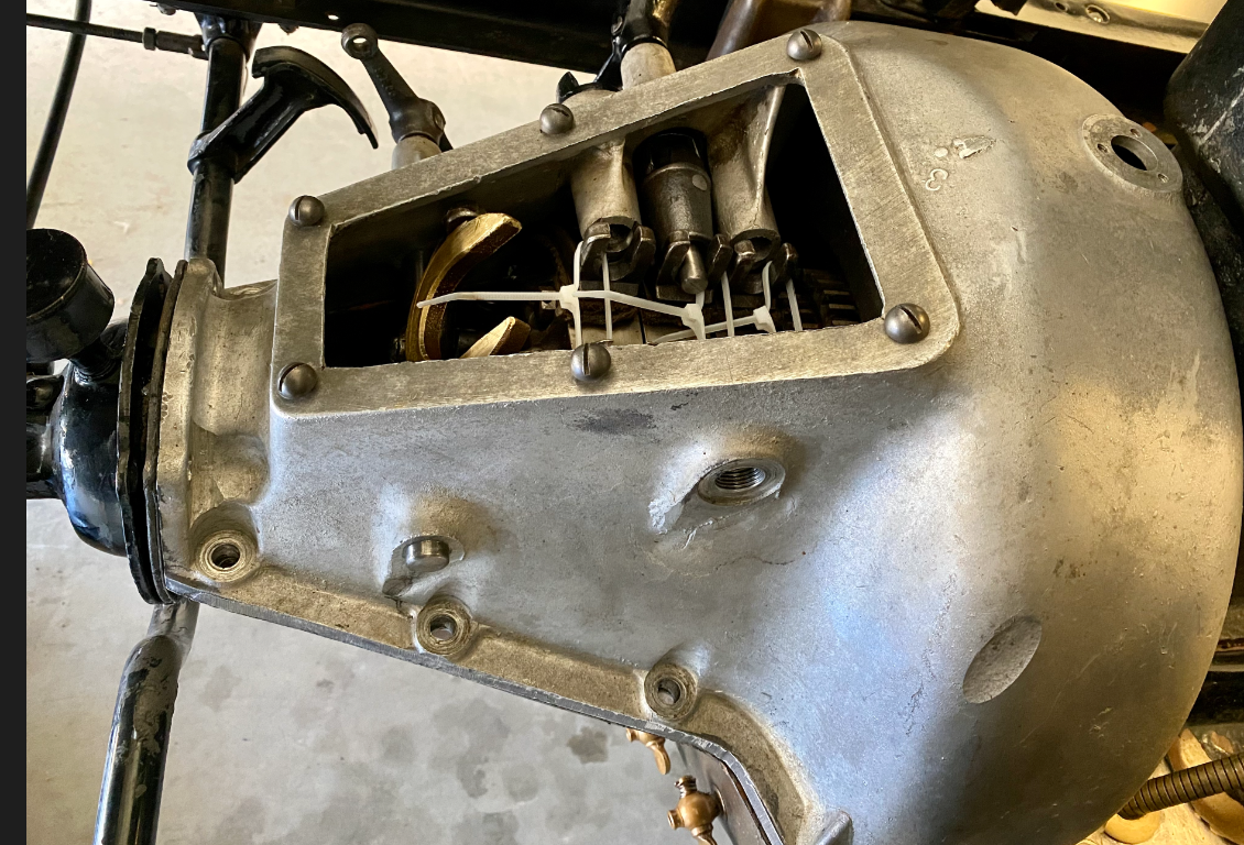

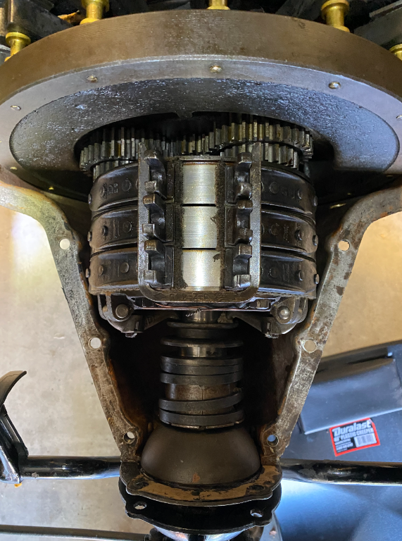

The hogshead on my 15 isn't settling in right and the Ford service book doesn't seem to have an answer why.
The car came to me in mid re-restoration with the hogshead off. Before reinstalling it I removed the reverse and brake pedals and disconnected the clutch pedal from the clutch lever shaft. The clutch release ring is clean and freshly greased, the shafts are all oiled, and basically everything that could get in the way is cleared off. The pan is also clean.
The hogshead mostly lowers onto the pan readily enough, the bolt holes line up and the clutch release ring fits easily. But there is a stubborn quarter inch or less gap from the pan, even with the band clip removed. The hogshead rocks from side to side in this condition.
Can't get to the gasket stage until it sets down, so what could be going on here, has anyone experienced this?

the band clamp AND the hogs head cannot fit the same space...once the bands are captured by the pedal shafts you have to withdraw the band clamps and the whole thing will settle into place. The bosses in an aluminum hogs head come intimately close to the tops of the bands even without the clamp holding it up. It's for this reason many people run into problems trying to fit removable ear bands to early cars. I commend you for discovering this without breaking your hogs head as the majority of folks often do.

I never use that clamp to hold the bands in place. On our RHD cars both the reverse and brake pedals are fixed in the hogshead, the clutch pedal being the removable one, but it should make no difference. I tie the band ears together with a single strand of copper wire. I use copper so that if I was to lose a bit, it would not get sucked onto a flywheel magnet.
The trick is to tie the band ears together just far enough apart to allow the shaft springs to settle between them. I back the two adjusters right out to leave the maximum gap. I have the clutch pedal spring, washer and notched nut already in place to avoid the chance of dropping bits trying to fit them with the hogshead in place. Two or three turns on the thread is enough to hold the nut there.
The hangup can come when one of the three springs rests on top of a band ear. A stout screwdriver will usually set the errant spring into the gap between the band ears, hence the pre-setting of the gaps in the ears. Once the springs are nestled between the ear, the copper tie wires are removed and the cover can be lowered into position.

Tie wrap the the bands. Not around both ears on each side of bands just one ear on each side.

Thanks for the replies! I did remove the magneto post, but forgot its still in the older hogshead photo I posted. I'll wire the bands and see where that goes. Allan, agree on zip ties, they would be pretty stubborn. Dan, tinge on one ear sounds like it would make it simpler to remove once in place, is that right?
I'll also look carefully to see if there is anything between the block and magneto that's holding things up. It's not easy to see on a car with a body in place. One thought is whether the clutch release ring isn't settling down completely onto the shaft, so I'll try to diagnose that to see if that's occurring or not. Scott, thanks for the good words, I'm very careful with this machine.

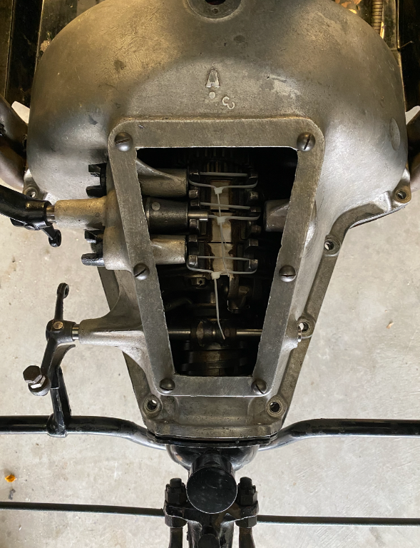

Here are some photos from this morning.
I removed the clip and tied the bands in place, but no dice, it would not settle down. The sticking point seems to be the clutch release ring, but not sure why. Getting closer . . .

Gotta say that the hogs head looks like it is fully (or much more) seated across the bands with the clip removed
you know which "groove" to fit the throw out bearing into, right?
I'd also ask if the pan has been straightened, and if possible, rotate the clutch throwout up and completely out of the way and see if the cover then seats...if it doesn't, it may be settling down on the 4th main and the 4th main is in fact not lined up with the pan properly (thus the straightening question)

Success! I turned up the clutch release ring as suggested and the hogshead settled down, nice and flush. So the sticking point is the clutch release ring or clutch spring, not the casting or the pan. So now to find out what exactly is going on here and solve it.
There are no words for how good it is to see this big fragile casting settle down nice and tight. Thanks for the advice and ideas. Here are some shots from today of the hogshead all settled down, and the clutch spring location.

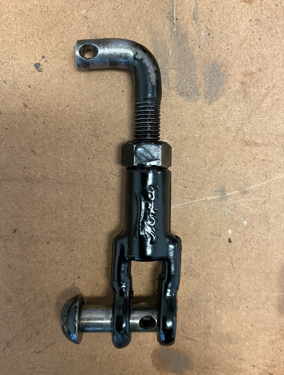

The clutch release ring is definitely stiff, and doesn't swivel readily on the clutch release forks. The shaft does move somewhat freely within the hogshead casting though.
Kim, I think thats right, these parts all look like NOS and the clutch release ring has a Ford logo. I talked with a friend this morning who suggested using a block with 320 grit paper to carefully smooth out the surface. Marking the ring would be a good start to see where the problem is.
The slow speed connection and clevis are a similar issue with a very tight clevis pin. When linked up to the clutch pedal, threw the release ring out of alignment, and visa versa. This is something to solve after the hogshead is settled, but seems to share some common issues.
Here's the slow speed connection and clevis. The connection is oriented the wrong direction, mostly because I forgot to set it out properly when taking the photo.

There has to be a little slop in the clutch linkage, usually at the bent end. Because the pedal moves left and right in operation, There must be a smidgeon of play to allow this movement. I once found a linkage which had a ball joint on the pedal end, overkill, but a very neat fit.

All done. I gently sanded the clutch release ring to fit, lubed as necessary, lay down the gaskets, felt and goo and watched it settle in. Today I installed the pedals and springs, removed the rags and fit up the cover. I was advised the hogshead would settle down overnight and it did, lots of careful adjusting back and forth with the bolts. Cotter pins and clutch linkage left to do but the magneto post is back on and hooked up.
It was a good weekend. Thanks everyone who answered and gave advice, I appreciate it very much. It helped figure out the issue, isolate it and address it safely and appropriately. Looking forward to the adjusting and final touches.
