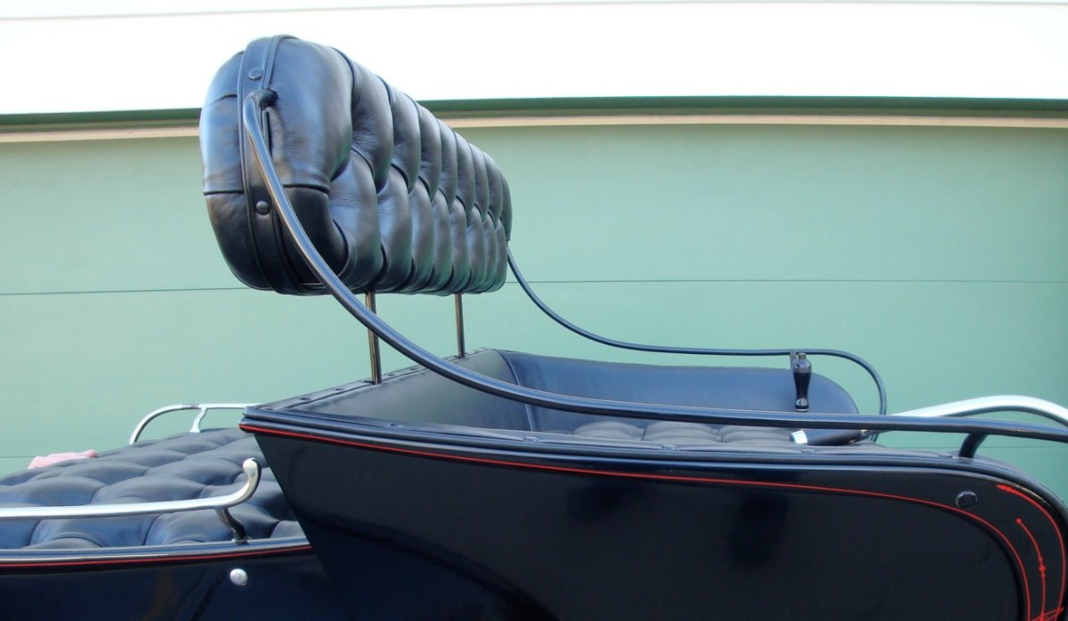

My dad did the leather upholstery himself on his 1900 Waverley Electric - diamond tufting and square tufting using horse hair. See photos below. (There's a second seat cushion on the back of the car. The rear passengers sit back-to-back to the driver and front passenger aka "Dos-a-Dos.")
My dad did have original leather from his Waverley to compare to available samples. He ended up going with "Casino Black" 16100 that he purchased from Goldfield Trim and Upholstery. It is available in half hides and whole hides. It has a definite sheen/shine and is not dull like upholstery used in modern cars.
