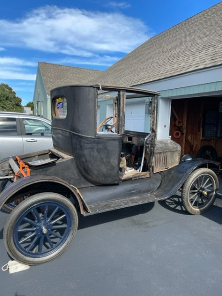

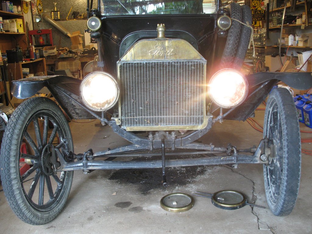

Hi all,
Last night with the help of my buddy Bob (who knows way more than me) we finished rebuilding my non functioning generator. New bearings, cleaned up the wiring, had a great shop coat the armature with red insulating varnish, put it all together and it worked! I now have lights of all things! A week ago I went to a cruise night with no genny or lights and came home in the dark. People flashing lights at me. Even passed two cops. It was very unsettling driving in the dark. Anyway, all it well and we still have to adjust for proper amperage with the third brush. It's been such a great learning experience.
John

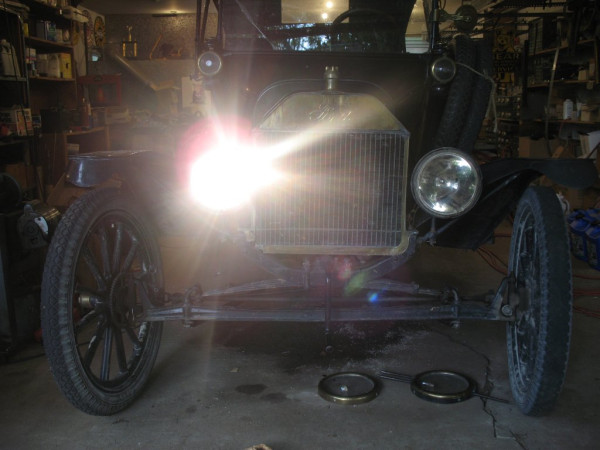

Do you have stock lighting? You probably won't be able to get the generator to carry the full lighting load without showing some discharge. The best setting seems to be around 6 to 7 amps indicated on a good ammeter with the lights off, the battery charged, and the engine running about 1300 RPM. This will typically result in the ammeter showing about 0, or a small discharge of around 1 to 2 amps when the lights are on and the engine running at the same speed. Adding higher wattage headlight bulbs, an additional tail light, or any other increased load will require more power. A discharged battery will consume more current until it comes up to near full charge. Higher settings risk overcharging the battery if you drive much, and perhaps overloading the generator.

OK, so I have standard lights; and we (my buddy Bob) tested and got the amp gauge reading 0 or a little under 0 when the lights were on. Same on dim and high beam. When I turned lights off, we (my buddy Bob) got the amp gauge reading between 15 and 30 amps. That's way too much, right? So he kept adjusting the third brush and got it down, but I think it was over 15 amps on the gauge. We (Bob) will work on the correct timing, correct fuel mix, and correct valve adjustment until it is working properly. BTW, I put new kevlar bands on and still don't have the low band adjusted correctly. Still slipping. That will come in time.
Thanks for the help. It's great knowing that if I have a problem I can put the question on the forum and great people will offer suggestions. Bravo to you all in T land.

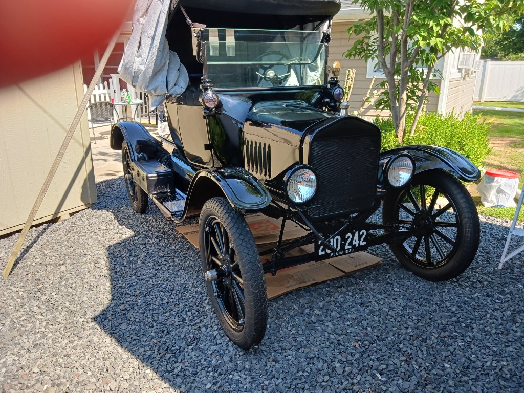

Post by TheSaintDiscJockey » Fri Sep 09, 2022 11:21 am

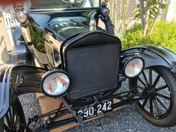

I have spent a lot of time since early June working on the "new" '23 TT. The '20 Roadster was sidelined for the past few months. Cleaned up nicely this morning and started right up on the first crank.
Almost got a free start, too. A good morning...

" ...amp gauge reading between 15 and 30 amps. That's way too much, right? So he kept adjusting the third brush and got it down, but I think it was over 15 amps on the gauge."
That's way too high. I wonder if your amp gauge is reading anywhere near accurately.
The regular Ford lighting system ought not draw more than 5 or 6 amps, and the ignition maybe add an additional 1.5 amps or so. If your generator is putting out 15+ amps at an engine speed of 1200-1800 RPM with the lights off, turning on the lights ought not bring the amp reading anywhere near 0. Do you have a good battery connected to the system? Are all the connections clean and tight? Are you using an in-dash ammeter, or some other ammeter? The generator needs to be connected to a system with a good battery in place and the cutout working properly. All connections throughout the system must be clean and tight. Measure amps, not volts. If you measure voltage, it should not exceed 8 to 9 volts. The regular in-dash ammeters are known to be inaccurate, often as not.
Re: What have you done with your model T in September?
Post by Norman Kling » Fri Sep 09, 2022 12:54 pm
I would suggest you place another ammeter in line between the generator and the terminal block. Be sure it is connected securely so the generator does not try to charge nothing. Then read the other ammeter. This will give you an idea of the accuracy of the one on the dash.

Was the generator "null" point set prior to attempting to regulate the third brush ?

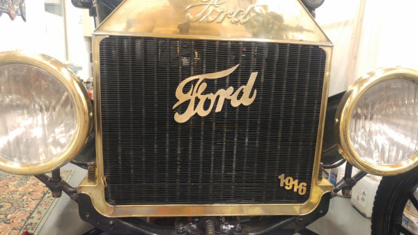

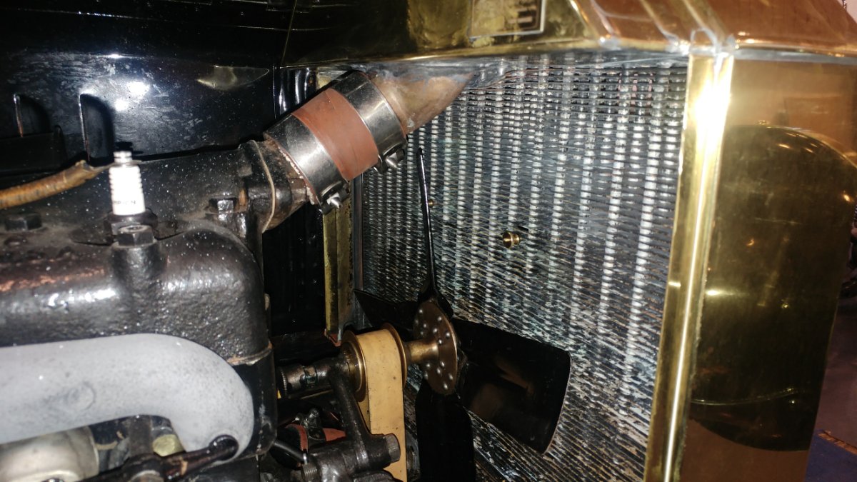

I improved and made radiator decoration.
Radiator decoration
Radiator decoration
I made my own "1916" script for the radiator because I don't like the available ones. I milled it out from 1 mm brass sheet, then hard-soldered brass rods ø3mm with M3 thread at the end to it, polished, and electroplated with gold.
I also soldered same brass rods to the back of the "Ford" script I already had, so there are now no ugly wires visible any more. The Ford script is now also electroplated with gold, so I do not have to polish it again and again.
Here after soldering, before polishing the back side.
Hard-soldering mounting rods (silver solder)
All decoration scripts are mounted to the front with two black Nylon washers (1 mm each) between script and radiator fins, so they don't reduce air flow and scratch on the radiator. This also looks more elegant, they seem to "fly". On back side there is another Nylon washer, a thin brass washer, and finally a thumb nut.
Mounting of Ford script

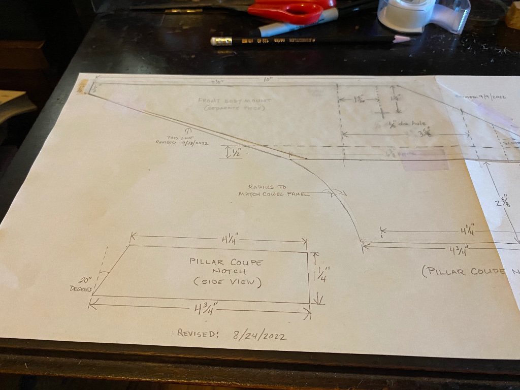

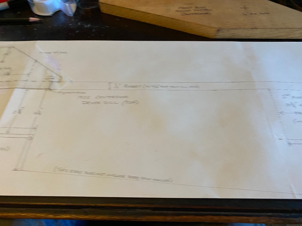

Drawing some plans
William L Vanderburg

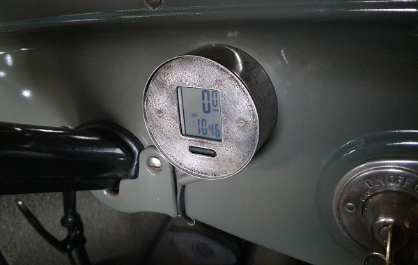

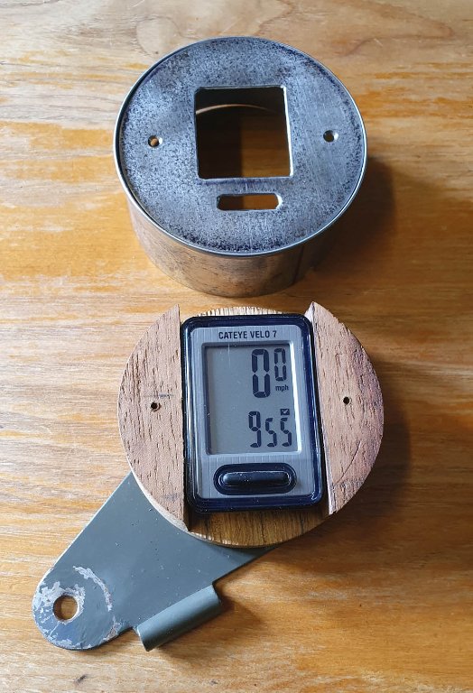

Time for a new speedometer for my '26 Coupe!!
I have been driving with a bike speedo in a wooden case for 20 years (photo), but found the trip miles hard to see.
So this month's project has been to make a better one.
I found a Cateye Velo 7 which has large clear numbers. It can be programmed to the nearest cm of tyre circumference, and it also allows you to input a total mileage figure, so you don't have to go back to zero when the battery is replaced.
The core is wood, the outer casing is part of a tin can, and I cut the front from thin steel. All laquered.
I kept my old mounting - a triangular plate which clamps behind the steering column bracket - so no holes in the dash.
I kept my old sensor - a reed switch in a brass tube on the left front hub with a 2-core screened cable which I connected into the new base.
The 2 screws on the front allow the front and case to be pulled off, and then the instrument can be slid upwards to change the battery.

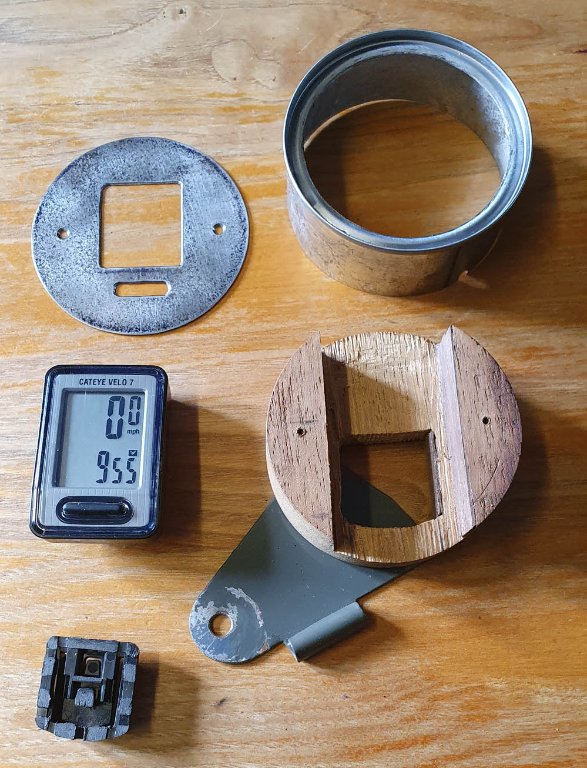

At auctions and swap meets over the years I've bought a few dozen bulbs that fit magneto headlamp sockets. Not all were intended to be used for magneto lights, but most will serve to varying degrees. One requirement, with the lights connected in series, is that both bulbs be similar in resistance. If they're not, one will be bright and the other dim. In some cases, one will be very bright (and my burn out quickly) while the other provides a ground but doesn't light up. One of the bulbs in my car burned out yesterday, so today I tested bulbs looking for a replacement.
The ideal combination is two of the same bulb.
I decided to make a mag bulb tester that will work from a battery so I won't have to run the car for testing. None of the local parts stores had the proper sockets, of course, so I have to wait for a pair to come from the internet sometime next week.
From reading you might think that mag bulbs are likely to last only a few hours or a few days. But the one I have to replace was in the car for at least two years. I don't usually shut off the headlights. When the car is running they're on. So this pair got over 4000 miles of use before one of them went.
You may see magneto bulbs offered by one of the parts dealers. Pass. They're 24 volt bulbs, too dim for actual use. Display only.

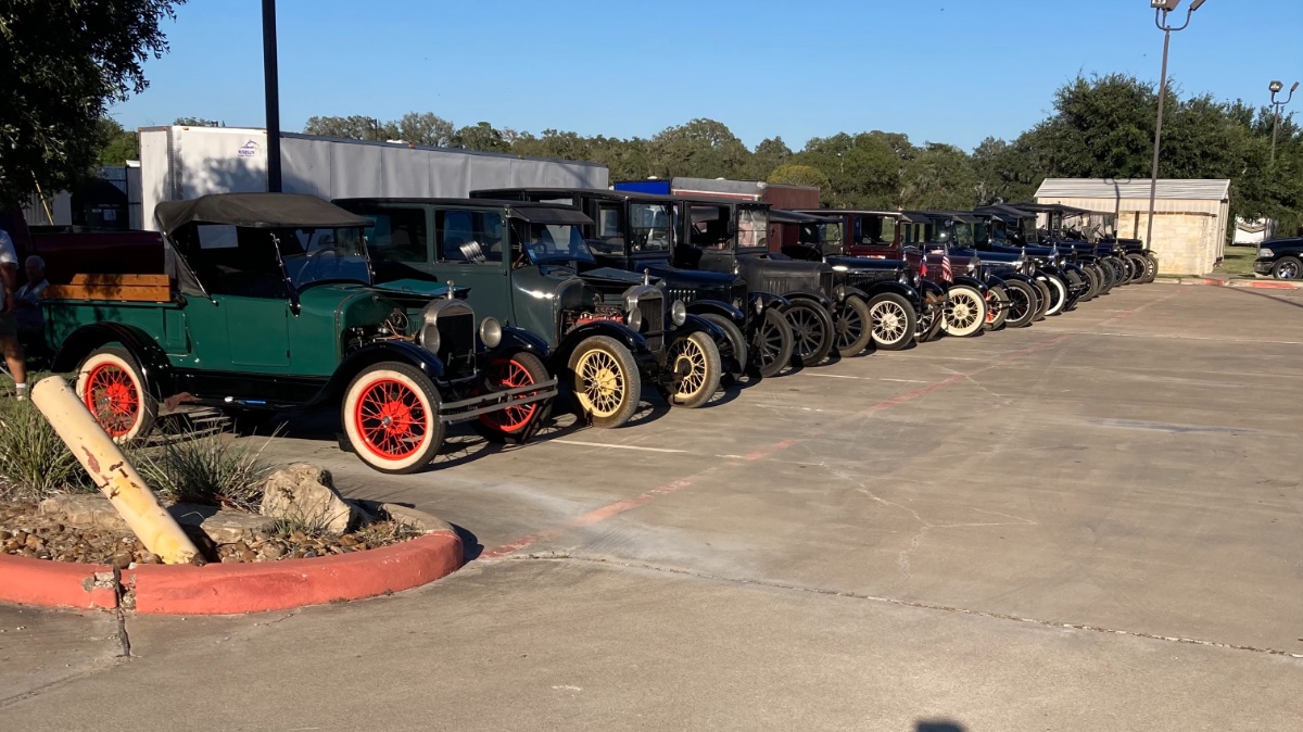

We arrived early for the 45th annual Texas T Party. Starts tomorrow-Saturday but 90 Model Ts have arrived for a ‘hub tour’ from Halletsville, TX.
