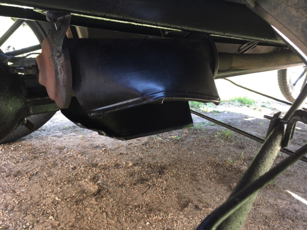

While at O’Reille’s, get a hot patch kit for that muffler
