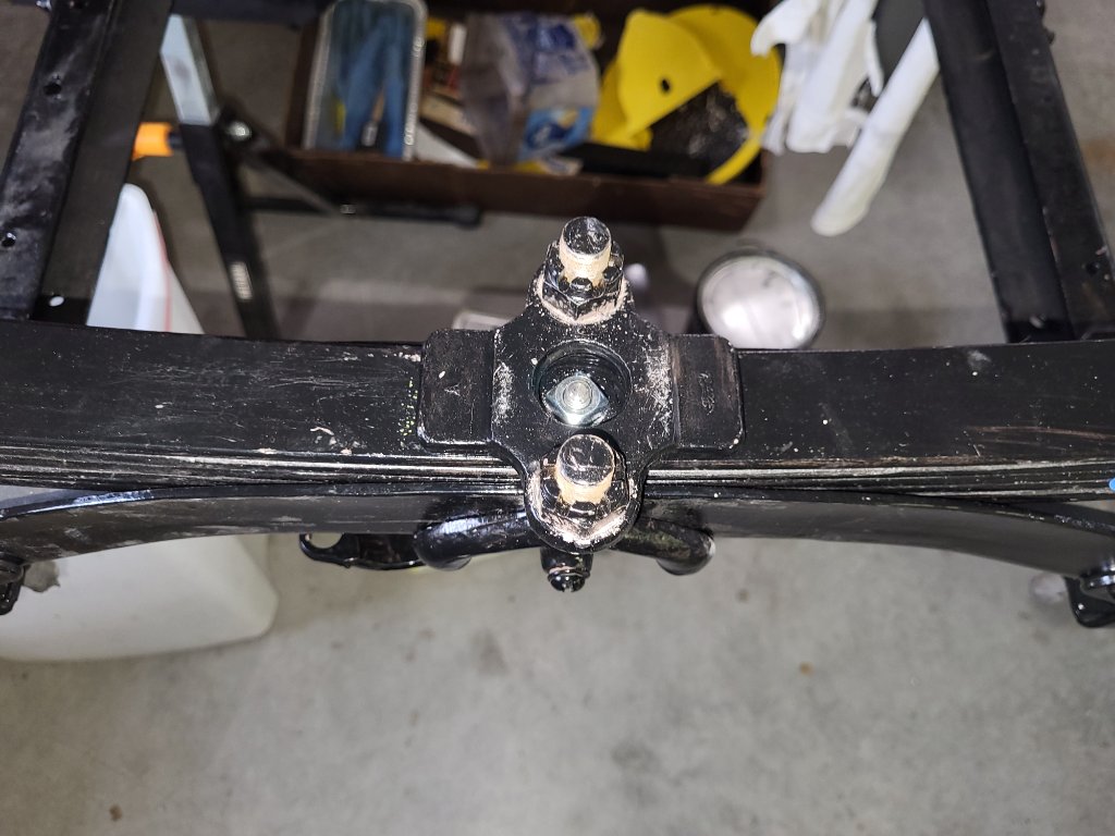

I have installed the front spring on my 1927 coupe as shown in the attached photos.

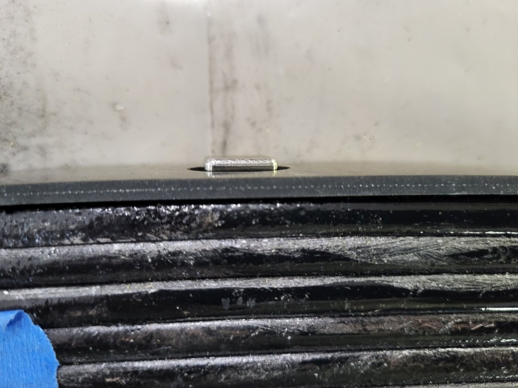

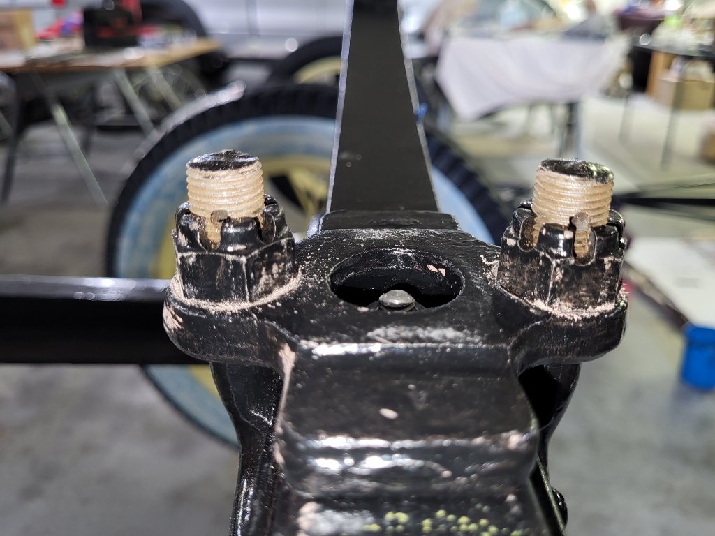

The second photo shows the 1/8 " rubber pad on the spring. The third photo shows the bolt head in the hole in cross member. It does not completely penetrant the hole, but I assume there is sufficient penetration . The fourth and fifth are of the bottom connection.

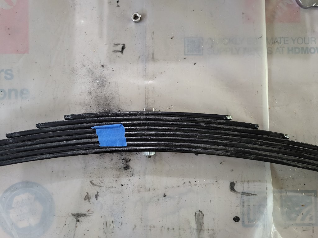

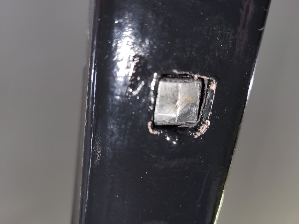

After installation, I realized the recessed "square" nut will not allow me to retighten the bolt if needed after putting some miles on the coupe. Should I replace the nut with one that will allow tightening with a socket? I suppose a square nut was provide because that was the original.
The fifth shows that the holes for the cotter keys are above the nut.

I would change the nut, a period castle nut would also be, well, 'period correct'

Get it tight now, stake it, and don't worry about it. There is so much tension that the spring is essentially a giant lockwasher.
BTW- you could tighten it afterward with square sockets.

You just need an 8 point socket.

A person might install a washer under each castle nut to ensure the cotter pins engage properly.
Your rebuild looks good.

I would use washers under the castle nuts. Common washers may not fit flat. Use washers that will lay flat on the surface the nut seats on. I would not use grade 8 washers there.

Many of the supplies provide a center bolt where the head is not high enough. I use the ones from T springs which are nice and tall.

If you used an original style spring pad, the bolt head would engage the frame hole more. The spring bolt should already have been tightened prior to placement in the frame and the front engine/spring mount is a great place for lock washers.

The center bolt is there to keep the spring leaves in alignment as much as anything. The mounting clamp keeps things tight. Once the spring is assembled, the nut staked, you shouldn't need to do anything more with it. There should not be enough movement at the point where the bolt goes through to worry. It would be hard to re-stake it later if it did get loose. If you are worried, I would use a regular hex nut, not a slotted or castle nut. But be sure to stake or peen the end of the bolt, that is what keep the nut from backing off, same as when you install hub bolts and nuts.

8 point sockets are made for use on square nuts. Over the years I have built up a set of 1/2" drive ones of various brands. The prized one is the Snap-on one which fits the square heads on the main bearing bolts. They do come in handy when building wooden bodies/trays using the correct old time hardware.

Then either the socket or the nut is worn. I have never used anything but a 12-point socket on a square nut.BLB27 wrote: ↑Fri Sep 16, 2022 10:45 amThanks for the comments. My responses:
