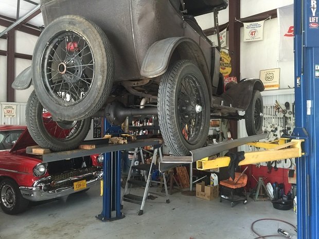

Post by Allan » Mon Sep 19, 2022 8:03 pm
Most will require extensions/alterations to the pickup points to be able to lift the car on the frame. I use my mate's hoist with two long lengths of 4 x 3" hardwood to pick up the front and rear axles. Others will have different ideas.

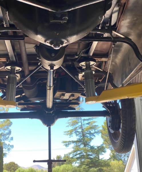

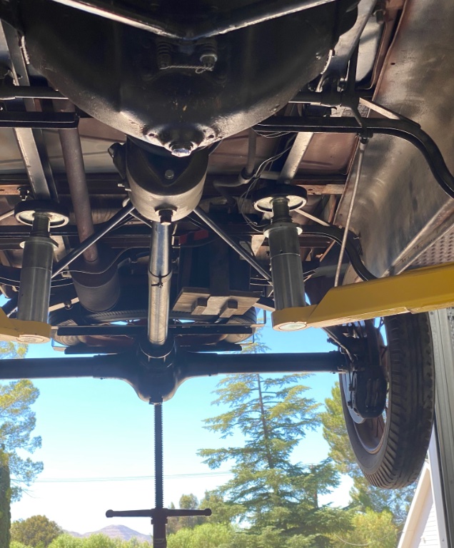

Post by Craig Leach » Mon Sep 19, 2022 11:14 pm
How about this.
Craig.

Post by Duey_C » Mon Sep 19, 2022 11:52 pm
Excellent lift photos and info! I've often wondered how to pick up a T on a lift also Lester.
An old work friend welded 4 floor extensions on his two post lift as he wasn't real sure about the 8 bolts to hold a vehicle safely.

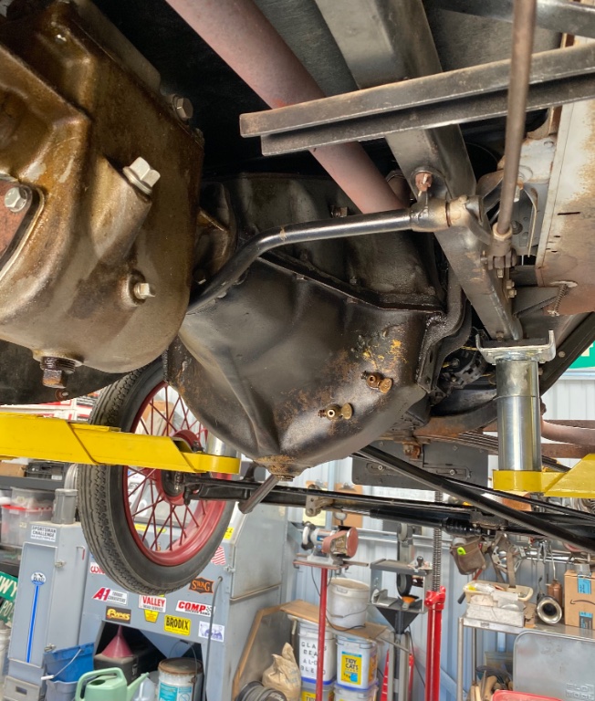

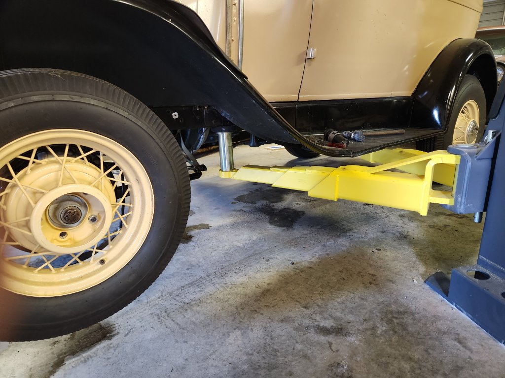

Re: 2 post hoist
Post by Chris Haynes » Mon Sep 19, 2022 11:58 pm
Here is my Model A on my Two Post lift. Simple extensions available from the lift maker make it easy.

Re: 2 post hoist
Post by Allan » Tue Sep 20, 2022 12:30 am
I considered Craig's channel solution before opting for the wooden beams under the axles. They give me access to the wheels, brakes etc.
