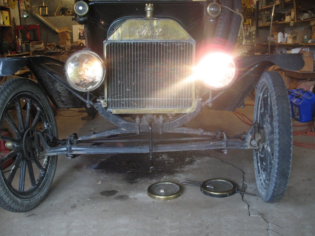

From reading Model T lore you might think magneto headlamps burn out at a furious rate. But when I had a bulb go out last week that pair had been in the car for at least three years. I don't do much night driving, but I seldom shut off the lights. When the car is running the lights are on.
Mag lights being wired in series, like old time Christmas tree lights, when one dies they both go out. Being wired in series also means the bulbs must be the same kind, with the same filament, voltage, resistance, etc.

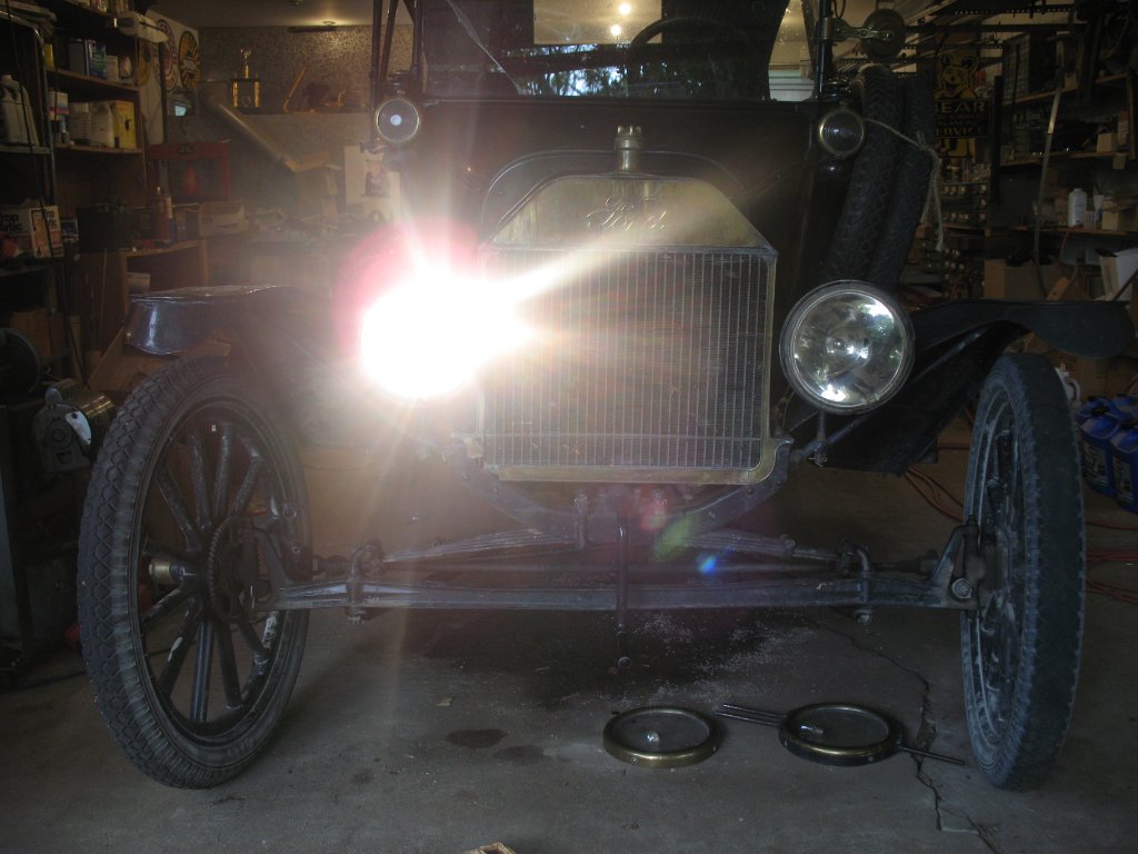

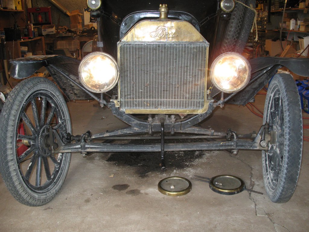

Matching bulbs light equally.
If the bulbs don't match one will be bright and the other dim.
One may be so dim that it doesn't even light.

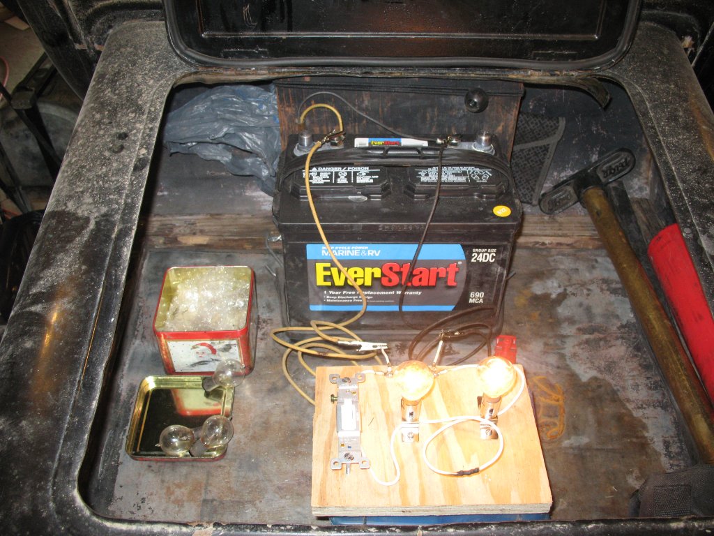

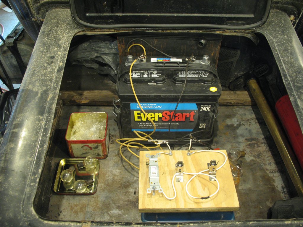

So to be sure the spares I carry in the car are matching pairs, I made a simple tester.
It's just a switch and a pair of 1176 sockets wired in series. I had to buy the sockets online, of course.
If two bulbs light equally I can pack them as a pair.

That sure a large battery just for testing light bulbs.
Posts: 7388
Re: Magneto bulbs
Post by Steve Jelf » Fri Sep 30, 2022 12:22 pm
It comes in handy for running the car. :)
