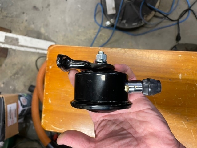

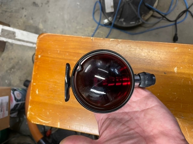

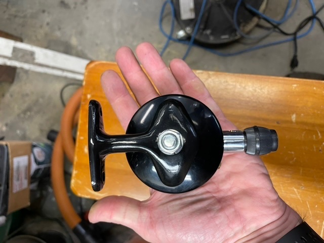

I wanted to put brake and tail lights on my 22 runabout pickup but I wanted them to look period. I bought some of the aftermarket lights then converted them to take the two contact T headlight sockets. I then made up a couple of mounts to screw to the bottom of the bed. I don’t think it looks too bad.

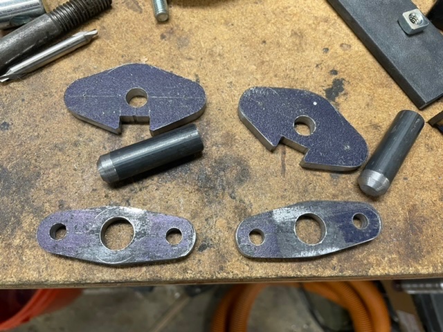

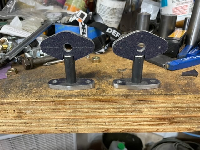

Thanks, looking like they could have been bought out of a period catalogue was the point. This is what the mounts looked like before some bending, welding, and grinding.

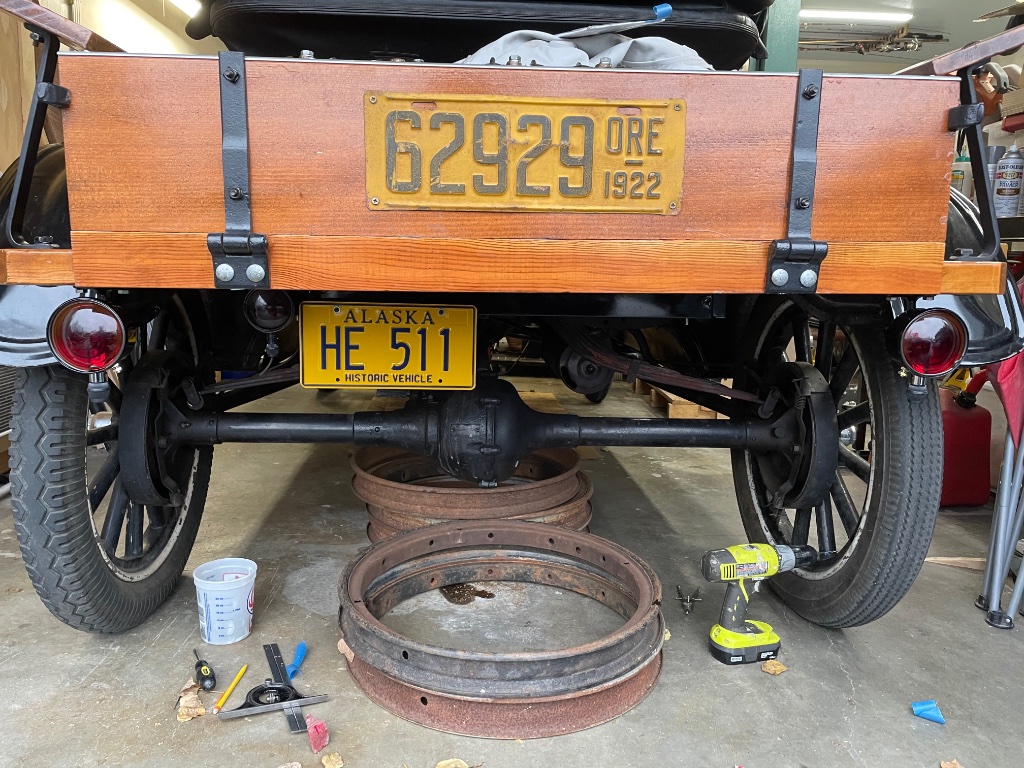

Post by Reno Speedster » Mon Oct 10, 2022 11:13 am
I finally got them on the truck yesterday. I am still running the wiring and installing the switch.

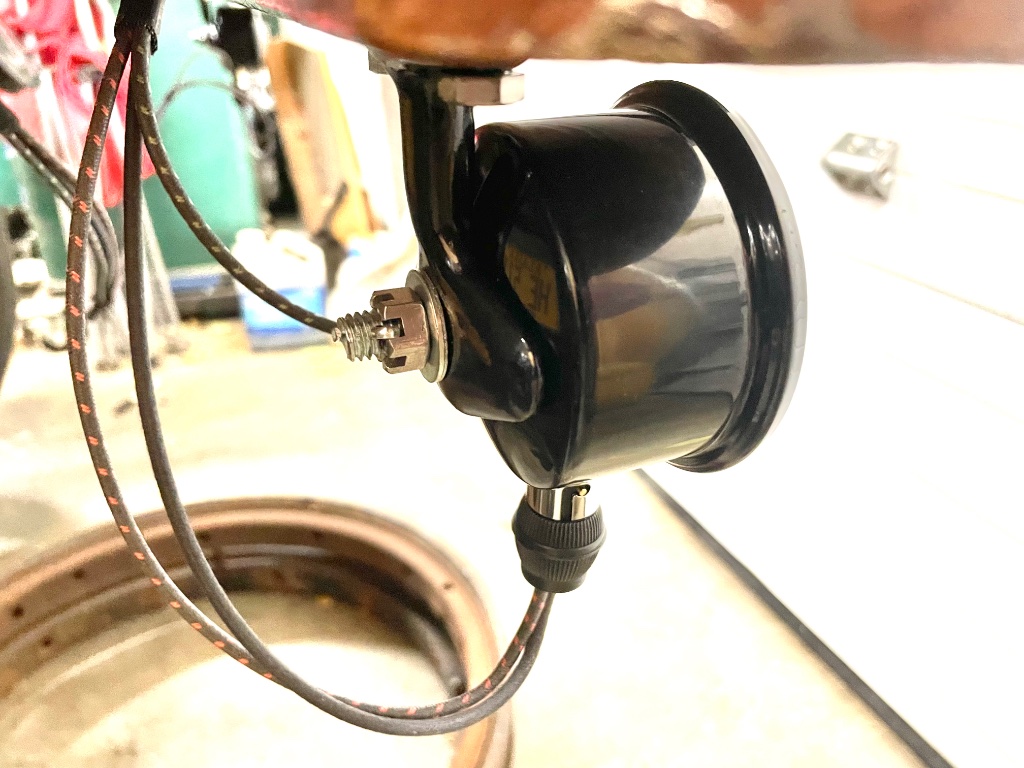

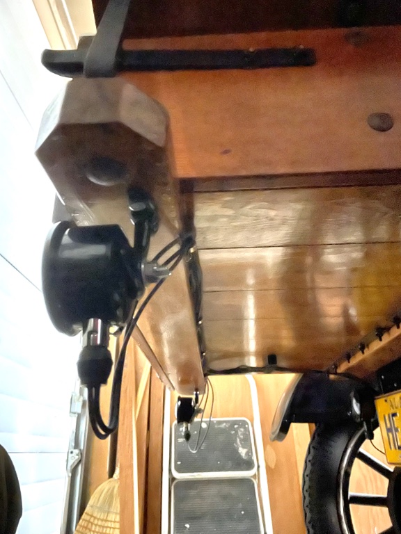

Post by Reno Speedster » Wed Oct 19, 2022 10:12 pm

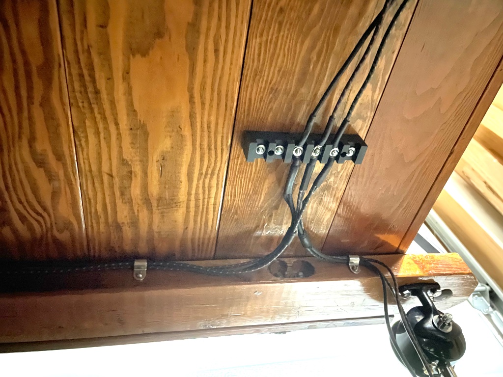

Here are some pictures of the lights wired. I installed an electrical block under the bed. The wires under the bed are held on with stainless clips and screws. I made wire holders using rubber grommets and safety wire to hold the wires going forward. There are some spots on the block under the bed I can use if I ever installed turn signals. It looks pretty tidy to me and period.

Well thought out, very creative period recreation!

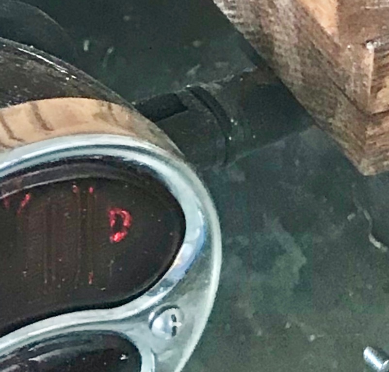

One further thought before you button it up? Buy a foot or two of tar covered cloth conduit loom for the wire loops on the lights? Would really take it over the top for sure. Think I got mine from Renovators Supply?
Crappy picture but shows the loom cover from light to under body.
Thanks. I have several rolls of the old style of electrical tape and I used it under the clips to protect the wires. Not a bad idea to get some of the old cloth/tar cover for the wires to the lights.
