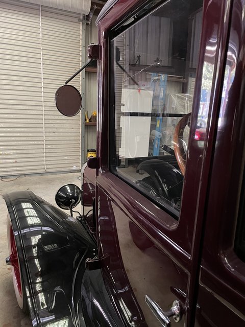

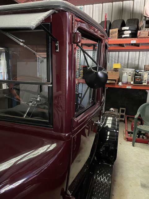

I was disappointed in what was available and bought this set. I had to grind down the threaded end of the stems to 1/4” and re-thread. The housing of the mirrors are plastic so I painted gloss black and they look metal now. Whole process per mirror was 15 minutes and they look great.

The model A mirrors fit my 27 coupe without any modifications. I'm not sure about the differences between 25 and 27 hinges.
