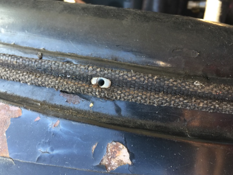

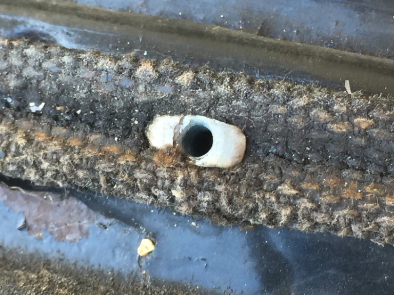

Post by George N Lake Ozark » Sun Oct 09, 2022 4:03 pm
When I did mine the gas tank was in. Previous restorer used pop rivets. I took the rivets and filed the sides down so the rivet sat in the groove better
