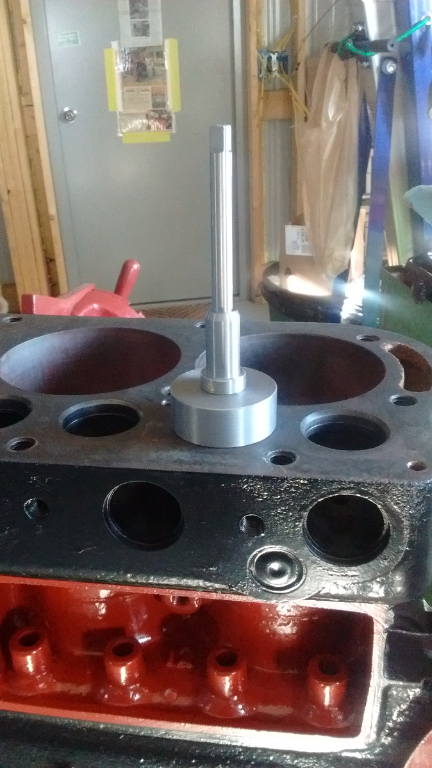

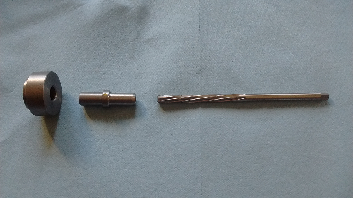

Two years ago, I reamed the valve guides with the engine in the car. The wooden firewall was loosen, but not removed. I made a guiding fixture to maintain reamer alignment. I had excellent results.
The reamer was purchased from a well known and respected supplier.

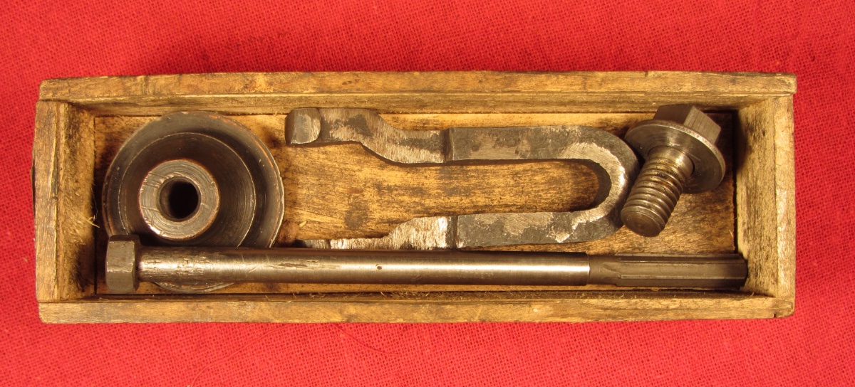

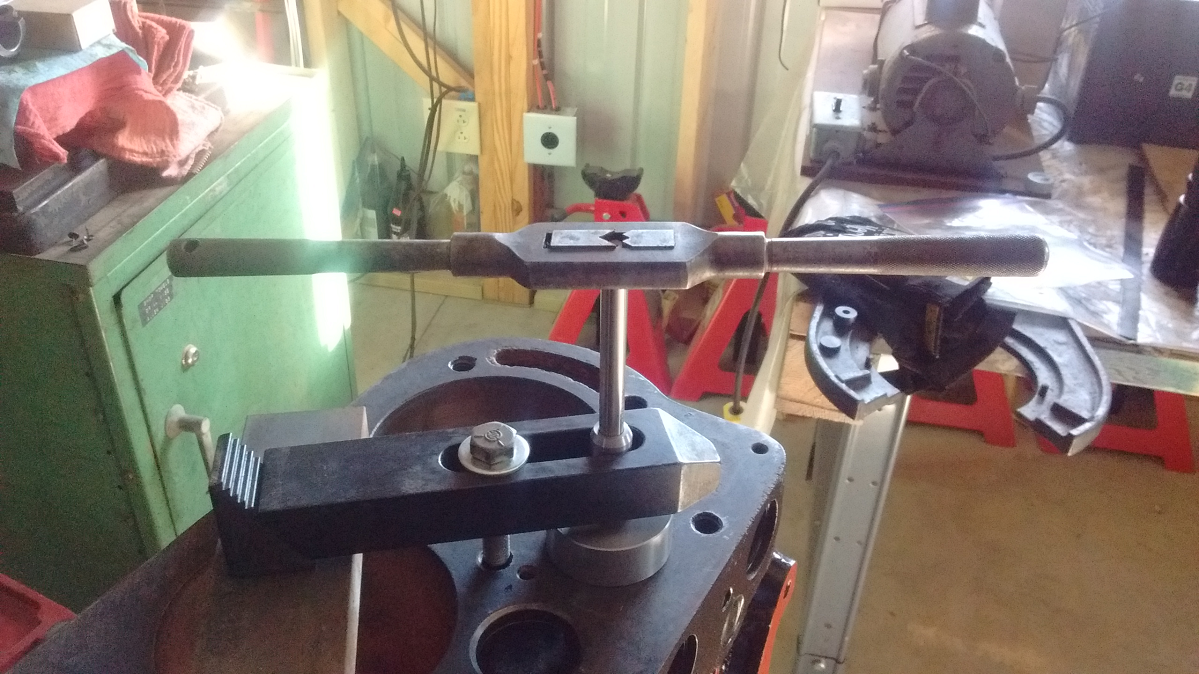

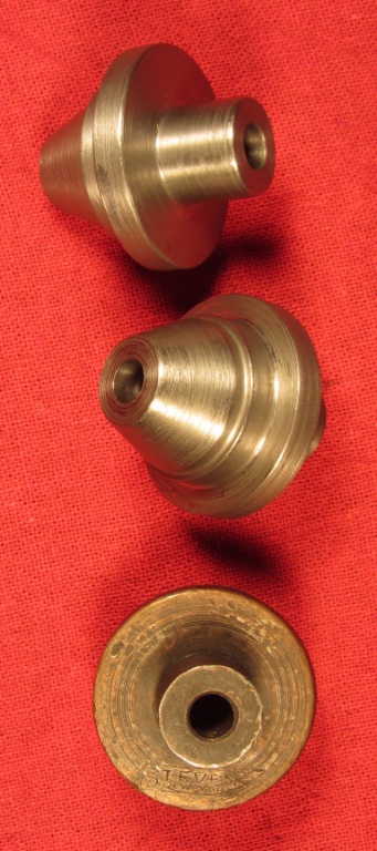

I use the Neway 205 and 636 cutters. These cut 60, 45 and 30 degree angles on the seats.
You will also need several pilots as the reamed guides will typically vary a bit. Neway guides come in .001” plus and minus increments along with standard sizes.
As far as reaming the guides themselves, here are some photos of the Stevens outfit to give you some ideas about the fixture can be made.
