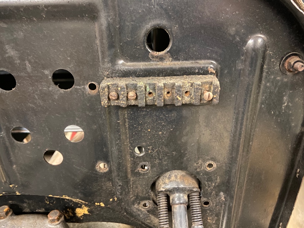

Add a picture of your terminal block on the firewall and your ignition switch. They will tell a lot. If you look at the wiring diagram a magneto horn is wired to the terminal block where the magneto wire is also wired. A battery horn is connected to the terminal block where where the battery wire is connectedArt Ebeling wrote: ↑Fri Oct 28, 2022 9:28 pmI would like to add a generator to this car. I'm going to need a generator and cutout to do that. How would I tell the difference between a 6 volt or magneto horn and lights?TXGOAT2 wrote: ↑Fri Oct 28, 2022 7:23 pmIf it has a block off plate, it should be no problem to install a generator and cutout. Be sure to use the correct bolts. The headlights and horn could be 6 volt or they could be magneto lights. If the car has a plastic or fiber timing gear, it would be a good idea to replace it with a metal one. If the car never had a generator, some wiring changes/additions may be necessary and the magneto lights and horn would need to be replaced with 6 volt items if you want to run the lights, etc, and charge the battery off the generator rather than the magneto.

Ammeter on the switch plate indicates it should have a starter and generator.

The terminal block looks original and indicates that the car originally had a generator.
It most likely has 6 volt lights, horn, and wiring. If the wiring is not present, or to be replaced, choose wiring for an "electric" car, which will have the correct wiring for the generator, ammeter, terminal block, lighting, etc. The ammeter you have will work fine with a generator, as will the starter.

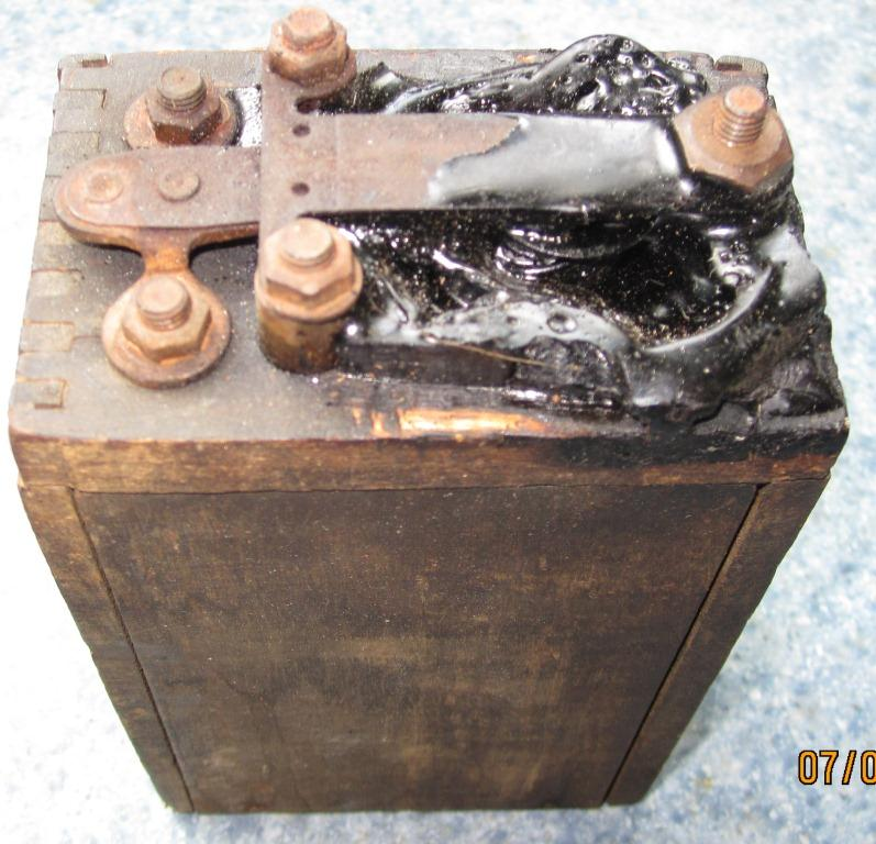

This falls under the "look with your eyes and not your lips catagory". This was in one of several boxes of parts that came with the car. Art

Almost looks like it could be "new", i.e. never used? Give it a try!

We've already deducted that you probably have a battery horn. But you can confirm that with a peek into the business end. If there's an adjusting screw in the center of the diaphragm it's a magneto horn. If the diaphragm doesn't have an adjusting screw in the center it's a battery horn.

Ok Art, looking with my eyes; the screws holding the end plate on are wrong.
