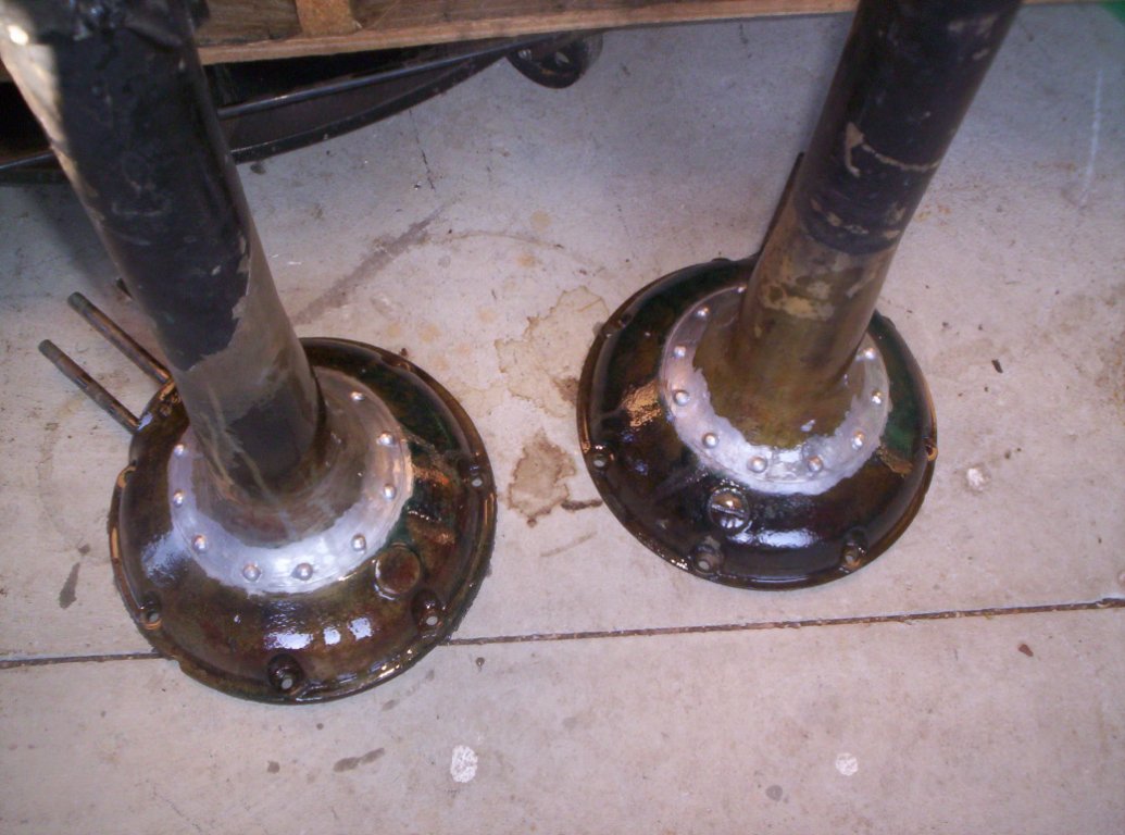

Pull it apart, clean, tin and reassemble with new rivets and sweat inside and outside with 50/50 tin/lead solder.

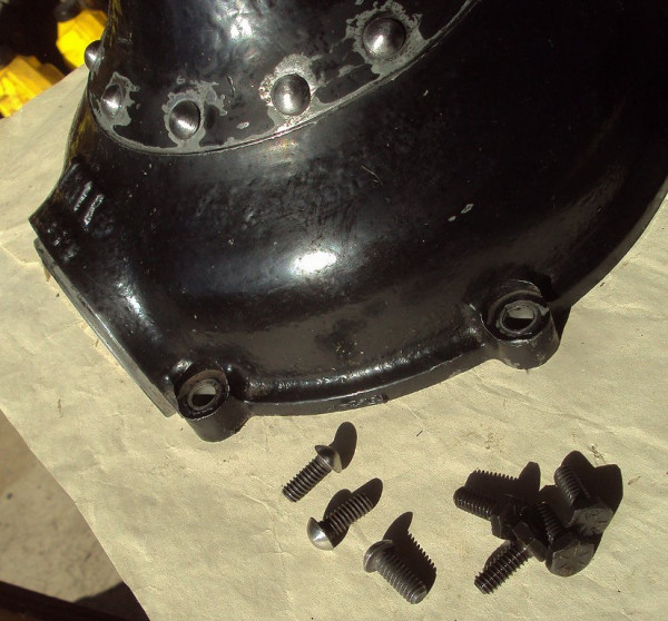

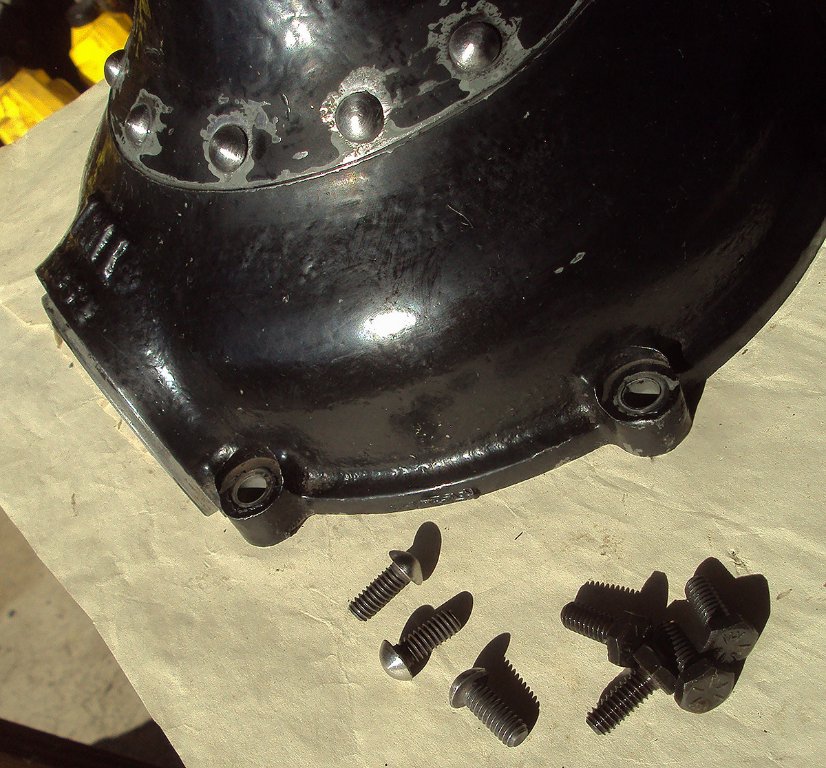

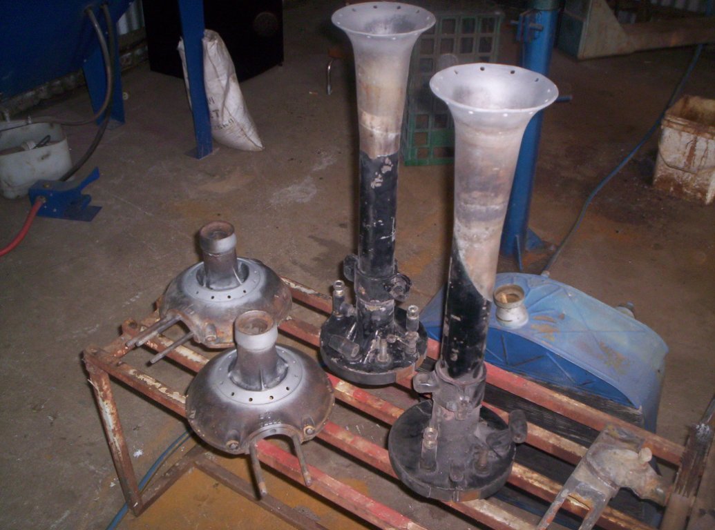

I'd pull it apart too, and have the pieces hot tanked to remove all grease and crud. I put mine back together with nuts and bolts. The bolt heads are turned to look like rivet heads. The inside end is slotted to take a screwdriver to hold the bolt as it is tightened. Two Loktite products are needed. Red 515 non hardening flange sealant around the inner end of the centre castings and around the flanges through which the bolts are fitted. Nut loc is used on the nuts, and if you are worried, the ends of the slotted bolts can be bent out to act as a locker. Because the sealant does not set, movement/shocks to the axle assembly will not open it up to possible leaks. It also stays flexible around the bolts.

I restored my ‘14 rear axle housings just like Allan. I might add that I used #8 bolts and nuts.

Some time ago, I re-riveted a set of housings for a fellow forum member. Everything was cleaned very well. Loads of sealant were slathered on the trumpets and differential housings. They were then temporarily assembled with nuts & bolts. One-by-one, each bolt was removed and replaced with a new rivet. When complete, the rivets were covered over with sealant, inside the diff case only. The rivets were hammered cold, then a head was formed with a rivet set. (I can't recall now if the assembly was pulled together with "all-thread" prior to the bolts being added or not.)

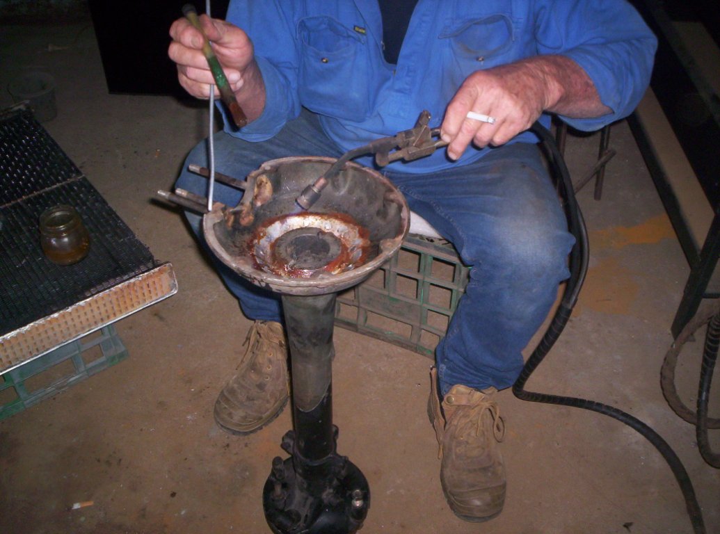

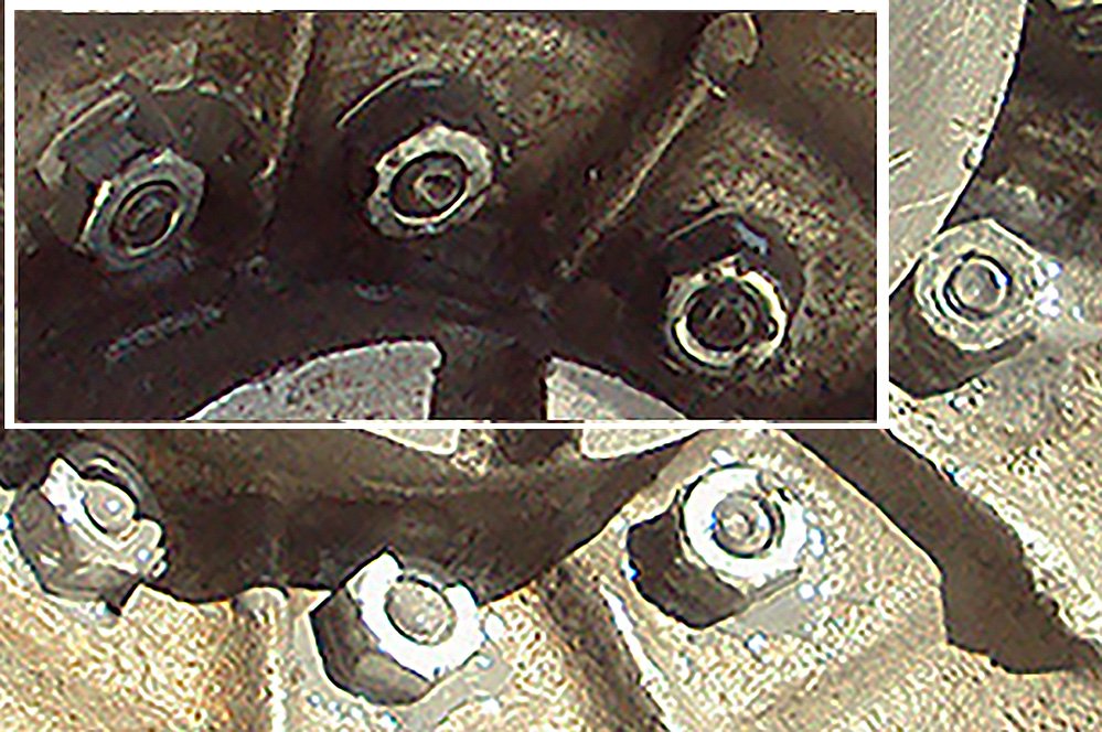

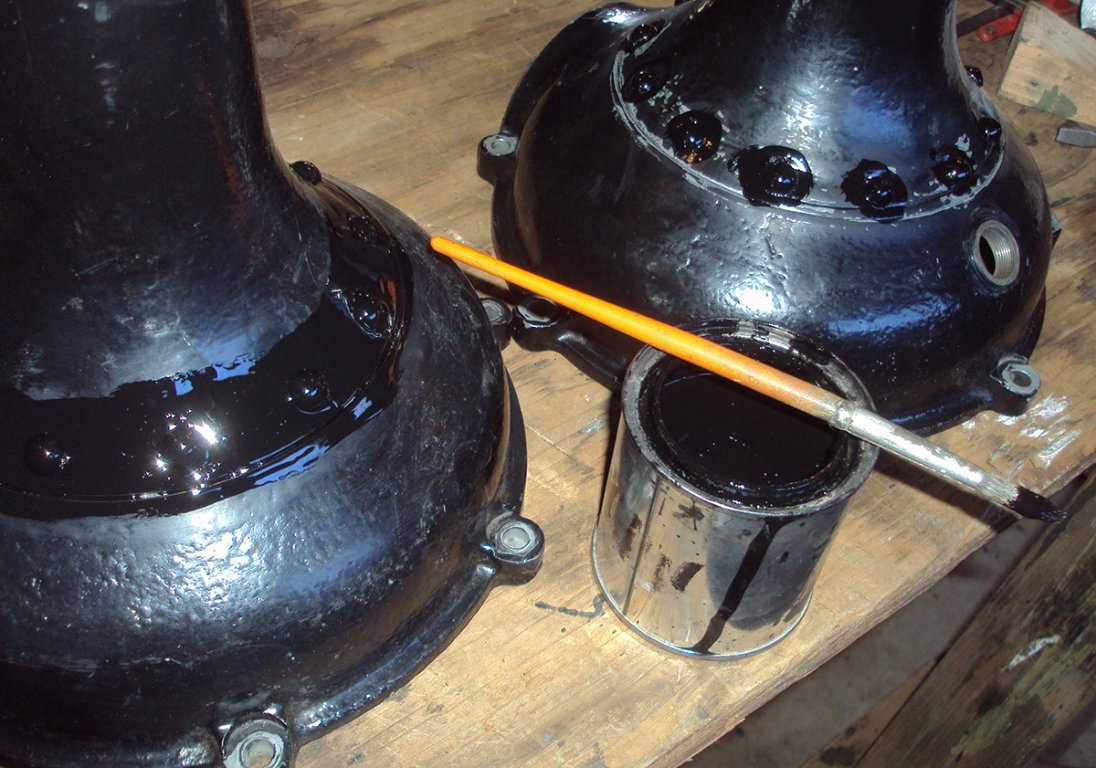

Brazing might be the best solution, but I used JB Weld and made screws with rivet heads to joint it. I painted it liberally to add to the sealing. One has sealed well for 20 years and the other for 8.

Craig, the sealant I used was Loktite 510, not 515 as I remembered. It is non hardening, so will not crack under movement. More is not better. Just apply it to mating surfaces and let it do its work. There is no need for excess of the stuff to hang about. It will do its best work on absolutely dry, non oily surfaces. Otherwise, my method is just like Rich's

Rich, you brought back painful memories when you mentioned brazing as the best method. I disagree 240% with that, 10% for each rivet i had to dig out of a 1912 clamshell diff to get it apart. Then there is another 300% for each side for cleaning up the continuous bronze bead around the outside. Give me a non bronzed one any time.

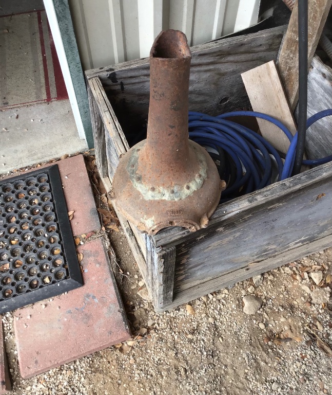

Following this thread was interesting about repairing the 1914 rear end leaks so I thought I would contribute with this one that ended its days as a jack stand! It’s been used around the shop for years. I guess after the original owner had stopped the leaks with brass he found one last use for it! It was a fairly good brazing job I guess.

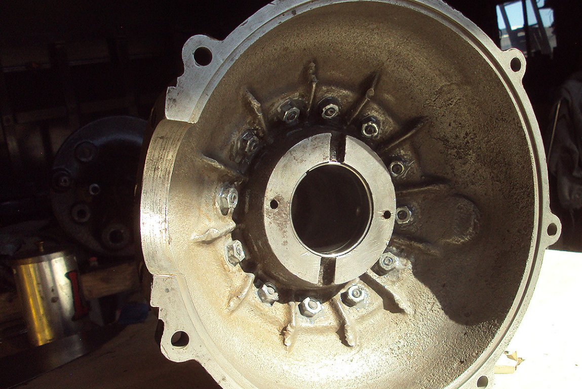

Hi Rich, I like your solution. what did you do with the nuts of the rivet to be sure they will not move or fall down inside the rear ? Thank you SirRich Eagle wrote: ↑Wed Dec 07, 2022 3:08 pmBrazing might be the best solution, but I used JB Weld and made screws with rivet heads to joint it. I painted it liberally to add to the sealing. One has sealed well for 20 years and the other for 8.

I seriously staked and peened the nuts. It is a good question.
