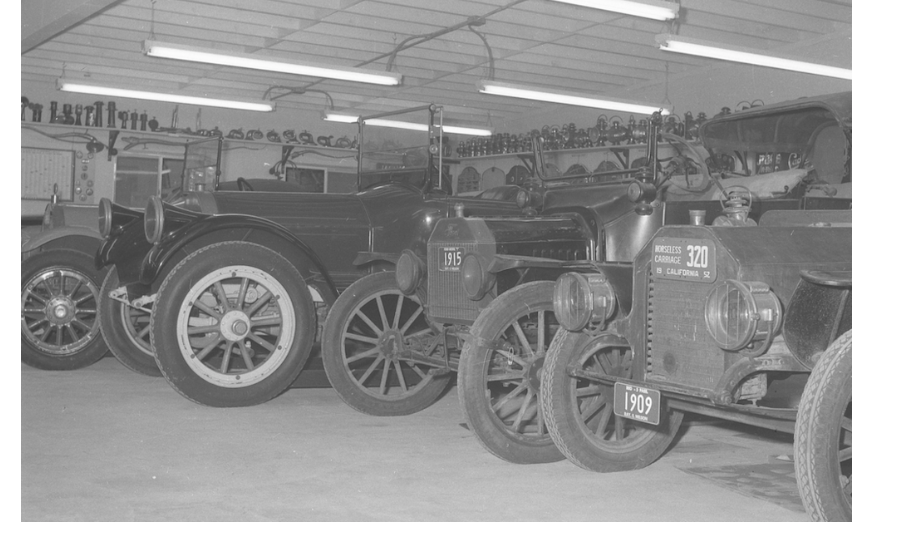

Forgive my ignorance, but I was wondering where do you get tires for the rare vehicles, with odd sized rims. Are they custom made somewhere, or does one or two companies manufacture them somewhere and sell them?
I do not have a vehicle myself, nor does anyone in the family that needs special tires or anything, I was just wondering... :)
I know that you can buy Model T tires from multiple sources, but what about all the odd sized tires for other models?
As you can see here in this photo, there are numerous different sizes and shapes.
