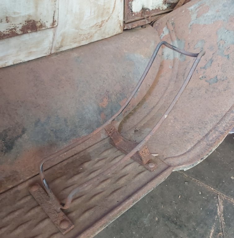

Henrietta's spare was loose on the tray when I found her. Image this running board carrier, based on a blacksmith made unit on my 1912 chocolate van. Both utilise existing bolts so that no holes were drilled to fit them.
I set the cradle for this one to the front, as the second strap is at 9 o'clock on the front of the tray. There is a leather strap around the tyre and cradle at the front end.
