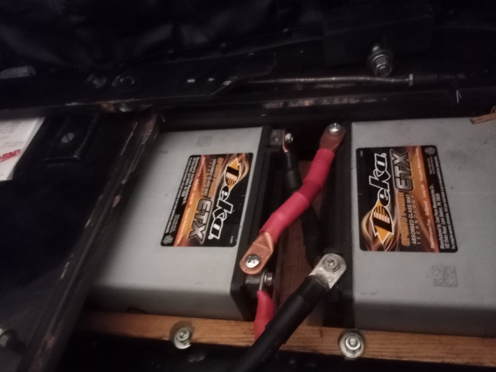

Post by TWrenn » Fri Jan 06, 2023 10:24 am
FWIW here's the battery arrangement in my '11 Torpedo. And yeh there isn't crap for room to store anything under the seat! Thankfully mine came with a real nice wood tool box behind the gas tank.
