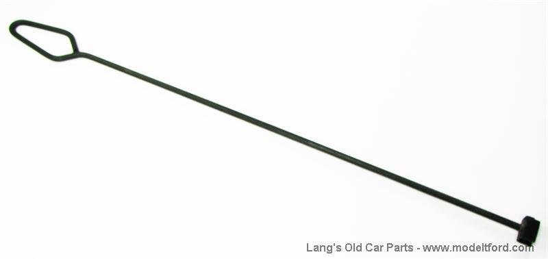

I scored an older version of the dipstick Lang's carries. No hole in the splash apron. http://www.modeltford.com/item/3079DS.aspx

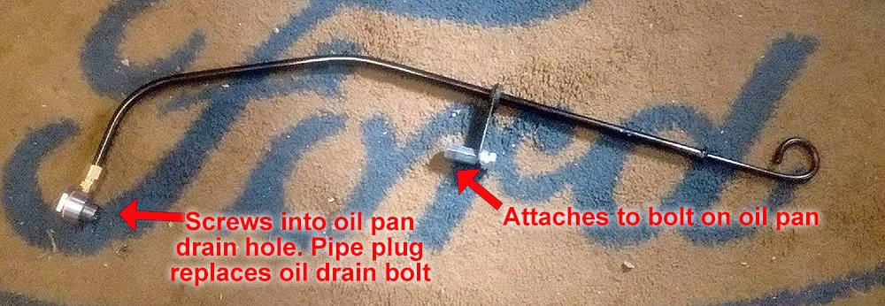

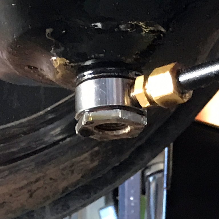

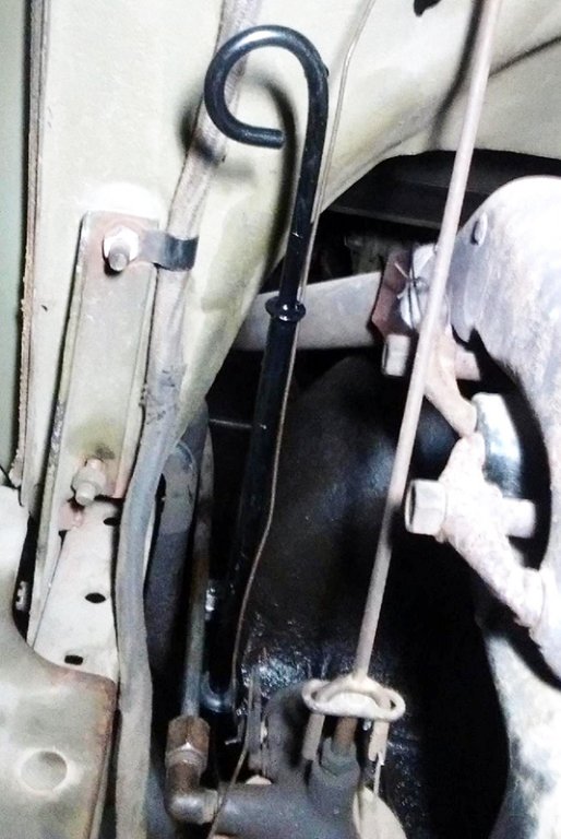

I prefer an actual dipstick. I purchased an "Advantage Dipstick" from the folks at Antique Auto Ranch in Spokane that replaces the oil pan drain plug with a fitting that allows you to read oil level down to zero....popular with the Montana 500 crowd. No new holes required. After seeing mine, several guys in my club bought them as well.
AAR is scaling back and are only open the first Tuesday of the month, which makes it difficult to contact them if you're in a hurry. 509-535-7789

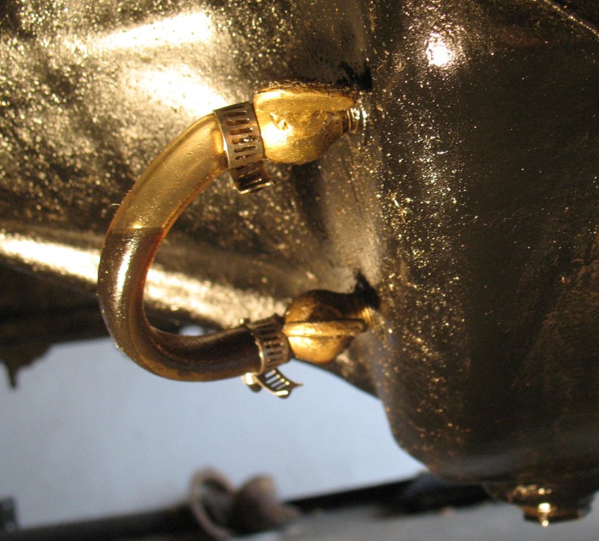

I avoid crawling under by using my homemade version of this T era accessory.
My oil sight gauge is a short bit of plastic tubing. If the level goes below half full I add a quart.
