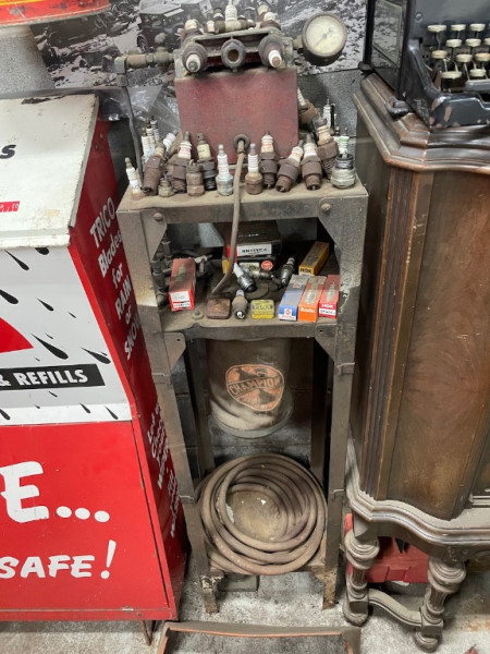

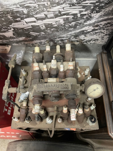

- Posts: 8675
Re: How do you clean Champion X plugs?
Nice radio. What brand is it?
