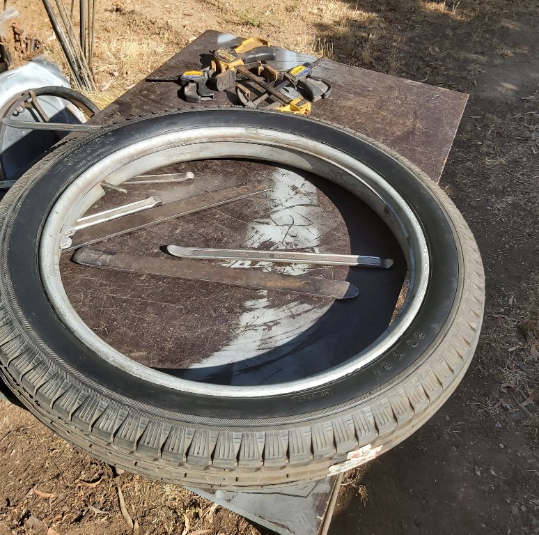

When the Olympic Tyre and Rubber Company decided to cease production of their legendary beaded edge tyres in the early 1970's, they advised old car enthusiasts so they could lay in some supplies for later. I traded som labour for this set of beauties.
Normally, I stretch old tyres by fitting them over flat 13" car tyres and then inflating them to stretch the BE tyre. I have 3 of the others fitted over 3 different sized wheel/tyre combinations to stretch them in stages. This one has gone a different route, which has been a game changer.
Here it is, easily fitted over a collapsed 23" Chev split rim, and then expanded even bigger than 23", there being a 1/2" gap in the rim ends. Today's temperature is expected to be over 100, so I will try fitting it up this afternoon. Wish me luck. Only 4 more to go.
Over time they shrink, having no wire in the beads. My local tyre shop used their machine to roll one side on a rim, but there was no way they could then insert the tube. I picked it up and left it aside for some hot weather. With the temperature in the high 90'S, I levered it off quite easily. The fired bead was almost an inch bigger in diameter than the non fitted side.

Topic author - Posts: 6919
Re: Olympic tyres
Agree almost entirely Ed, except for the muscle bit. Trying to force old tyres onto rims after they have shrunk can lead to broken beads. Don't ask how I know this! This is why I go to lengths to stretch them back to size before trying to fit them
I was fouled by the weather yesterday. The estimated 104 max was only in the 80s, so i will be patient some more and wait till the next hot spell. Heat sure does make a difference to their pliability.
Re: Olympic tyres
Miles, it would be easier for you to come here, but you would have far greater distances to travel if you went touring. Enjoy the cooler days and the Kiwi hospitality.
Re: Olympic tyres
Success! I got the first one mounted today. It was a warm day rather than a hot one, but it was enough to allow me to get the first tyre on a rim. A second one is now on the split rim spreader. I can jack them out until there is a one inch gap at the rim join. That makes it easier when levering them onto rims. Tube goes in the tyre. Rim liner on the rim. Valve stem and both beads clamped in the rim. Both beads levered on at the same time. i Managed it on my own.
4 more to go!
