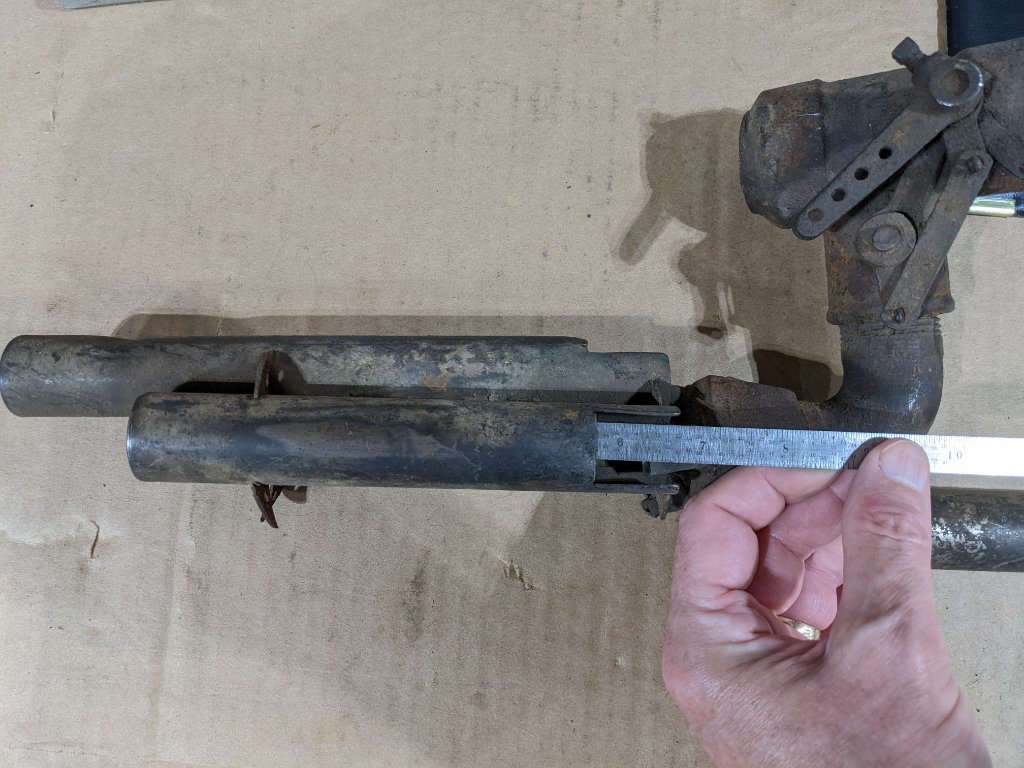

I have a number 2 and the smaller one. Neither is installed yet. I need to make two new tubes for the #2 and repair the remaining two tubes. Below are some dimensions of the tubes. The lengths listed below were measured from the inside of the end cap to the edge of the cut notch. They are not overall lengths (add about 1").
Number 2"
1.134" OD, 1.038" ID
5.58"
7.77"
9.35"
11.18" (I don't have this tube. I created a frequency spreadsheet to calculate it.)
Smaller no-number whistle:
1" OD
.904" ID
3.83"
5.56"
6.77"
8.50"
I don't know yet whether either will work on a Model T. I am currently soaking the exhaust valve on the #2 to free it up. I did test the smaller whistle using an air compressor. A friend of mine heard it 2 miles away.

The aermore shown here is correct for a T. A smaller unit will sound more shrill. A larger unit will sound deeper, more hollow.
