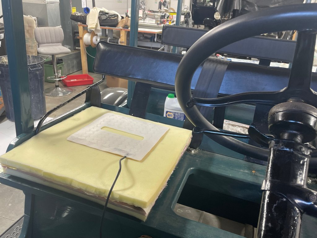

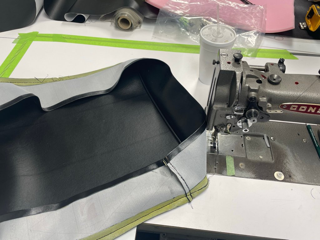

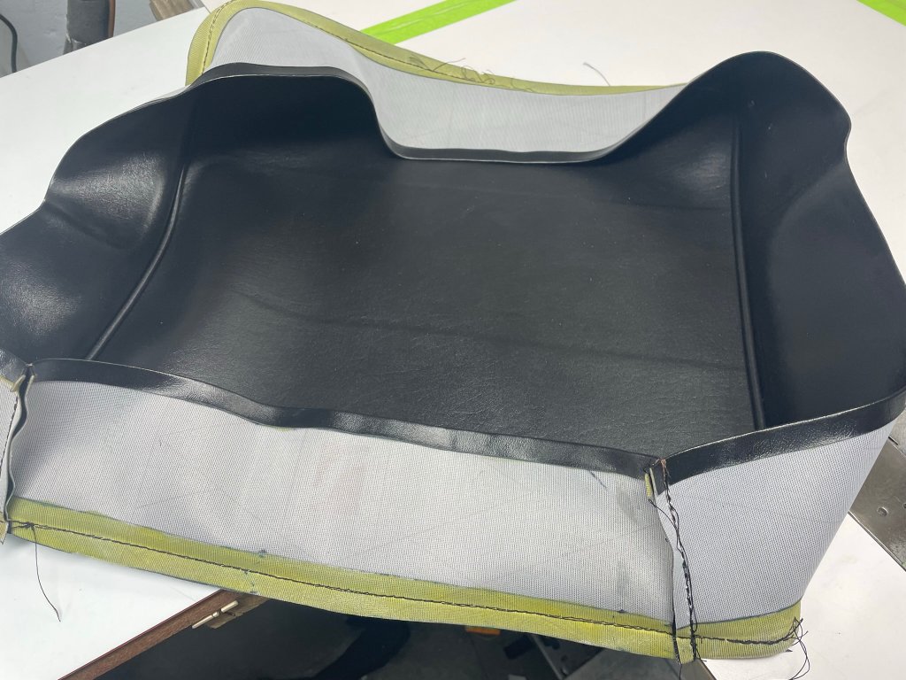

Let me start by admitting I am a 'purist restorer' at heart, but sometimes stepping outside of your normal can make you feel giddy like a little kid. That was me working in the shop today.
The backstory is, last summer when I rebuilt the engine in my Depot Hack in prep for the Hamilton, OH tour, I decided to try one of the new 12v gear reduction starters and a new 12v alternator the vendors were selling. No real need for 12v upgrade (at that time) other than the novelty I had with this type of starter, ...and now the ability to supply high amperage draws of 12 volt power.

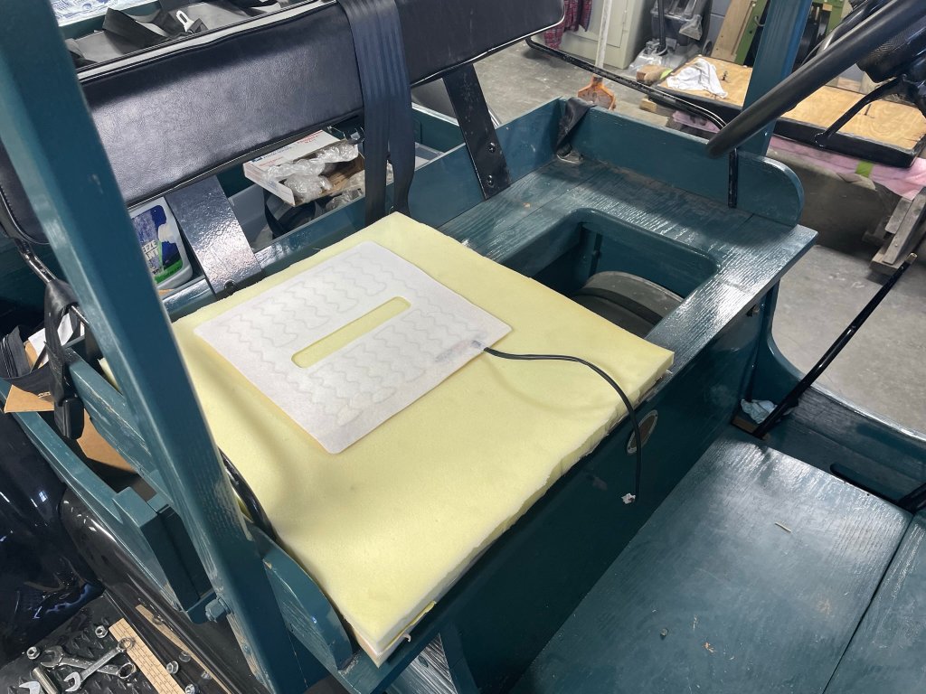

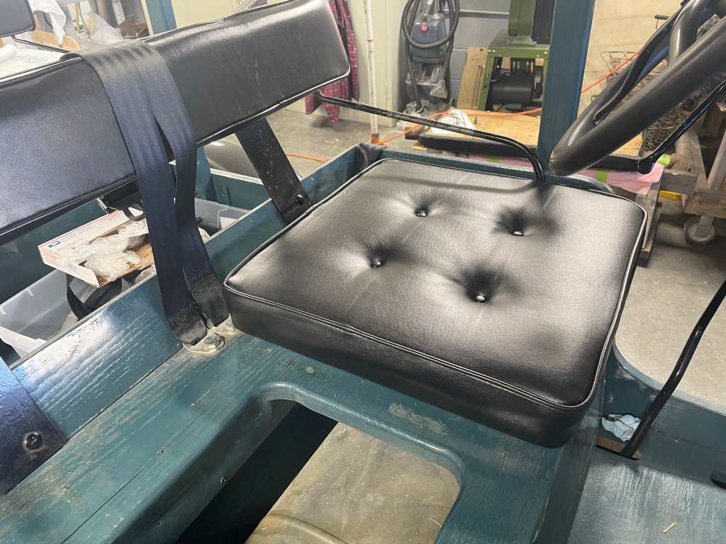

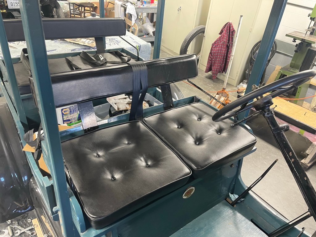

Fast forward to about a week ago when I decided I should probably upgrade the seats in the DH because the foam was getting old. Because of the seat foam's age, after an hour or so of driving the cushions would begin to be uncomfortable enough to make your 'hind-end' numb. SO, an online purchase from Amazon, a quick rummage thru my upholstery material stock, and then a couple hours of labor in the upholstery shop today allows me to have custom split front seat (much easier during gas refueling) with two cushions that I can plug into the wiring harness. Look at the pictures below .....and comment whether you are jealous, -or a hater!! Yeah, I admit it's not a kill switch :roll: , -and yes this is probably considered by most to be sacrilegious. :lol: 8-)

more pix...

An excellent idea for cool season cruising ... but I'd make sure that ALL power was off to the seat heaters or anything else electrical that is anywhere near the gas tank when filling it. Some materials can also generate "static" sparks in dry weather, and I'd be cautious in that regard when filling the tank.

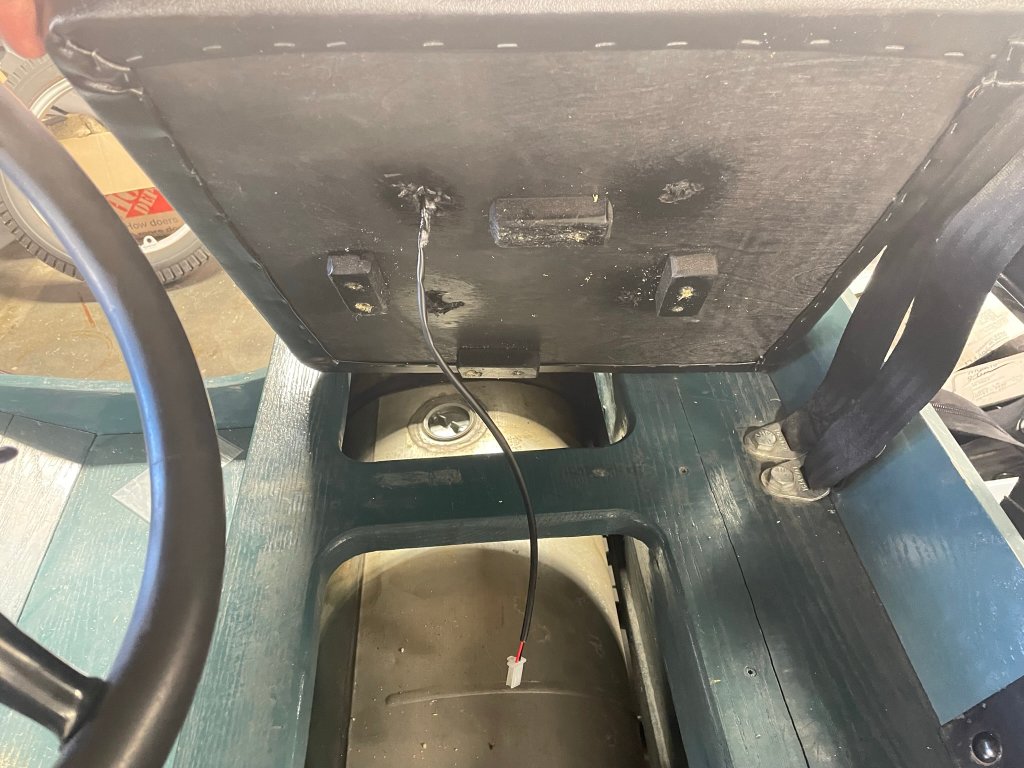

So let me get this straight, we are concerned about the possibility of an electrical spark when refueling ...but not about the hot exhaust pipe located directly under the tank inlet?? Image
Maybe this will give some peace of mind for your concerns. My basic reasoning , -or design of this with the split bench is such that it allows me to only remove the half over the fuel tank inlet and then set the passenger side cushion on top of the driver's side cushion which effectively removes all of the wiring from the area of the gas filling taking place. I would do this only because I am lazy and would not feel like unplugging the connector or removing the entire seat cushion! :lol:
With regard to powering the seats, at present I am running a distributor on this engine however my plans have been to convert it back to coils since I have a good mag ring again. We were pinched for time getting 3 cars ready for Hamilton so it was easiest to just re-install the distributor. The reason I have not converted it back to coils since the Hamilton tour is much akin to the adage about the Cobbler's kid's shoes. ;) Therefore it may, -or may not happen during 2023. :oops:
With the above said, the switches on this Dorman unit only have a Low-Off-Hi setting. There is not any timer or safety shut-off provision in the switch like my modern vehicles do. Therefore I have been debating whether I want to just install a main power relay that would be triggered by the BAT side of the ignition switch, ...Or whether I want to trigger the relay using the Headlight Switch. Using the Headlight Switch to trigger this relay would allow me to use the Ignition Switch on MAG and still have power to the seat warmers, ...however it would not be failsafe if I were to accidently leave the headlights switched to the On position during a stop. Using the Ignition Switch on BAT to trigger the relay would more likely make it failsafe to ensure the elements are off when refueling or parking. If I wired it that way, then I would just use the seat warmers when switched to BAT, and then only use the MAG after I have driven long enough to warm the seats??

Do the heating units have a thermal limiter? If they do, you'd only need an on-off switch, unless you wanted to add low and high settings. I'd want to wire them such that they'd be OFF whenever the vehicle was not running.

An electric spark, whether from a low voltage electrical device or from a static discharge, can be much more effective at igniting gasoline vapor than a hot surface. Exhaust valves run pretty hot, but they do not ignite the fuel mixture, even under compression, under ordinary operating conditions. However, a puny electric spark under the same conditions will ignite the mixture.
