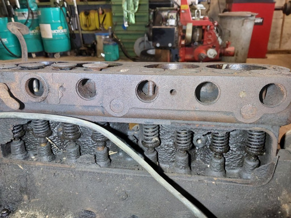

I have a 25 block I bought years ago that has really good babbitt. It has a coat of rust on it and not all rusted and pitted up. It’s been in my shop and out of the weather.
This might be my last engine rebuild and I have some transmissions, parts and etc to do it.
I have some large heavy poly feed tubs I can submerse it in.
So the question is what’s the best soaking solution to use that won’t hurt the babbitt.
I’ve heard of white vinegar, evaporust, and others. So what’s the best that’s fairly cheap and easy to obtain. Thanks Forum!

If the outside of the block is rusty, I think you could tape off the bearing areas, put the block on risers in the pan, and apply a product such as Naval Jelly to the exterior. It is just hydrochloric acid with a thickener, so it would stay on the vertical surfaces of the block. Then, you could powerwash t or scrub down the whole block with hot water and rinse it down really well.
I don't think you should immerse the entire block in acid. Any acid will solubolize yellow metals which it contacts. According to Wikipedia the Ford Babbitt contains 7% copper. Evapo-rust is simply tannic acid with a surfactant package. I have used 4% common white vinegar for hand tools that are really badly rusted, but it takes a long time and would not be suitable for this application.
Otherwise, would it work to remove the rust mechanically? with a 4-1/2 angle grinder equiped with a nylon abrasive cup brush? I think they sell those at harbor freight.
Without a picture, it is hard to understand how rusty this block really is.

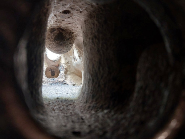

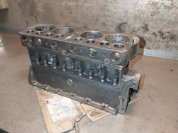

I just cleaned my block of rust. I used many different rotating wire brushes to do this. Took some time and the valve area was complex.
My problem now is the cooling water channels. Limescale has built up quite thickly (picture) and I still don't have a solution. Does anyone have an idea how to get rid of this?
greetings from Switzerland

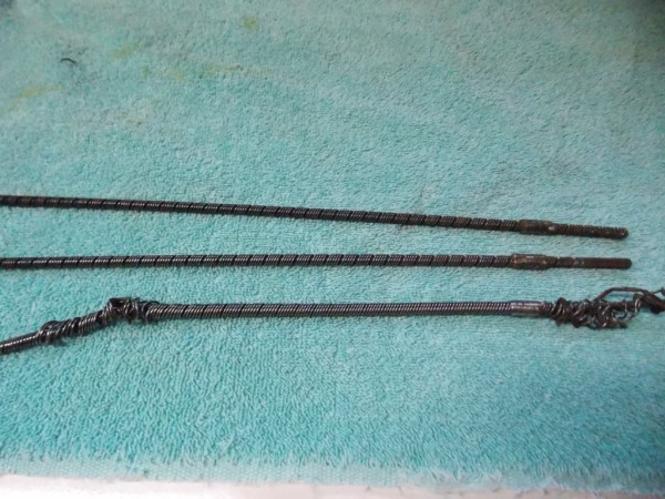

Some have used an old speedometer cable chucked up in a cordless drill. The flexible cable helps in loosening the scale.

Vinegar works fairly good for removing scale without attacking the metal.

Anyone ever try CLR (stands for Calcium, Lime & Rust). Jim Patrick

Hi Beat,
Nice job cleaning up that block. I use a Zep product ( calcium rust & lime remover ) very much like CLR but cheaper & better. I don't
know if they are available where you live. I set the block up in a cement mixing tub, make sure its level, put the water outlet on upside
down with apiece of hose on it and fill it up to almost the top. Try not to get it on the Babbitt. And let it set. then drain it ( you can use
it over again ) then flush well with clean water. A pressure washer helps if you have one. if not satisfied repeat. you can do the same
with the head but its harder to get level. There are stronger solutions but have found this to work good. The speedo cable idea will help.
I once used it on a skinny block Chevy to clean out the EGR port while on the engine. Speedo cable is not very easy to find now days if

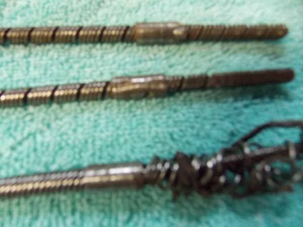

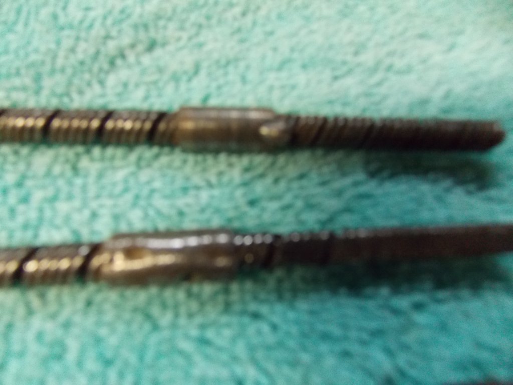

Look for an old junk weed wacker and get the cable out from it. I got three pieces out of one cable cut them with a grinding wheel or a Dremel type tool, I put a piece of tubing about 1/4'' inch long over the cable about 2 inches back from the tip and staked it in place then I splayed out the end of the cable. When chucked in a drill this makes an excellent rotary wire brush. Jim

Great idea that should be easy to come up with. And much more ridged.
Craig.

I was wrong about staking the tube piece I actually put a little weld to it. Here are some pics. The one is quite well used. the ones that aren't splayed are good for getting into the smaller openings on the head and block. Jim

Hi
Thank you for all the good advice.
I've tried different wire ropes. But the lime is very hard and I don't stand a chance with that alone. Motor has stood still for about 70 years).
As an experiment, I also placed some chunks of lime in phosphoric acid. Lime was completely dissolved. But I see that would damage the casting. So it's out of the question.
I see I can't buy CLR from us. It doesn't look any better with Zep products.
I'm currently trying my wife's vinegar cleaner (apple cider vinegar). Put in some chunks of lime from the engine. Let's see how it looks until tomorrow.

If anyone is still interested in this topic I just spent a week testing a product from WD40 on a boat anchor I am converting back into a transmission for the 27 engine that no one wants to buy.
Here's the link to the video:
https://youtu.be/ikyCtX1-lw4

I use an ultrasonic parts cleaner, then medium glass bead. If you don’t have an ultrasonic cleaner, the plain old parts washer works good too. Just a little more work.
