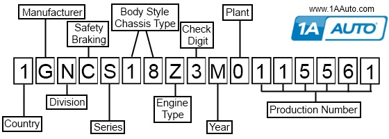

Current Titles & registrations form have a VIN number field to uniquely Identify a specific vehicle globally
The VIN is a unique 17 position alphanumeric (letters & numbers) code for every on & off road vehicle. There are Global Standards to allow each manufacture to assign unique VIN numbers. When this occurred the filing system changed to just go by the number to get the details.
Unless you have a reference manual by manufacturer it is unlikely that you could decipher the VIN. The last six positions are used to uniquely id the similar combinations of values in the other portion of the VIN and is called a "production number". Not engine, body or frame number
VIVN Format.png (62.33 KiB) Viewed 4831 times
Back in the day each car manufacture assigned numbers to the vehicles to disguised each of their vehicles. When these cars were registered within a State it is likely they were filed by Manufacture and then by assigned number within that manufacturer. (There wasn't any national or global database to track stolen vehicles. The corresponding document then contained the detail about the vehicle and owner. So there wasn't and issue if a Ford & Dodge had the same assigned number because they were filed under the Manufactures name.
