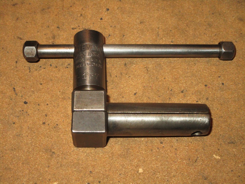

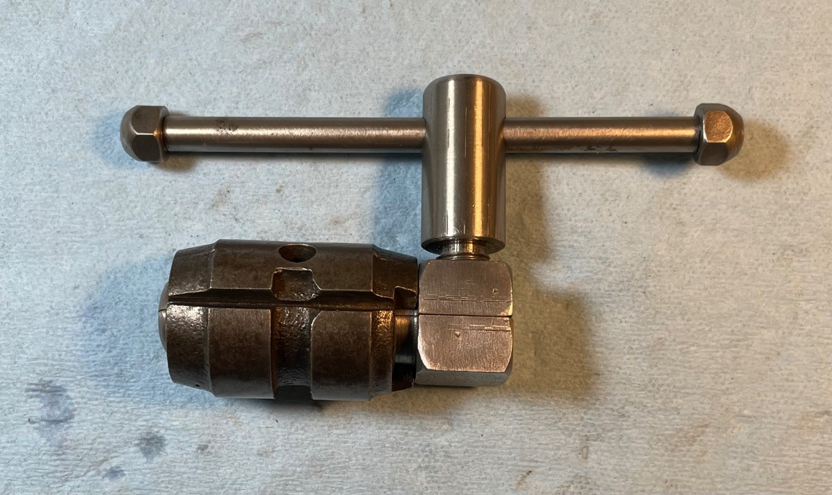

unusual "Stevens" tool, guess what it is, specifications added to post
Post by dobro1956 » Tue Feb 14, 2023 7:35 pm

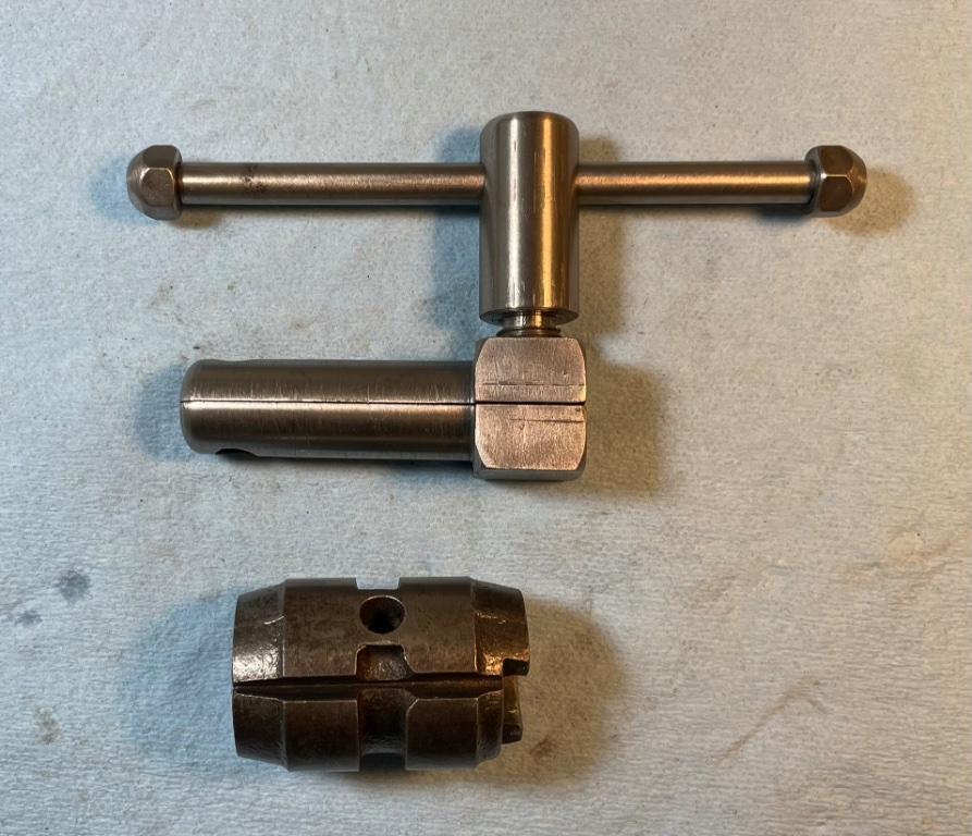

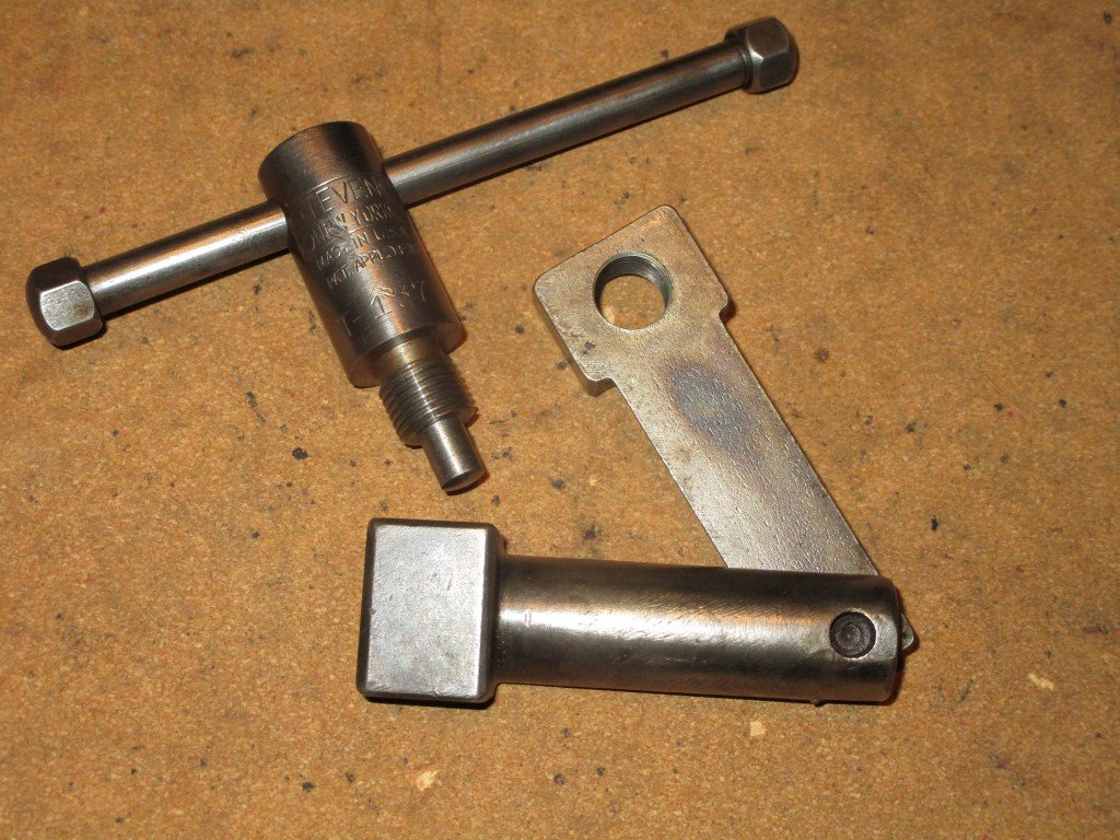

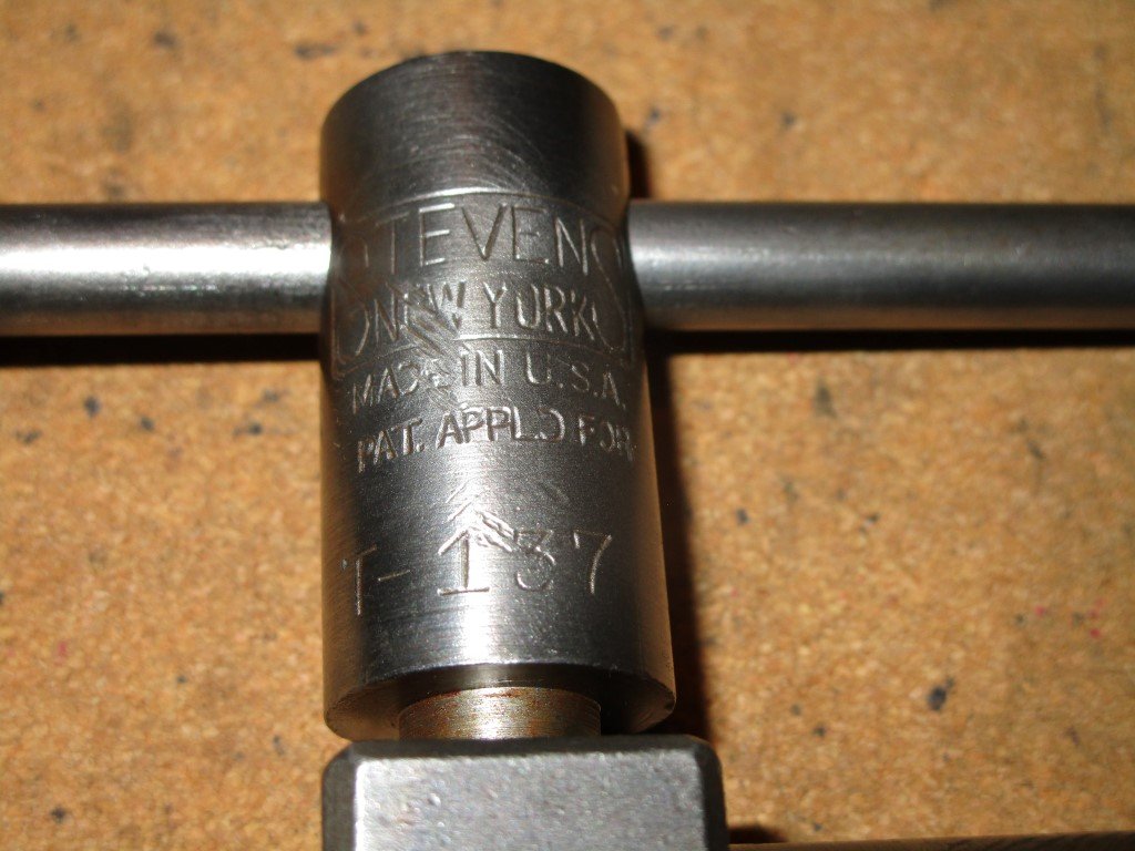

I just acquired another Stevens tool for the collection. It was on E-Bay and I did not know for sure what it was. I just knew it had the early Stevens logo and I did not have it. Someone else wanted it as I had to give more than I really wanted to. I had a suspicion what it was used for, but after it was delivered, and I could see it better than the auction photos showed, then I knew what it was for. Ill just post 3 pics of the tool to see if anyone can figure it out. Then I'll post a couple pics of it in use. I have four different Stevens catalogs and it was not listed in them. It is part no. T-137
For size comparison the sliding handle is 5 inches long

Re: unusual "Stevens" tool, guess what it is
Post by Scott_Conger » Tue Feb 14, 2023 8:04 pm
purely WAG: pipe expansion/flare tool
whatever it is, if you have it, I want it :lol:
Post by Pep C Strebeck » Tue Feb 14, 2023 8:13 pm
Frame riveting dolly.
Post by dobro1956 » Tue Feb 14, 2023 8:32 pm
Scott and Pep. Not it.... It is similar to the frame rivet dolly but not big enough or strong enough for riveting. The e-bay auction called it a pipe flair tool. It has nothing to do with pipe. I will give a clue. It is not really a useable tool for us today with the product that is being currently sold. . There was a thread awhile back about what it was used on. I also forgot to mention that the sliding handle is 5 inches long for size comparison.
Post by Dan Hatch » Tue Feb 14, 2023 8:51 pm
To split cam bearings.
Post by dobro1956 » Tue Feb 14, 2023 9:01 pm

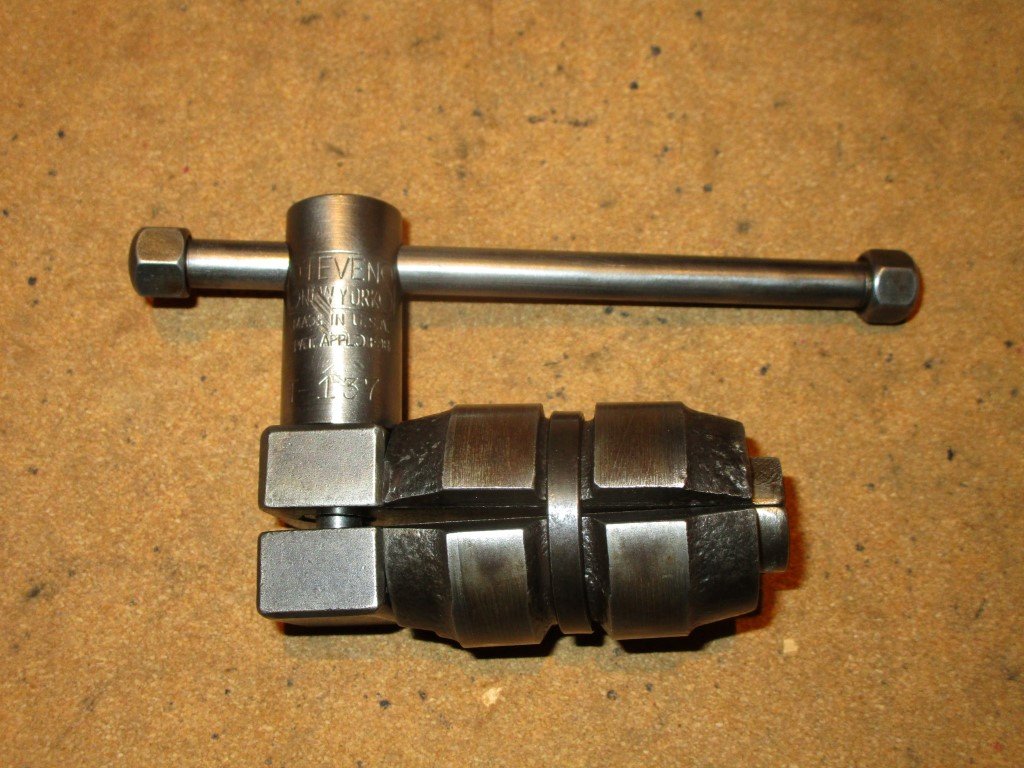

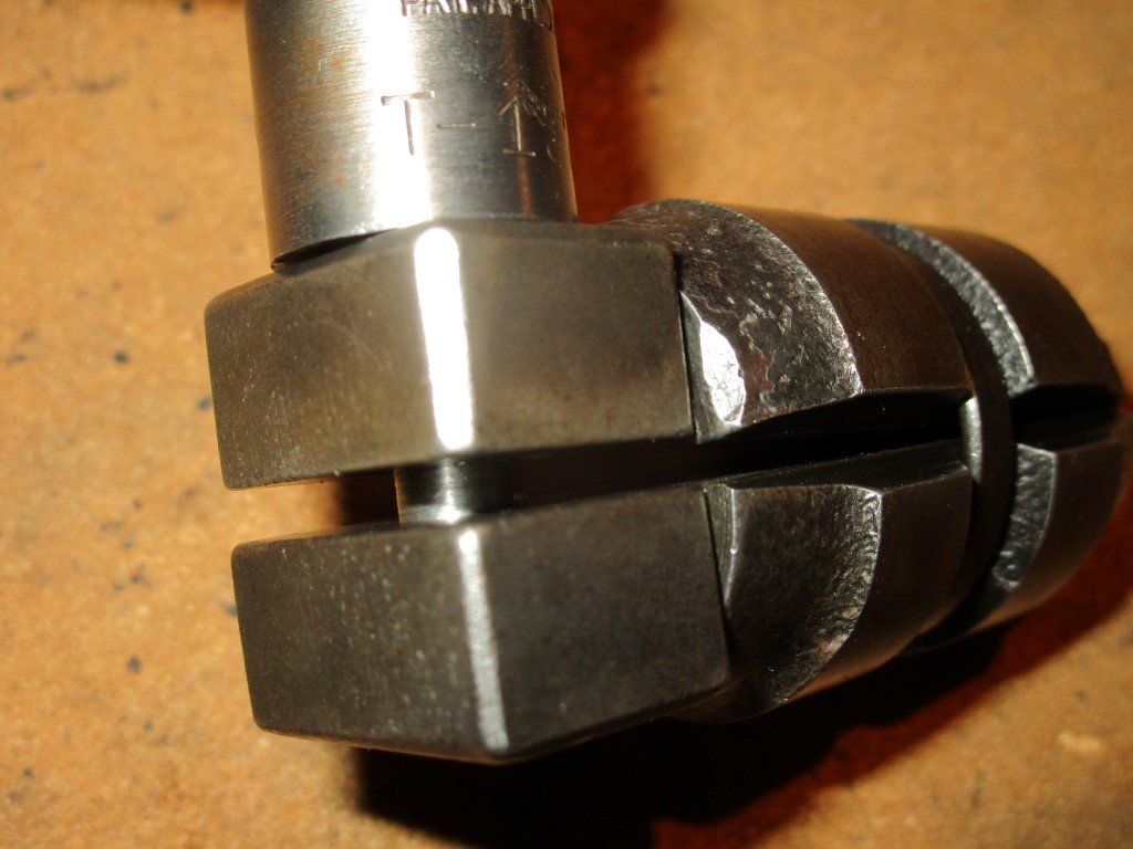

Dan, You are correct. It is a cam bearing splitting tool. Not very useable today, as the bearings are pre-split for us. But, I did not have it, and what is a "Stevens tool junkie" to do when it showed up for sale and I did not have one. So, I just blindly bid till the other guy gave up.

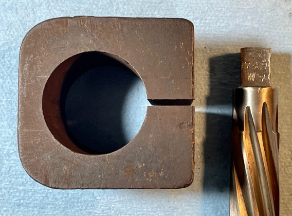

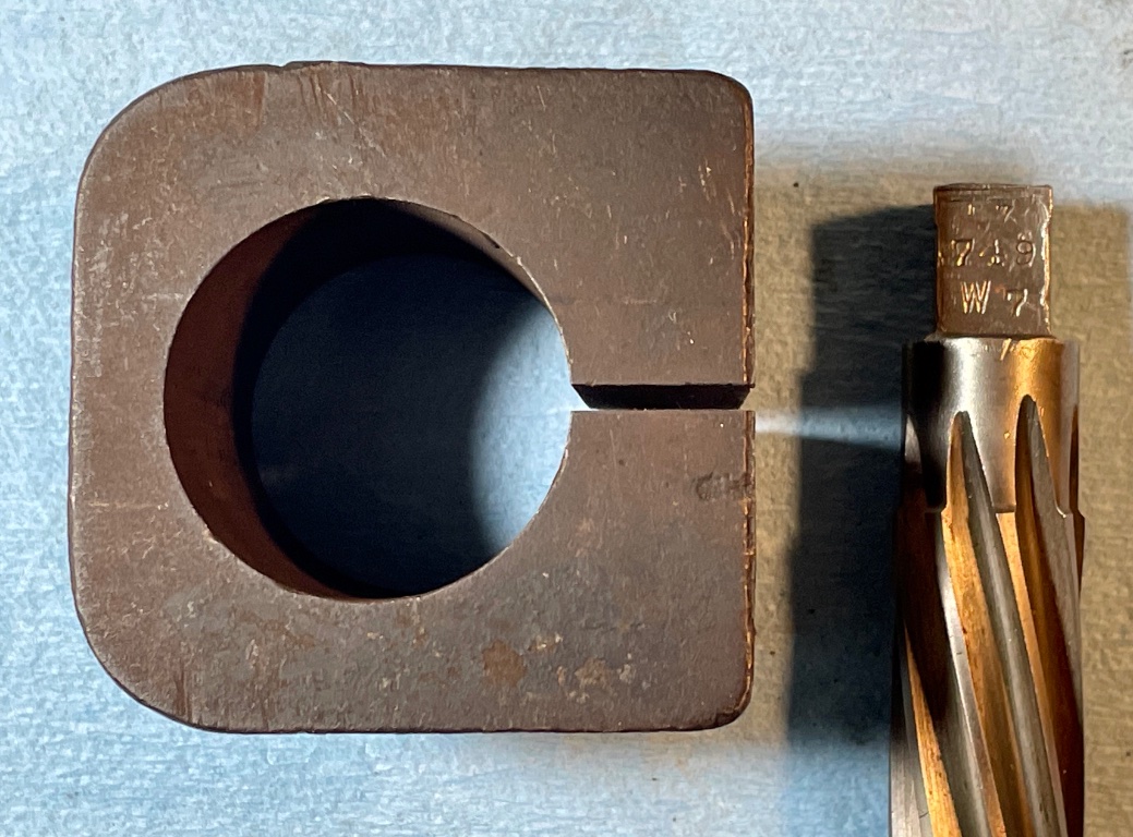

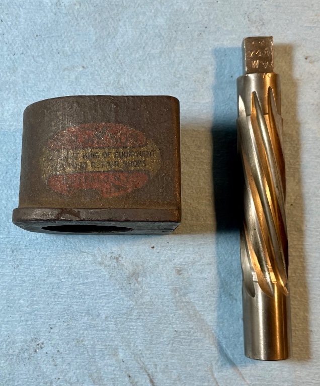

KR Wilson also advocated reaming new camshaft bearings and sold a special holding fixture and reamer for doing this. The reamers are usually marked W7.

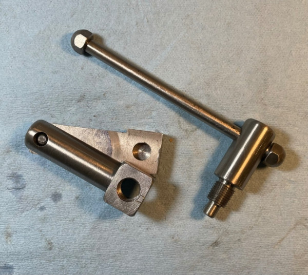

Based on the pictures I built one. Took about 3 hours. Have not gone fancy to duplicate the T screw & engrave to match.(yet?) I used a 7/16 nf bolt for function screw.
My first thought was to take a chunk of axle shaft & split it in half. Getting a good, even split would be tough with a hacksaw, so I was pleased to find a chunk of 1"x1/2" cold roll in my scrap pile. 2 pieces cut 3 1/4" long. The key was to wire weld the 2 pieces together on each end on the butt line.
Set up in a 4 jaw chuck & center drilled one end. Piece was pulled out to hold 1/2" in the chuck & supported on a ball bearing center.
Turned the body (inside cam area) to .745"
Drilled 3/16 " hole for the pivot rivet & countersunk both sides. Made a double end tubular rivet.
Drilled the hole for a 7/16-20 thread in one head half.
Milled the 2 ends to square & release the weld hold.
Threaded the top half.
Counter-bored the lower half 7/16, 1/4 " deep. Keeps the 2 pieces aligned the way the original tool intends.
De-burred everything.
Wallah, functional bearing splitter.

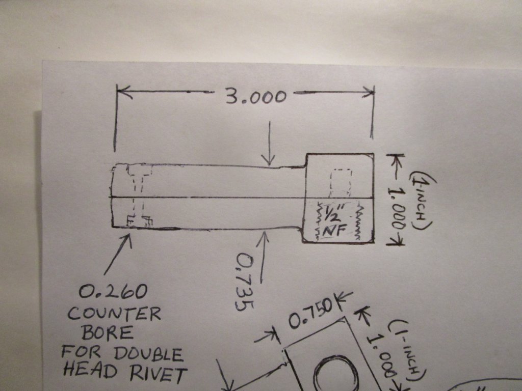

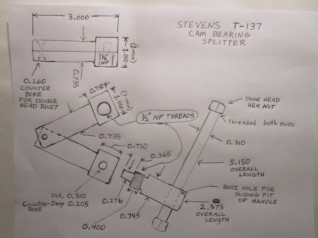

John. Sounds like you did a good job. I also figured welding two square or rectangle pieces together would be the easiest way to fab it. Sorry about taking so long to get the specs done. I have the drawing done and most of the measurements on it. But it seems like everything on the farm needed fixed this week. I should have the specs. done in the next day or so, and I'll post them then. I have not forgot about it.

Post by dobro1956 » Tue Feb 21, 2023 8:36 pm

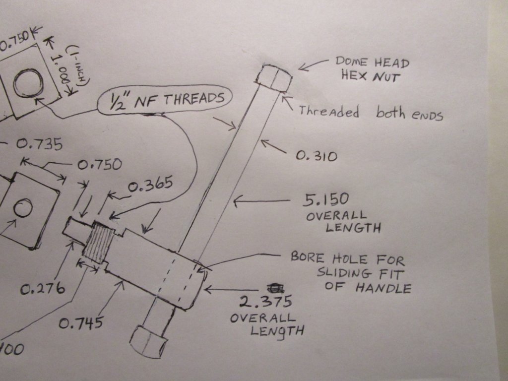

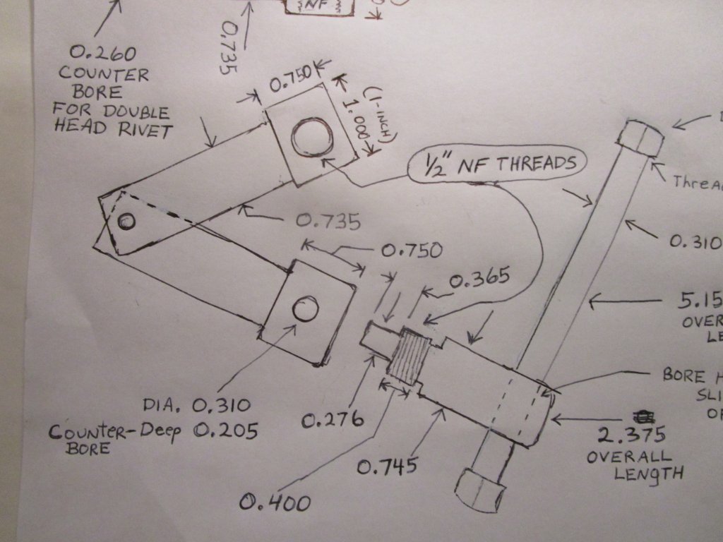

Here are the specs for the cam bearing splitter. I had to use my camera because my scanner was hit by lightening :( The first pic shows up pretty good, but I made three close ups just in case it was hard for someone to read the first photo. The double head rivet is a loose sloppy fit so the 2 halves of the tool can spread open on the square end aprox 0.090 as the bearing is split. I did not want to take the rivet out, so I could not measure the rivet shank hole for size, so fit it to whatever rivet or bolt you are using.
Posts: 5581
Post by RajoRacer » Tue Feb 21, 2023 8:51 pm
Thanks Donnie !!! Were you an engineer in a previous life ?

Mr. Brown,
Thank you for posting the photos and drawings of the Stevens T-138 camshaft bearing splitter. Based on what you posted I made one for myself.
Whew, that was a lot of work!
Respectfully Submitted,
Trent Boggess

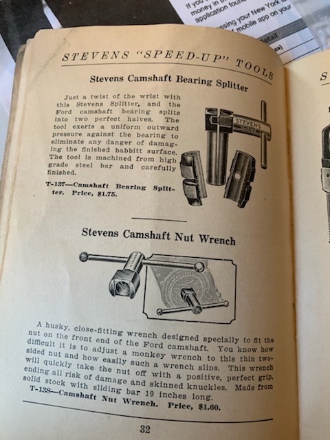

Post by Dan Hatch » Mon Mar 06, 2023 8:09 am
Just thought I would share this.
Saw one of my Stevens catalogs this morning and thought I would check it. SOB, there it is! It is not in any others I have.
I did not see this before I posted what it is.
dobro1956
Posts: 1433
First Name: Donnie
Last Name: Brown
Location: Hills of Arkansas
Re: unusual "Stevens" tool, guess what it is, specifications added to post
Post by dobro1956 » Mon Mar 06, 2023 9:03 am
Dan, can you post a picture of the cover of that catalog. I did not see it in any of my catalogs. I'll have to look again. What page is it on. Thanks for posting ..
Posts: 5526
Last Name: Hatch
Location: Alabama
Post by Dan Hatch » Mon Mar 06, 2023 10:01 am
Here it is
