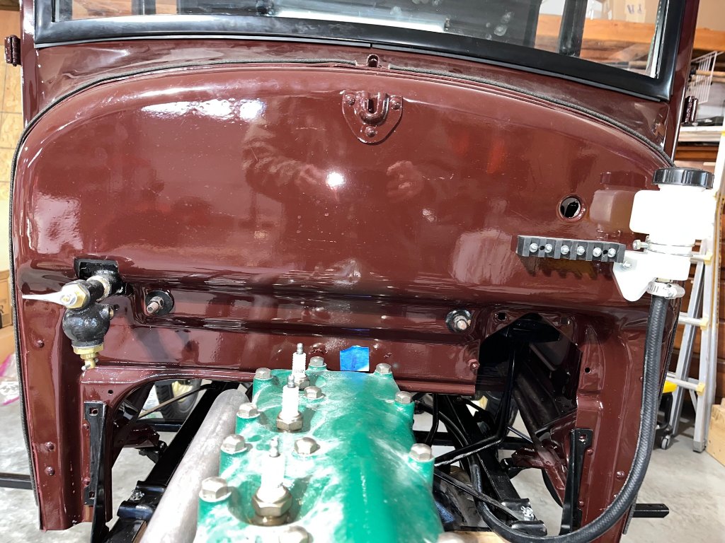

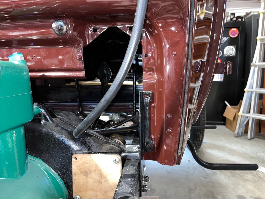

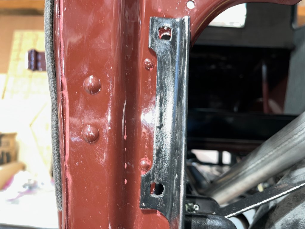

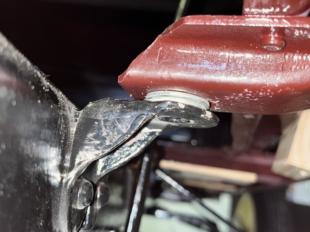

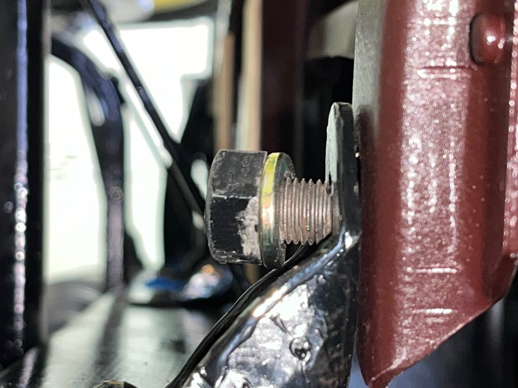

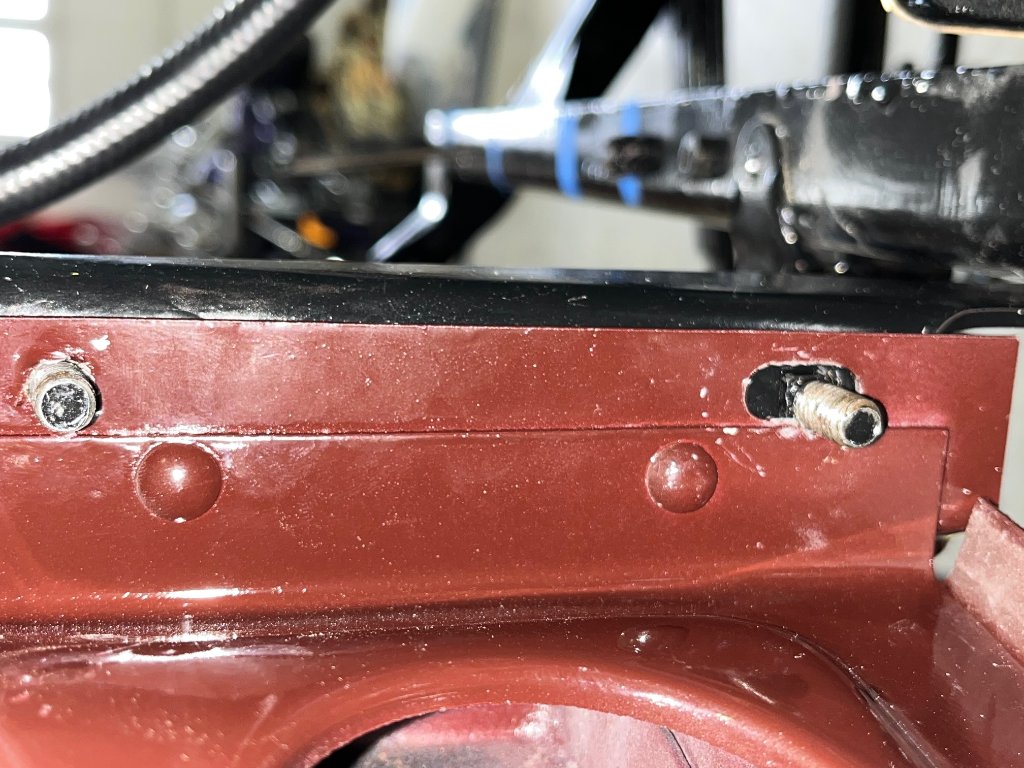

I am in the process of installing the front body brackets to the frame. As shown in the attached photos, the top holes in the body to not completely line up with top hole in the bracket. The bottom hole in the the body is slotted so the holes line up.
All of the eight bottom body to frame connections fit very well, including the front two (one on each side). These two do not have wood blocks, so they are metal to metal. They will separate if I raise the body.
I have no idea why those top holes do not line up. I could raise the body and place washers under the front bottom body to frame connections. However, I am leaning toward enlarging the holes because every thing else seems to fit so good.
What are your opinions?

I am guessing that you did not straighten your frame before painting
I would not cut, drill or modify anything as that is only fixing a symptom; I'd look for the problem and remedy it. I am also speculating that you're going to find out what body shims are for before it's all over.
As it sits right now, you may well have a heck of a time getting the body/hood/radiator shell to play together nicely. If that's the case, then you'll figure out exactly what to do to fix things and it won't involve modifying either the brackets or the body.
Also, Pat is correct: some late cars came without the brackets. However, if yours came with them, they came off and should be able to go back on which leads right back to my opening statement.

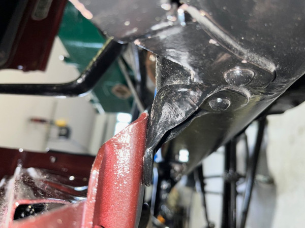

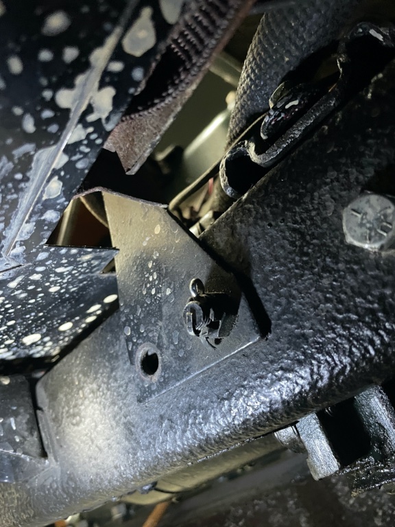

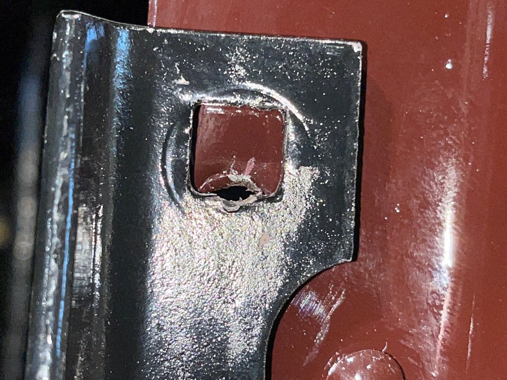

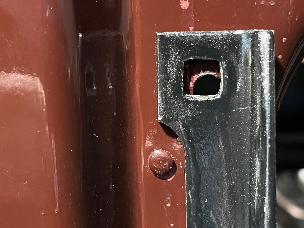

I'm not too convinced that this is caused by a sagged frame. The front body mount brackets are not far back from the firewall. In order for the holes to be that far off, the frame would have to be sagged a fairly large amount in a fairly short distance. I'd look closely at the body mount brackets for any bending or distortion.
Looking at just the one bracket, it appears to be bent upwards. A little harder to see on the other side. I think this may be the cause of your trouble.
- Posts: 6732
Re: Need Opinions
Good Eye, Jerry!
I missed that entirely. Both forward body brackets look significantly bent and am shocked at how puny/lightweight they appear.
For those that know these later cars, is that correct???
Those look like mere tabs sticking out with little heft to them relative to earlier cars. Most certainly modifying the front brackets now will lead to a cracked firewall shortly if that much weight is borne by them. Though I'm not a student of late model T's, I do know that firewall cracking can be a problem.
All of which goes back to my earlier point to solve the PROBLEM, not salve over a symptom

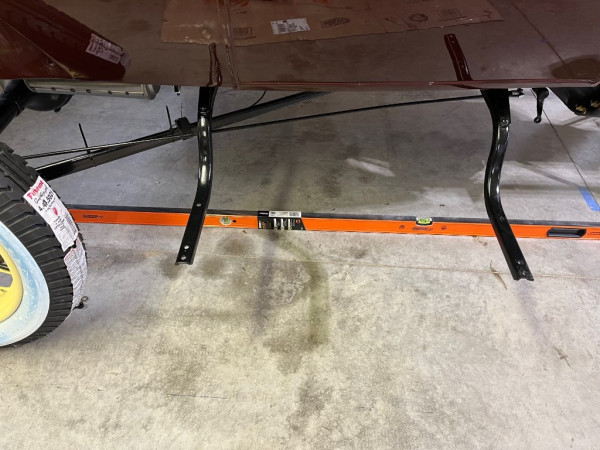

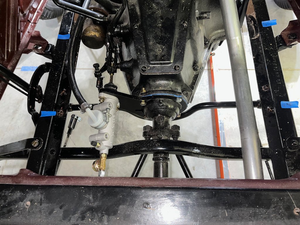

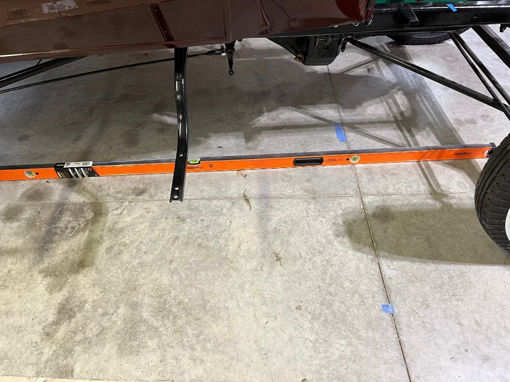

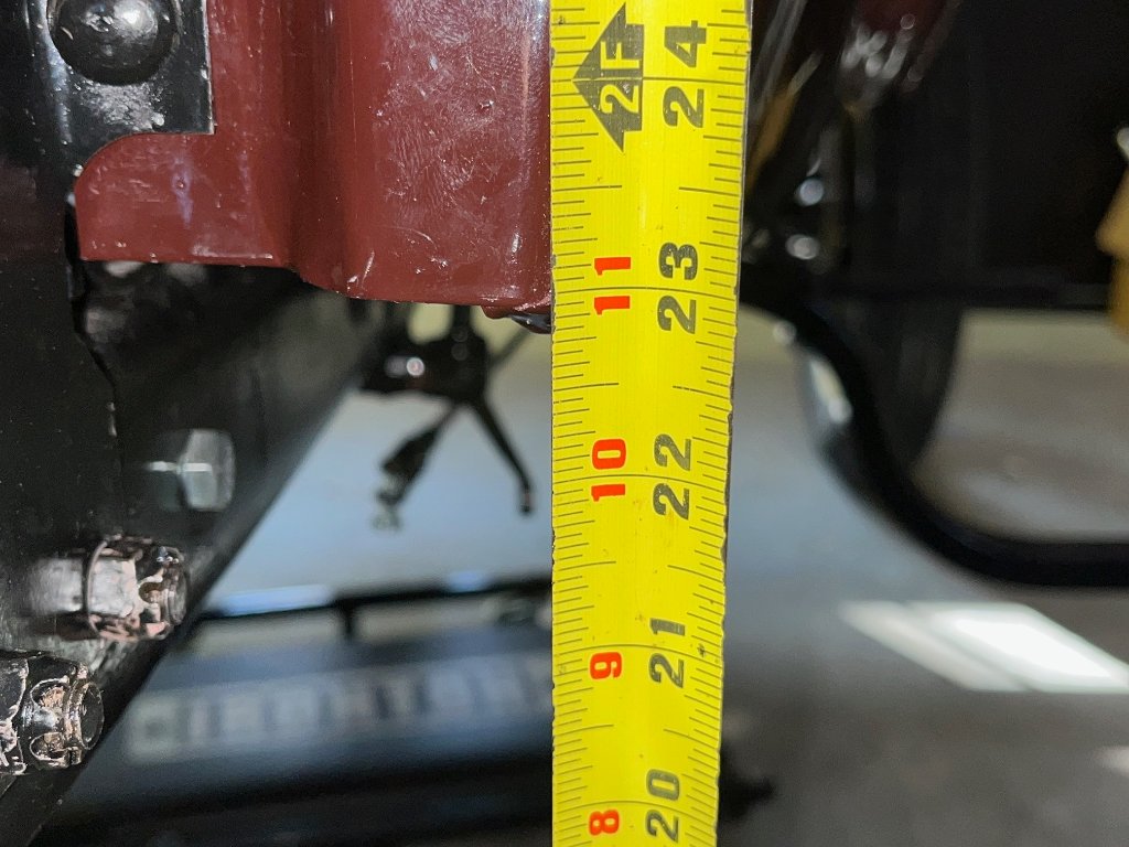

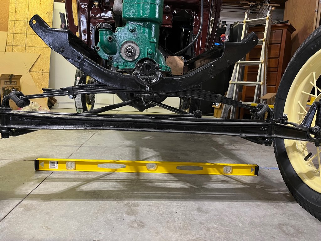

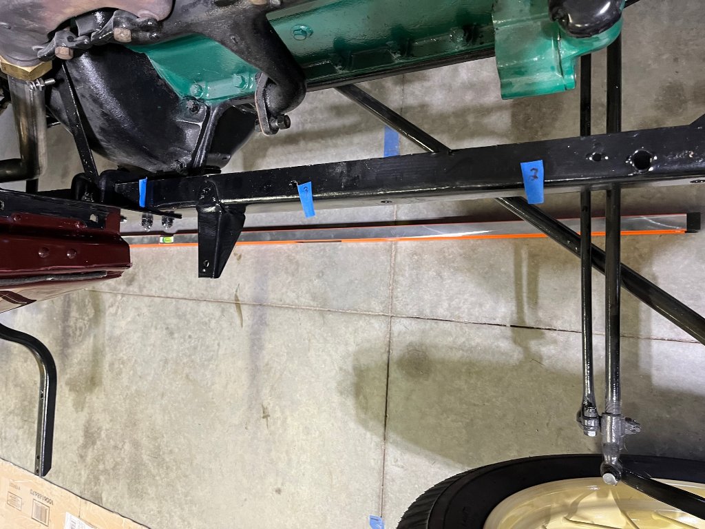

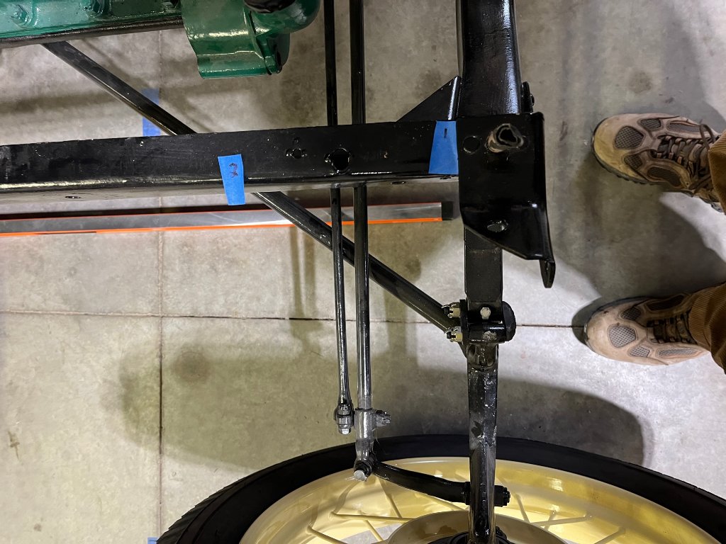

Here is a summary of what I have done and found with the body setting on the frame as shown in my earlier photos (bolts loose).
1) Both doors open and close fine.
2) After the frame was sandblasted, we made the diagonal measurements that were described in Fred Houston's "T" Tips video for the Model T Frame. The frame was square. We did not make measurements to determine if the frame rails were straight; that is, by installing a string line above the rails and measuring down to the rail. I may have "eye ball" along the top of each rail.

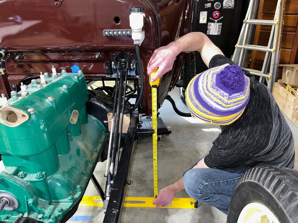

3) I have now made measurements to determine if the rails are straight. We did this by placing a 8' long level on the garage floor and took measurements from it to the top of both rails. The measurements were taken every 9", starting 3" from the front end of the rail. The total number of measurements on each rail was 11. The photos show this procedure.

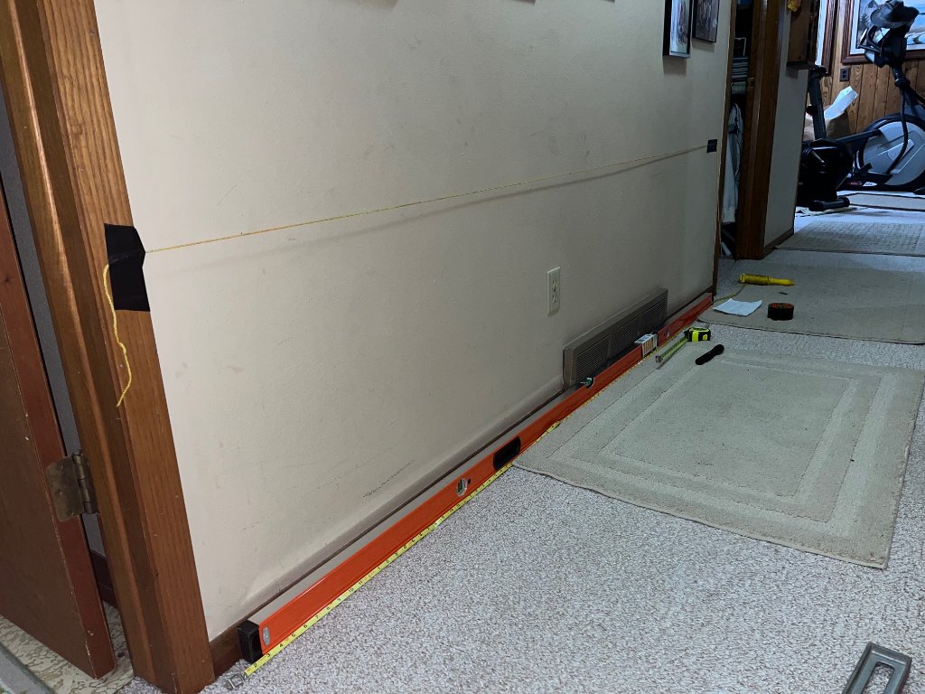

4) I reproduced the measurements on a wall in my house and used a string line to determine if the frame rails are straight. Both of the rails are straight, no sag.

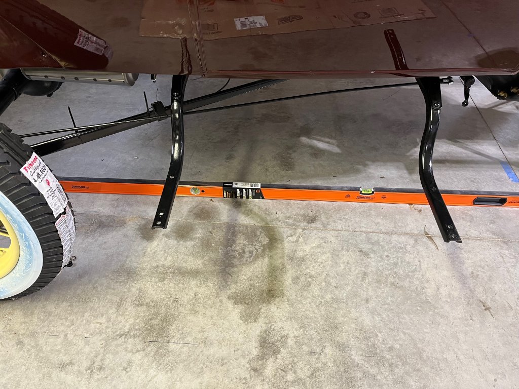

5) I placed a level on the garage floor, perpendicular to the frame, to determine if the rails were level. They are. This procedure will be shown in the next post.
6) I have checked the "fit" between the two front "body" brackets and the "frame" brackets. The one on driver side is tight. The one on the passenger side has a very small gap, maybe 1/32". The brackets are level. Photos of these will be shown in the next posts.
7) I have checked the "fit" between the "body blocks" and the "frame" at each of the two locations on each rail (with the bolts loose). Three are tight and one has a 1/16" gap.
8) Based on the above, I don't know why the holes in the body do not line up with the holes in vertical brackets.
9) Observations, comments and suggestions would be appreciated. After getting that input and input all ready received, I will decide how to proceed.
Note: I will make a couple more posts with photos, as I mentioned above. Therefore, I suggest no comments be made until those posts are made.

Two items are missing from this rebuild, the radiator and hood. Getting everything else sorted without any reference could be problematic. The advice to put everything together and tighten nothing is good advice, but add the radiator and hood to the mix. The radiator should be perpendicular to the frame rails. If it is, and the hood is a mis-fit, the body needs to be juggled to improve the fit. I know this adds to the work, but it may well lessen some heartache later on.

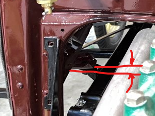

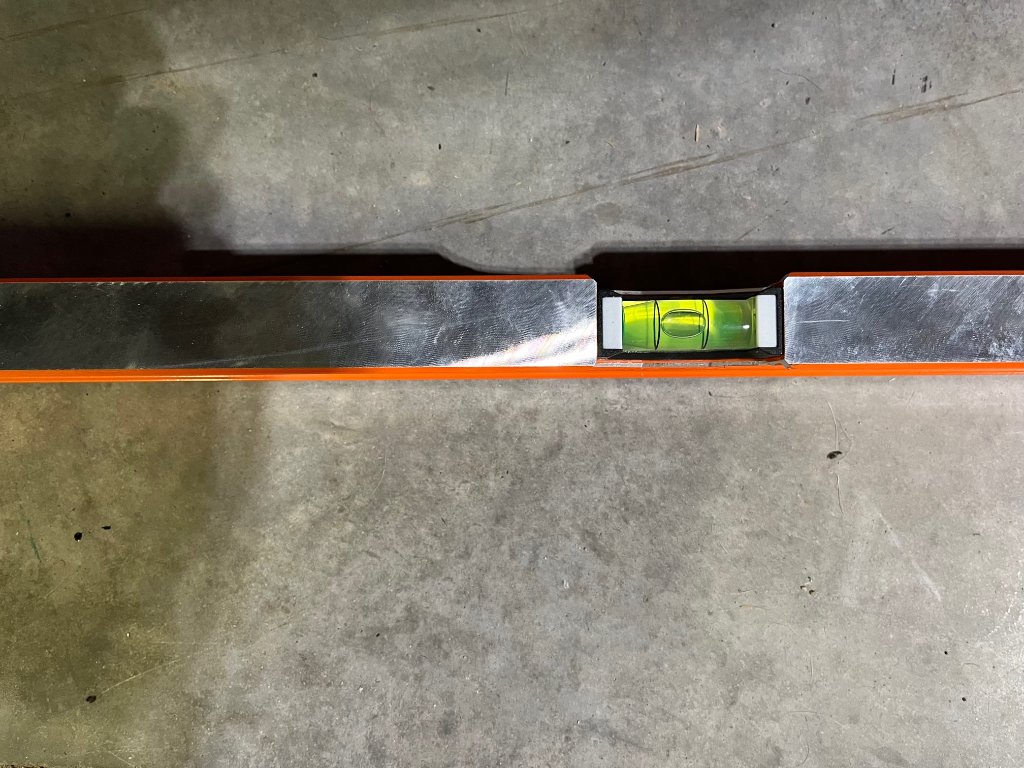

First photo shows how I determined that the frame rails were straight.
Second photo shows the procedure to determine if the rails are level.

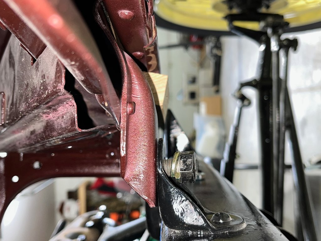

Third and fourth photos show the front "body" and "frame" brackets on the passenger side. The third is looking toward the front. The fourth is looking toward the rear and shows the very small gap.

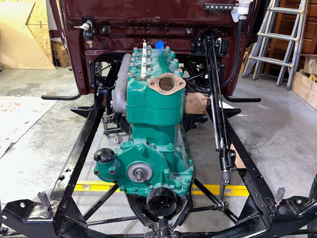

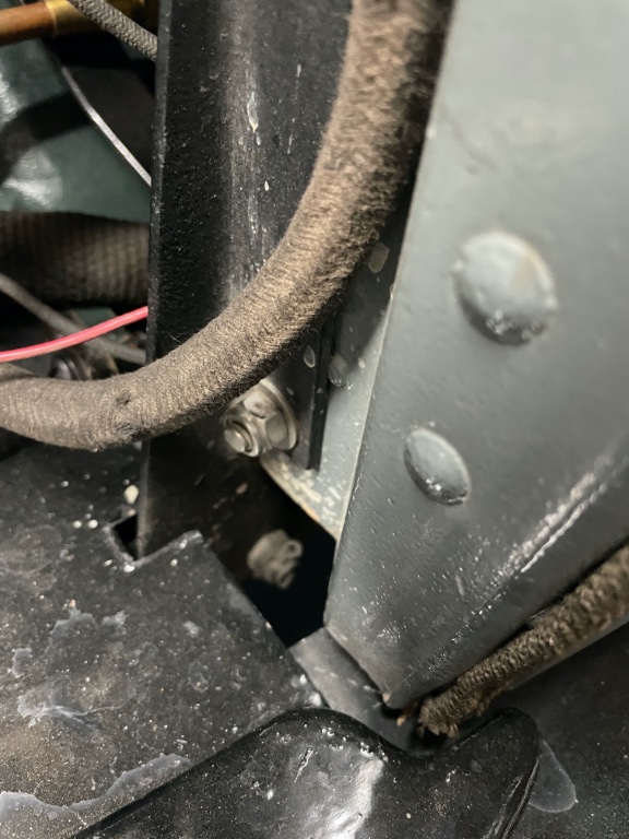

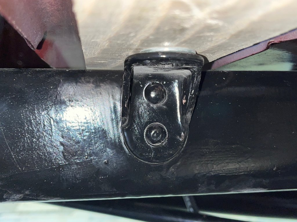

The fifth photo shows the front "body" and "frame" brackets on the driver side, looking toward the front.
Note: Sorry for the bad orientation of three of the photos. The "machine" won't let me to it the right way!

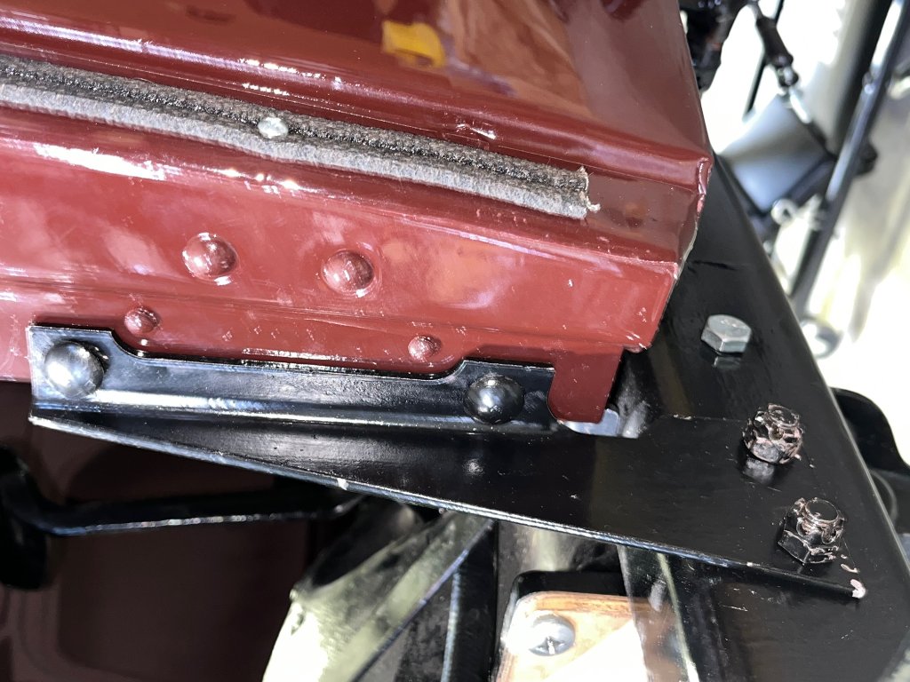

Have you tried removing the brackets from the frame just to see if the bracket holes line up with the firewall holes? Looking at this picture it looks the spacing isn't the same and if that's true then are these original or repro brackets ?.

At this point, I'd be inclined to either shim the body mounts or slot the holes in your firewall brackets, where they attach to the frame rails.

Both the T roadster and the 29 CCPU (very similar cowl to the 27 coupe) I built recently needed persuasion to line up at the cowl. Any bumps, lumps, etc. earned in their past lives seem to show up across the firewall. I started with alignment drifts and longer all thread rod to get each spot settled, and checked out from a distance. Once it was good I put in the carriage bolts through the brackets and frame one at a time clamping where I could…
Seems to me like slotting the square holes in your firewall brackets would just give the body an inappropriate place to shift to. Took me a lot of shimming and experimenting (like, a lot, a lot!) with all of the body mounting bolts to get the pickup door frames right and the cowl to hood and the hood to radiator to line up nice. For me it’s a compromise because of the 32 grill shell, but after a year of driving it’s settled and needs adjusted anyway!
I’d get the radiator and hood in the mix like the others suggested and see where that puts the body. One would think that those frame to cowl brackets would be the jump off, but the cowls sheet metal may tear if you do those first then tweak the body around them. If they are the pieces that came off the car, we can sure see how much the metal body flexes and shifts with use and time. Have you had the doors back in? Could be informative… Chris, in Boulder

Have you tried removing a bracket from the frame to see if it will line up with the firewall holes? That would eliminate any possibility of something else causing the issue. Then if they line up using just the one bolt to the frame as described above
BLB27
Topic author - Posts: 892
- First Name: Bruce
- Last Name: Brakke
- Location: Ames, Iowa
Re: Need Opinions
Frank, I did what you suggested. I removed the bracket. The bolt holes in the bracket line up with the holes in the body.
BLB27
- First Name: Bruce
- Last Name: Brakke
Re: Need Opinions

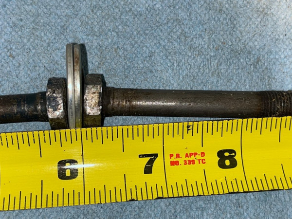

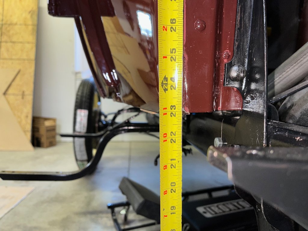

I raised the body enough to get the bolts into the bracket (photos 1 and 2). This has required two washers on the left front frame support bracket (photos 3 and 4), and one washer on the adjacent body block (photo 5). In my next post, I will show how the body is setting now.
BLB27
- First Name: Bruce
- Last Name: Brakke
Re: Need Opinions
I have placed a level on the garage floor and measured from it to the bottom edge of the body on both sides. The body is now level as shown in the photos.
- Posts: 7174
Re: Need Opinions
Bruce, once you get the body on, shimmed up with washers and bolted to the firewall brackets, what will you do to get a good hood fit? The only way that can be adjusted is by moving the firewall that is fixed to the body. On cars up to 1915, the hood former can be shifted around to achieve a better fit. You don't have that option. You will need to have both the radiator shell lacing and firewall lacing in place to get started.
- Posts: 8501
Re: Need Opinions
Springs may not be perfectly on spec, and how evenly the spring to frame clamps are tightened can affect how the car sits. Original tolerances related to body fit and vehicle symmetry on some later model vehicles could be as much as 1/2 " or more.
- Posts: 4410
Re: Need Opinions
The height of the radiator is adjustable, so it's not just the firewall. Who knows, maybe what he has done will actually help the hood alignment. Nobody knows until he fits the hood. Worst case, everything he did is reversable. Let's not predict failure just yet.
- Posts: 7174
Re: Need Opinions
Jerry, you reinforced my concerns. The radiator and hood need to be part of the fit. There may be wasted effort getting the body sitting nicely for the firewall brackets to line up, only to find that it needs to be undone and re-jigged.
I have built three cars from the ground up. On these three, I started with the radiator and hood. My 1912 van was the easiest. The screw-on hood former was fitted to the flat firewall in the best position for the best hood fit. It just so happens to be 1/2" further to one side and a bit less than 1/4" higher than it would be if mounted symmetrically.
My 1915 tourer with the fitted former over the plywood firewall was trickier. It is held in position by the firewall brackets. On it, the hole in the former to take centre hood hinge rod was filled, and a new, bushed hole was created up a bit and to one side by 3/8" before the hood would fit nicely. If you know what to look for, this mod is visible, but has never been noticed.
My 1917 shooting brake had a different problem. Despite the frame being as straight as a die and perfectly square. Once the radiator was fitted, the fit of the hood needed to be addressed by fitting a 1/4" spacer between the firewall and one of the frame/firewall brackets to get an acceptable fit at the back of the hood on each side. Then the wooden body was custom built with the firewall in that position.
Bruce does not have these options with a factory steel framed coupe body. If he needs to make adjustments for the hood fit. Any adjustment to the hood fit requires shifting the body on its mountings, up or sideways. Without the radiator and hood in the mix, there is no guarantee that they will line up with the body.
There is some scope to adjust the hood fit at the radiator, if it requires lifting the radiator. Custom length studs and blocks can be used to raise it. However, there is little wriggle room to sit it lower, without the side panels impinging on the hood shelves. But you don't know this until it is fitted.
Pardon me for banging on about this, but now is the stage at which the best results can be achieved.

All he did was shim the body by something like 3/16". Easily undone in 10 minutes, if need be. I think it's all gonna' be okay.Allan wrote: ↑Sun Mar 05, 2023 7:18 amJerry, you reinforced my concerns. The radiator and hood need to be part of the fit. There may be wasted effort getting the body sitting nicely for the firewall brackets to line up, only to find that it needs to be undone and re-jigged.
