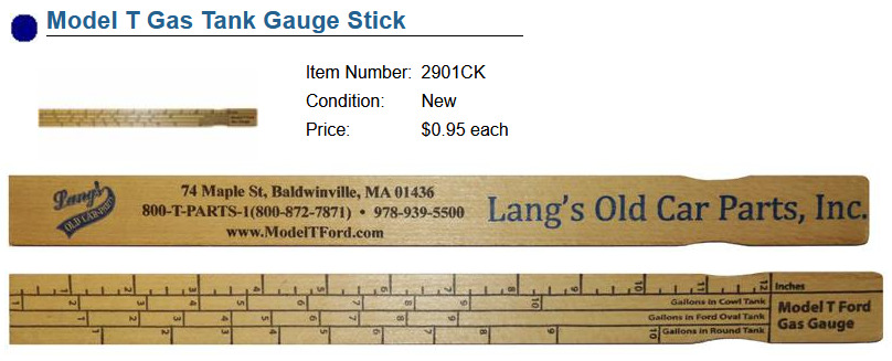

Easier to just purchase one. http://www.modeltford.com/item/2901CK.aspx

So a $.95 stick to measure gasoline, with postage, local tax (if applicable) is cheaper and easier than a DYI stick...O.K.

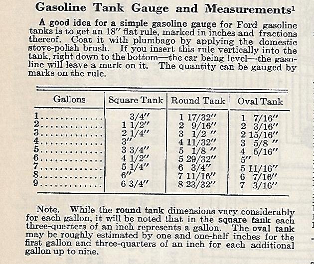

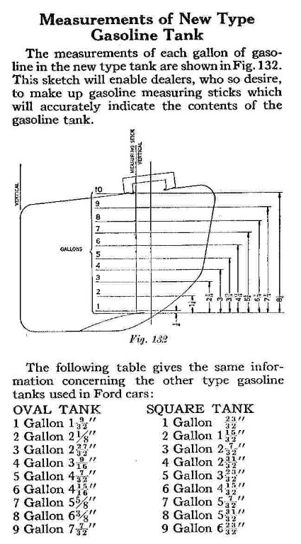

A plain stick will tell you the level of gas in the tank. The correct gauge stick for your tank will tell you the amount of gas in the tank.

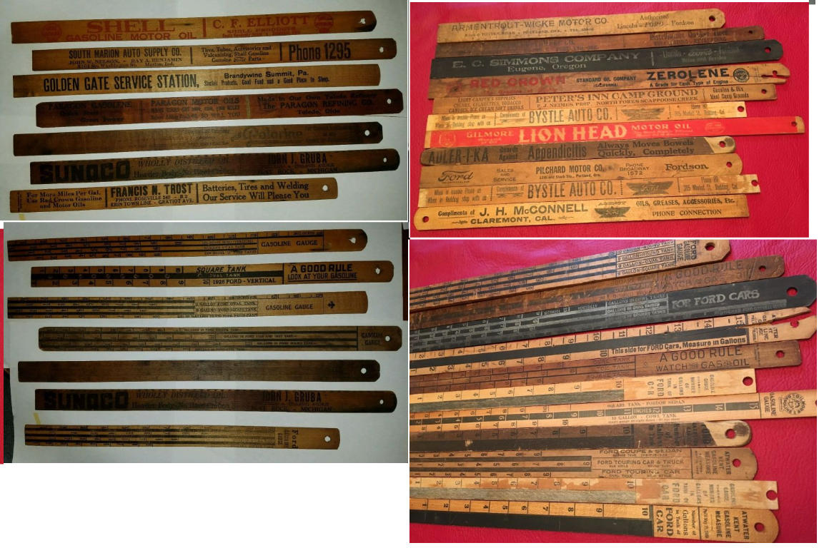

Given the proliferation of branded Gas Stick Gauges _ I would suspect that they were used for advertising and likely given away for free. Unlike today

I would suspect that they were used for advertising and likely given away for free. Unlike today.
Like today. Dave Nolting gives them away for advertising, and Steve Lang brought a bunch of Lang's sticks for the freebie table at the midwinter Model T clinic last month.

The (long gone) local Ford dealer gave away wooden yardsticks with the business name, address, and phone number printed on them.

Not exactly the same - they sell them too

Love the original, promo sticks.
