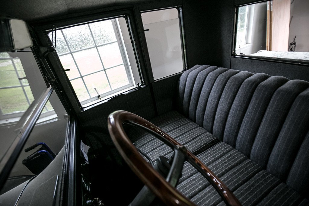

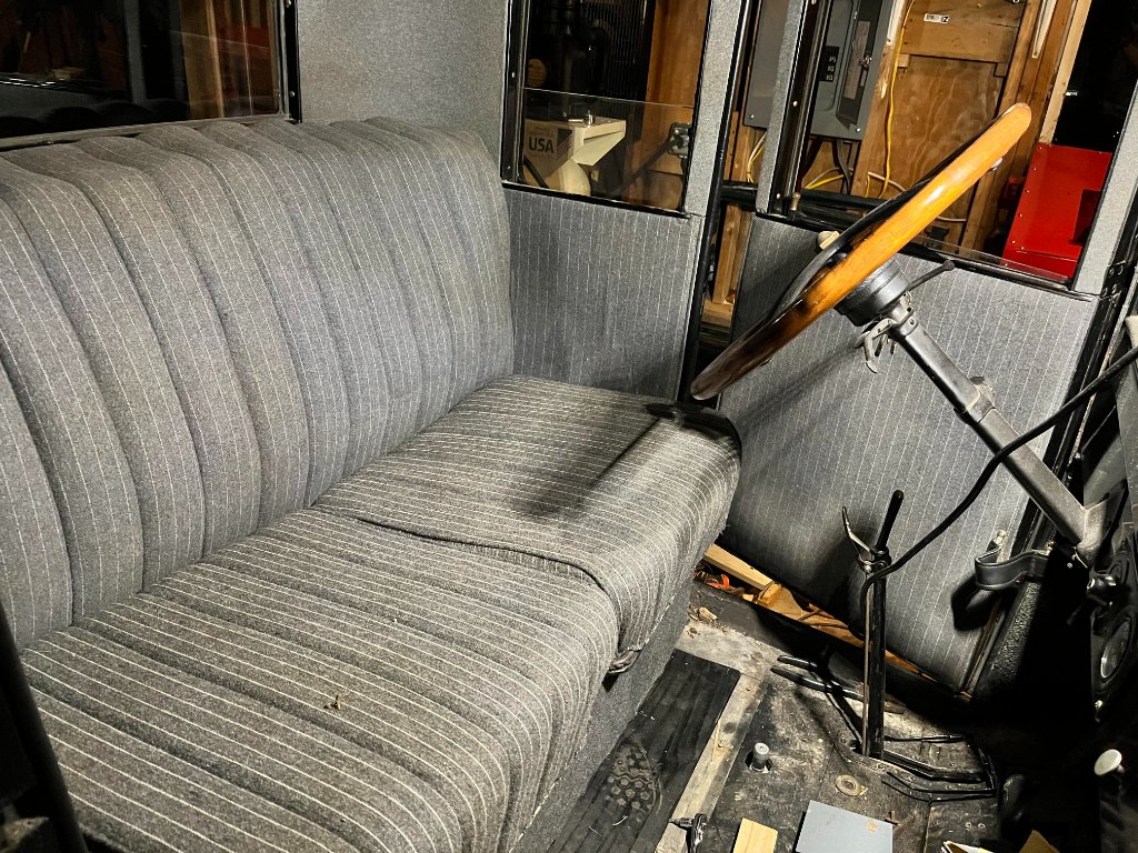

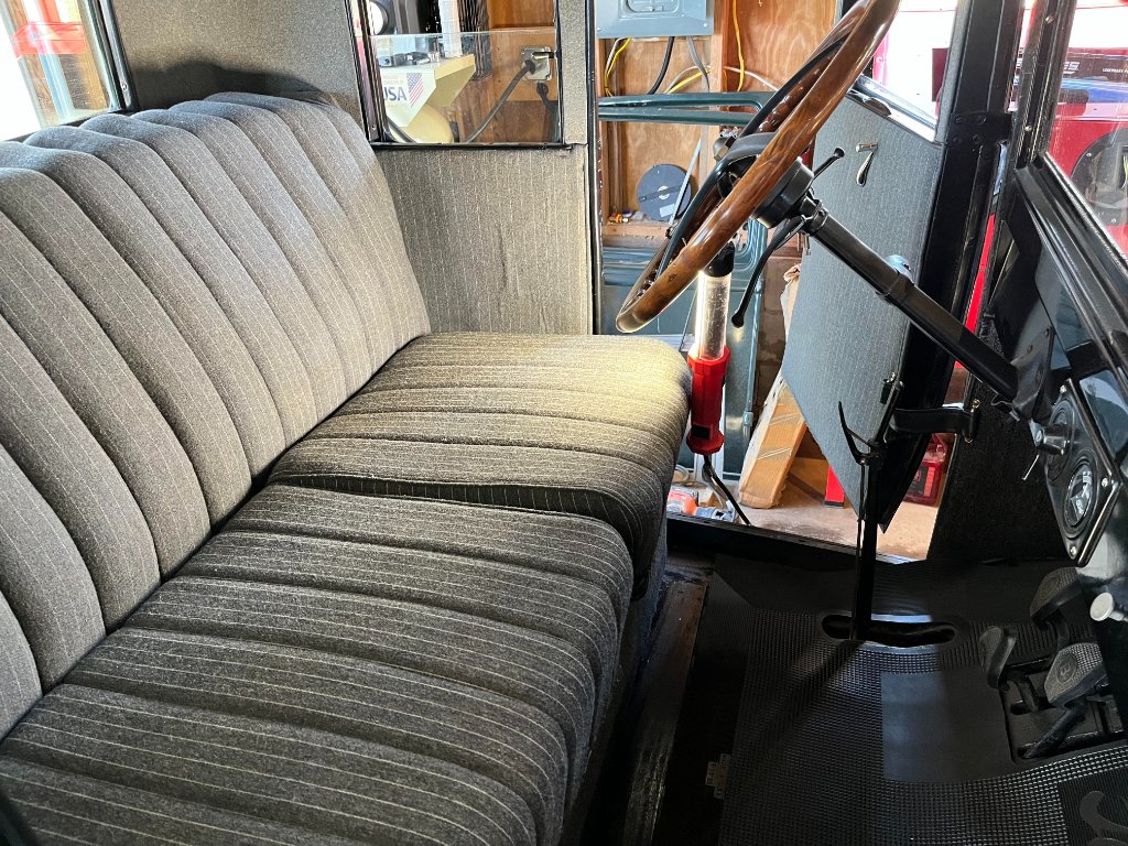

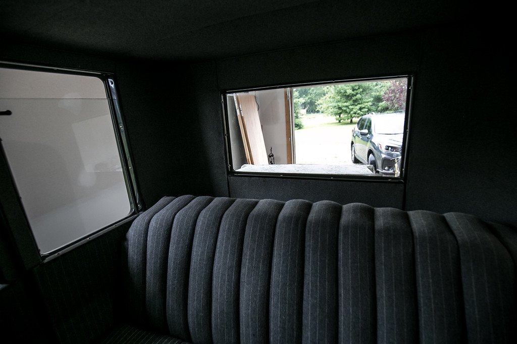

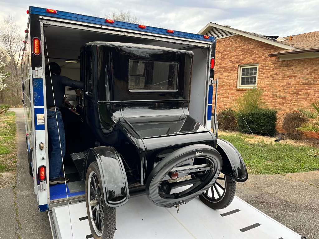

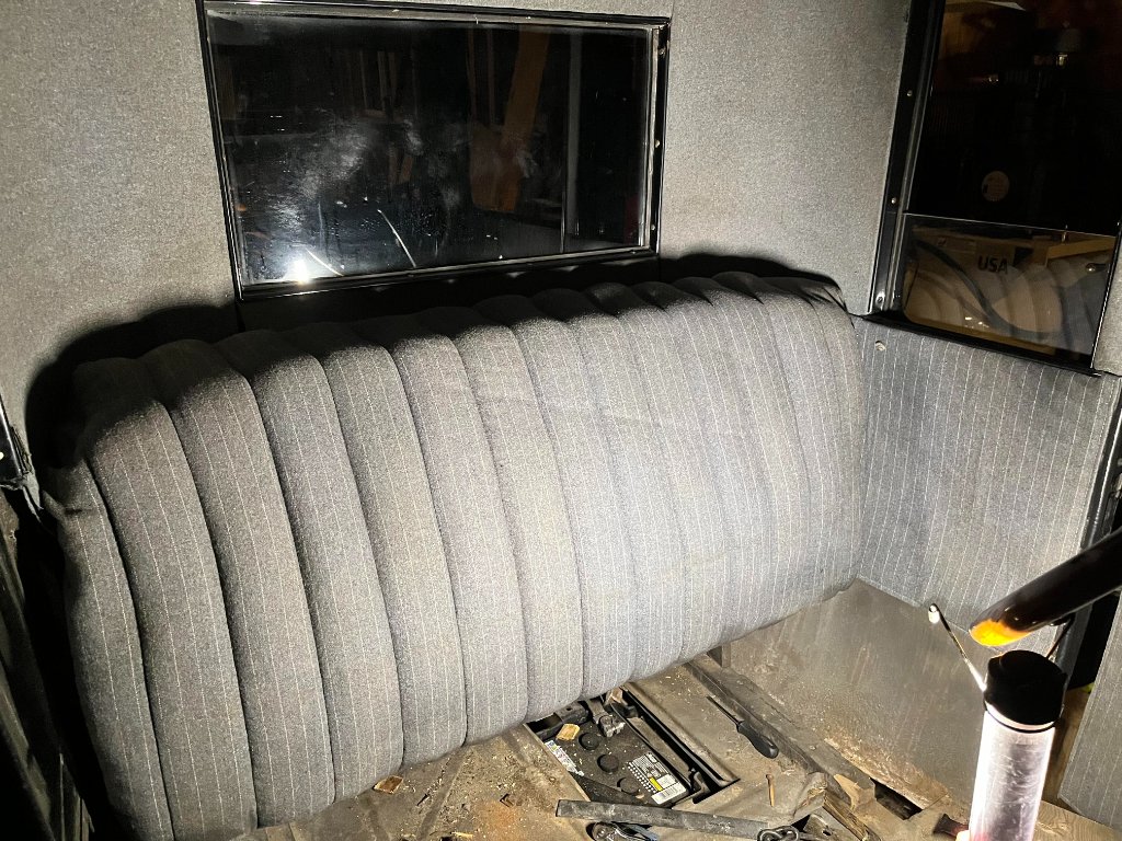

So hear is what I started with. As you can see the package shelf takes up a lot of room and for a tall guy like me it's worth the effort to go after that valuable Real Estate. This will involve removing the package shelf, removing the gas tank, removing the seat riser and then reconstruction.

Bill lives with in an hour of me and has hauled a few things for me, he goes out of his way to help, I have turned a few close friends on to him also!
Bill was outstanding and if I ever need something transported I will be giving him a call !!! Bill told me he has driven over 4 million miles accident free and to me that speaks volumes.

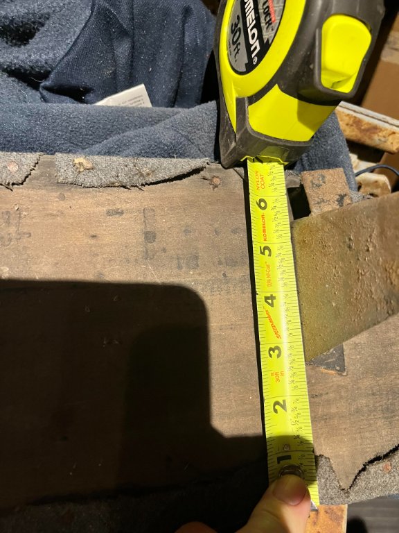

Post by Model T Ron » Wed Mar 01, 2023 10:06 pm

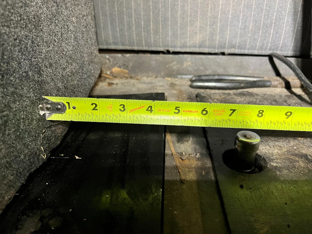

Well I had a chance to get the seats out along with the package shelf. After measuring the edge of the package shelf to the bracket that screwed into the wood framing it looks like I will be able to gain 5 1/2 inches of legroom.....to me that is amazing and a total game changer in the area of driver comfort.

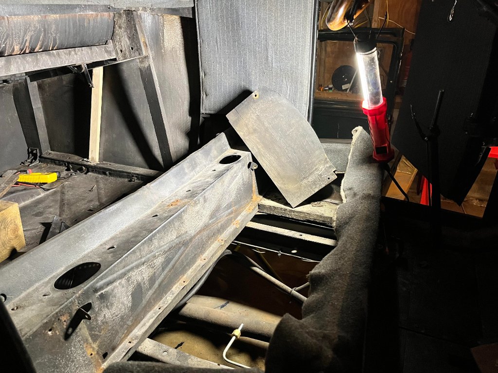

Post by Model T Ron » Thu Mar 02, 2023 7:25 pm

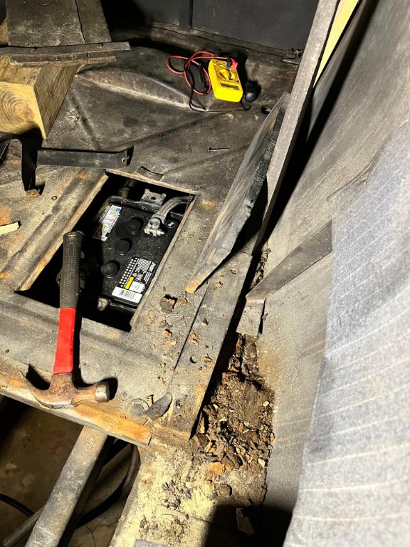

Got the gas tank out late last night and I am working on removing the seat riser tonight. Cannot wait to drive a T is utter comfort for the first time :lol: :lol: :lol: :lol: :lol: :lol: :lol: :lol: :lol: :lol: :lol: :lol: :lol: :lol: :lol: :lol: :lol: :lol: :lol: :lol: :lol: :lol: :lol: :lol: :lol: :lol:

Post by Model T Ron » Thu Mar 02, 2023 8:38 pm
After some effort the interior slowly began to come out.

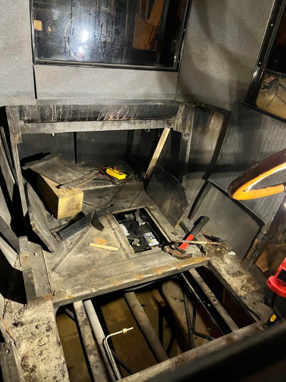

Post by Model T Ron » Thu Mar 02, 2023 10:59 pm

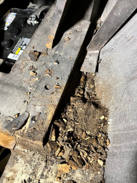

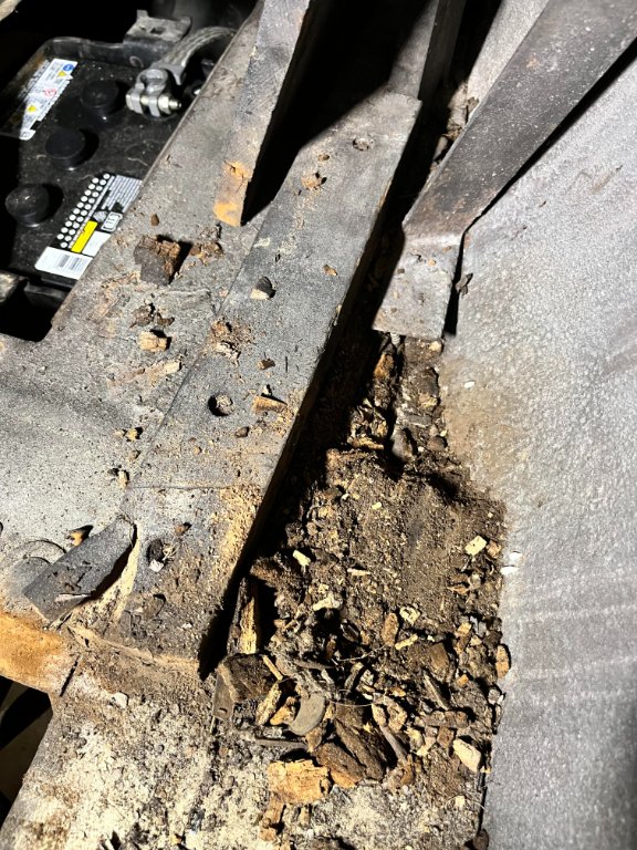

Well I got the seat riser out but I came across some hidden rot below the back window on the drivers side so this will slow me down until I can get all the rot out and make a wooden replacement part. any recommendations are appreciated.

Post by Model T Ron » Thu Mar 02, 2023 11:01 pm
Hear is the 24 Coupe with the gas tank removed along with everything that needs to come out.

The photos show what happens over many years of rain and moisture getting into the low areas of closed car bodies. To replace the wood in that area probably means the main wood frame rail also. To be able to get to the lower section of the body wood itself you would need to remove the body sheet metal and that’s a major undertaking. The other side is probably in the same condition.
I would clean out the dirt and rotten wood and fill it in somehow to be able to keep it level with the remaining lower body wood.
After nearly 100 years original wood begins to deteriorate and it might be best to leave alone if the body is still pretty stable. Otherwise it’s a wood structure rebuild thats a major undertaking. Time and money would be something to think about.

The right side is solid as can be but the wood on the right side just crumbled in a small area next to the window. I plan in buzzing the bad out tonight and making a patch. Its so isolated that I see no need to do any major reconstruction at this point. Overall I am impressed with the condition of the original wood......should be good for another 50 years or more at this point........with cars this old things like this are to be expected and it could have been much worse.

The 24 Coupe I have had the bad wood almost in the same place. I cleaned it up the best I could and put a patch piece in it and called it good. There are purists that would have rewooded the whole body when finding bad or questionable wood. But not me. Luckily it had only one other place in the trunk and I replaced the bad wood with new as it easy to get to.
My 24 T belonged to my Grandfather and for the most part was not kept in the open. Yours must have been inside during its life too. Model T’s stored or left out behind the house or garage don’t last long exposed to the weather! I’ve seen a few that were and sadly rotted away!

I would not remove the 97% good wood because of a bad 3% lol :lol: Did you screw the patch piece in or nail it?

As I remember since it’s been over 10 years ago seems like I leveled out the wood as best as I could and laid a piece of wood in it. Screwing the wood down worked best since nailing might split the wood. When you screw the patch down and if the hole would be over the main frame rail it would be best to help secure as good as you can since your screw would maybe go into the wood frame rail. Drill a small hole first and the install the screw or fastener. Others might have other ideas how to do it.
Since it’s been opened up the way that it is. Now would be a good time to use air to blow out the years of dirt and debris that’s gotten in the open places between the body sheet metal and wood.

you think you should add glue and clamp it too?

Wouldn’t hurt to pour some good grade wood glue and spread it. Maybe clamp it if you can. I used wood glue in the trunk support piece that I made and you can’t tell the difference. I then added the new replacement trunk floor that I needed.

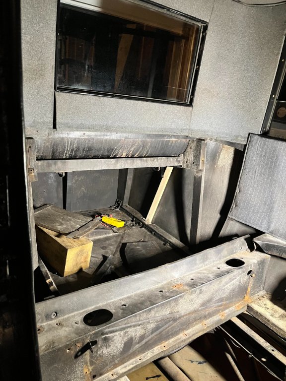

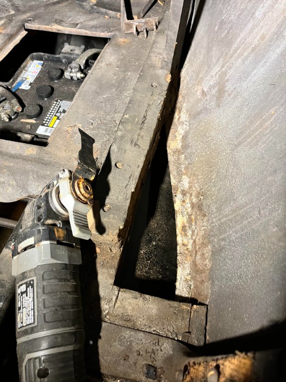

With the help of my good old Buzz Tool I was able to cut the rotted wood out of the floor on my 24 coupe. I cut back to solid wood and boy do you need to be a contortionists ......I sat on the driver side running board with my right hand holding a board under the bad body wood so the tool would cut through the rot and scratch the splash aprion. Then my head twisted around the door opening to see my work and I buzzed the rot out with my left hand (I am right handed). Long story short I think it cleaned up good and I plan on making a patch out of a 2x6 in the morning. My plan it to drill through the original wood and attach the wood patch with screws and glue.

Today I worked on making my wood patch piece and that was a bugger to get right but its now finished and painted.....just need to screw it in. I then moved on to bracing the backrest on the wooded framing sections that once had the package shelf screwed into it. Basically I took a piece of wood a bit shorter than the package shelf and screwed it in across. I then took the metal bracket that was on the package shelf and installed it on the new piece of wood......this lets me hook the backrest in just like it did on the package shelf. I am going to have to remove the backrest to finish reconstructing the seat but below you can see how it turned out. In my opinion it looks just like a pre 1924 Coupe.

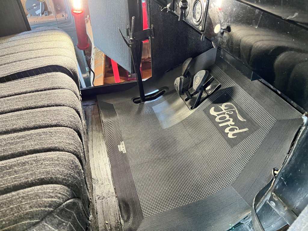

Well I just did a mockup to see if my measurements were right and I got my 5 inches :D :D :D I think it looks just as if Henry made her that way for tall people :lol: :lol: :lol: :lol: . Lots more work to get it all together but the juice was worth the squeeze and look at all that room behind the starter button :lol: :lol: :lol: :lol: :lol:

Post by TXGOAT2 » Mon Mar 06, 2023 9:10 pm
That really looks good.

Thanks Pat. I still have some work to do with mounting the tank and nailing or maybe screwing everything down but I wanted to see how it would look and I am happy with the results. Last night I raised the bracket that I made to get the backrest up to the rear window level and in my opinion it looks better. Not sure if it was that high back in 1924 but the car came to me with it a few inches below the window.
I am very happy about the distance behind the starter button as it looks like I gained 5 1/2 ''. Not sure what the distance is on the pre 24 Coupe body style but I can tell you the 24 now has loads of room :lol: :lol: :lol: :lol: :lol: :lol: :lol: :lol: :lol: :lol: :lol: :lol:

I've never had a car with a starter. I hope with the starter button so far forward won't be an issue. I wonder if it could be recessed to avoid unwanted engagement?

If you start with the ignition on battery and run on magneto, adding a starter solenoid in series with the starter and using the original starter switch to activate the solenoid, with the original starter switch connected to the battery terminal on the ignition switch, would serve to de-activate the original starter switch except when the ignition switch was turned to battery. Using the same connections, you could also move the original starter switch to where you wanted it relative to the seat, and attach it to the floorboard instead of the frame bracket, using a 2 wire flat trailer plug to attach the wires to the switch.

Due to my long legs I do not think the starter switch location is going to be a problem but if it is i see no reason why that could not be moved back as well.

Post by Model T Ron » Tue Mar 07, 2023 10:23 pm

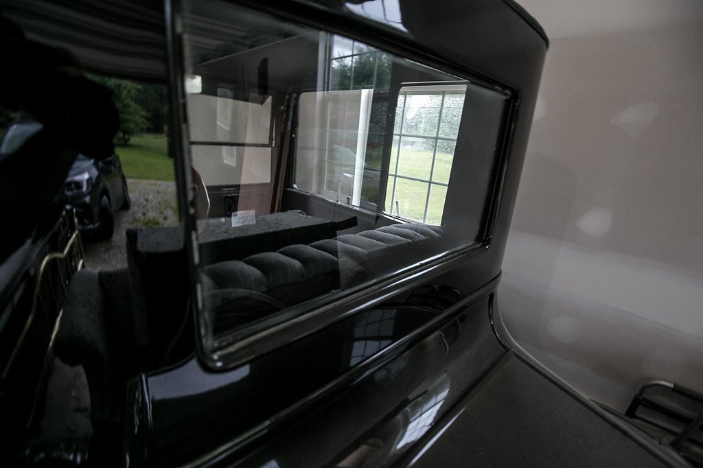

Do you guys think it looks better with the backrest raised to the rear window height? I think it does.
Posts: 1966
Last Name: Tannehill
Location: Hot Coffee, MS
Board Member Since: 2002
Re: 1924 Coupe Gives Back Hidden Legroom
Post by JTT3 » Tue Mar 07, 2023 10:28 pm
I guess the real question is- does your back say it feels right?
Ron really good customization. Best John

Post by Duey_C » Wed Mar 08, 2023 9:33 pm
It sure looks better to me! And the added leg room. Ahhh. I'm tall also. Makes me rethink my love for cramped Runabouts.
John asks it correctly: How's your back like it?
That's not crazy Suzanne. Not at all.
And you could use the driver's door! :)

Post by Model T Ron » Thu Mar 09, 2023 10:13 pm
I knew the pre 24 Coupe's had a bit more legroom and was able to test fit a 1921a few years back to confirm. To be honest I think I found more room in the 24 with a little re-engineering. This modification makes the 24 or 25 Coupe amazingly roomy and trust me it's worth the effort if your tall. At 6'3'' and having long legs I have more room than I need and can actually stretch out.
The seatback feels much better being raised to the back window level so that's it's new home as far as I am concerned..... It also looks better proportioned in my opinion. I hope this trend someday helps someone else find the legroom in a 24 or 25 Coupe that they are looking for. Its not hard to do just take your time and if you find hidden rot fix it.....
Ron

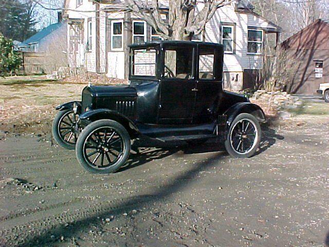

I have a 1924 model year coupe. As has often been stated, people were smaller (in stature and girth) during the first part of the previous century and earlier.
I am 5'4", which makes me Model T sized, fun size. The car fits me quite well and I can use the driver's door comfortably.
I really appreciate the package shelf and use it all of the time. As Susanne commented,with a turtle deck to carry things, a package shelf may seem superfluous. I use the shelf to hold my sun glasses case, a small leather case for car registration, insurance card, and other papers, sometimes a water bottle may be there, my cell phone, my jacket if it has become too warm, maps, a small first aid kit, and small purchases made when out and about, or even an umbrella.
I Love my coupe.
Bill Harper
Keene, New Hampshire
Model T Ron
Posts: 322
Joined: Tue Jun 08, 2021 12:31 am
First Name: Ronald
Last Name: Bakow
* REQUIRED* Type and Year of Model Ts owned: 1915 Model T Touring
Location: Troutman, NC
Post by Model T Ron » Sat Mar 18, 2023 8:52 pm
Mr. Harper at 5'4'' you are in luck that any T will fit you just fine. On my 15 Touring I had to remove the backrest springs and use foam and after all that I just about fit. Now on my 24 I finished everything up today including mounting the gas tank a few inches back and screwing the seat components back in position. At 6'3'' I have never experienced the joy of legroom that Mr. Harper has but with a little re-engineering I too can enjoy my 1924 Coupe. After everything was assembled I picked up all my tools and added a new rubber mat. Very satisfied with how it turned out.

Post by tdump » Sat Mar 18, 2023 8:55 pm
There was a post a while back about reshaping the hand brake lever to provide some room that way,I did it on my pickup and it is NICE to have that extra space. It takes 2 pipe wrenches and a few minutes to do.
Weil worth the trouble.

Post by Duey_C » Sun Mar 19, 2023 12:57 am
That view from the seat looks real fair Ron. Thank you!
Ooh, foam for a Touring seat back. Tim the ol' aviator did something there also but I forget.
Mack, I'm one of the hoodlums to zee the hand brake lever some years back and it is quite an improvement.
A few fellows had issues with/fears about breaking the lever but mine went smooth.
