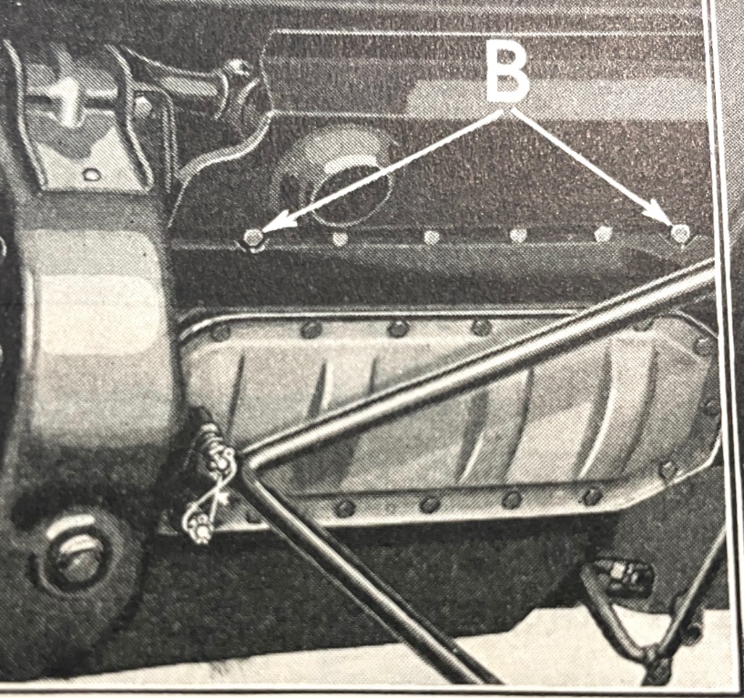

- Posts: 6727
Re: Installation of Engine Splash Pans
No one needs to know an engine pan's "true purpose" to install it. Common sense and maybe a picture in the FORD Service Manual is all most folks need.

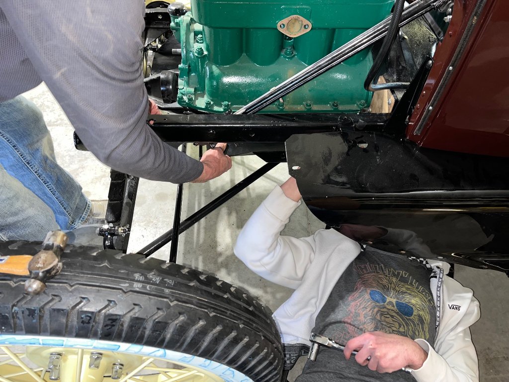

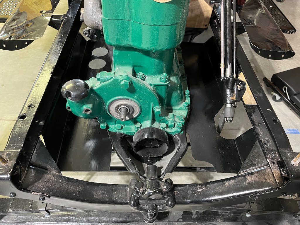

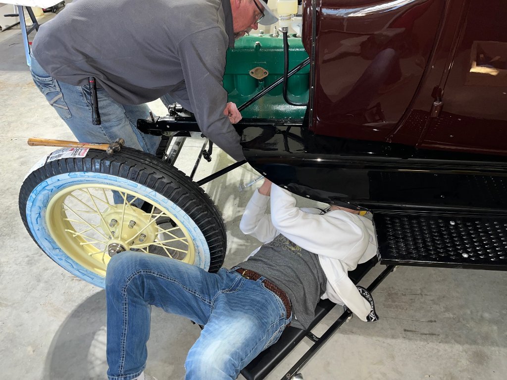

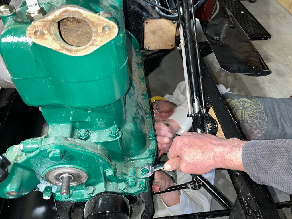

John K. said "Let us know how fun or grief you find the job and how you did it."
It was fun!! My son and grandson did it as I watched and instructed, as shown by the photos (fenders not on!)!!!
Bruce
Bruce

- Posts: 5166
Well you cheated!
Thats probably how Ford did it.
With no fenders its an easy one man job.
