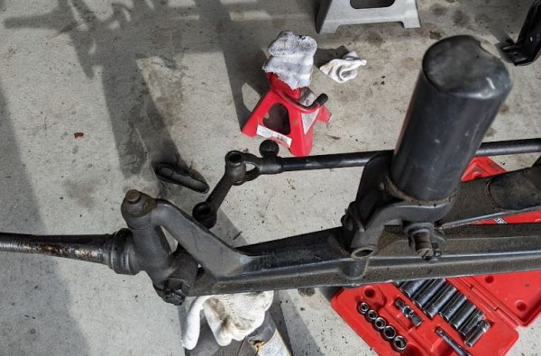

I know this has been discussed in the past, but I'd like to get some current thoughts on the topic. I recently bought a '13 touring with its original front axle/wishbone assembly. My intent is to tour with the car once I get it sorted out. I know that the early wishbone attachment on the top of the axle only can potentially be problematic. When I look at other similar cars in the club, about half of the early cars have some type of wishbone reinforcement ranging from rickety to robust. I also see some commercially available bracing kits (Lang's) and other possible solutions (EBay). I'm a purist at heart but I don't want to end up in a ditch. Thoughts? Recommendations? Thanks to all in advance.

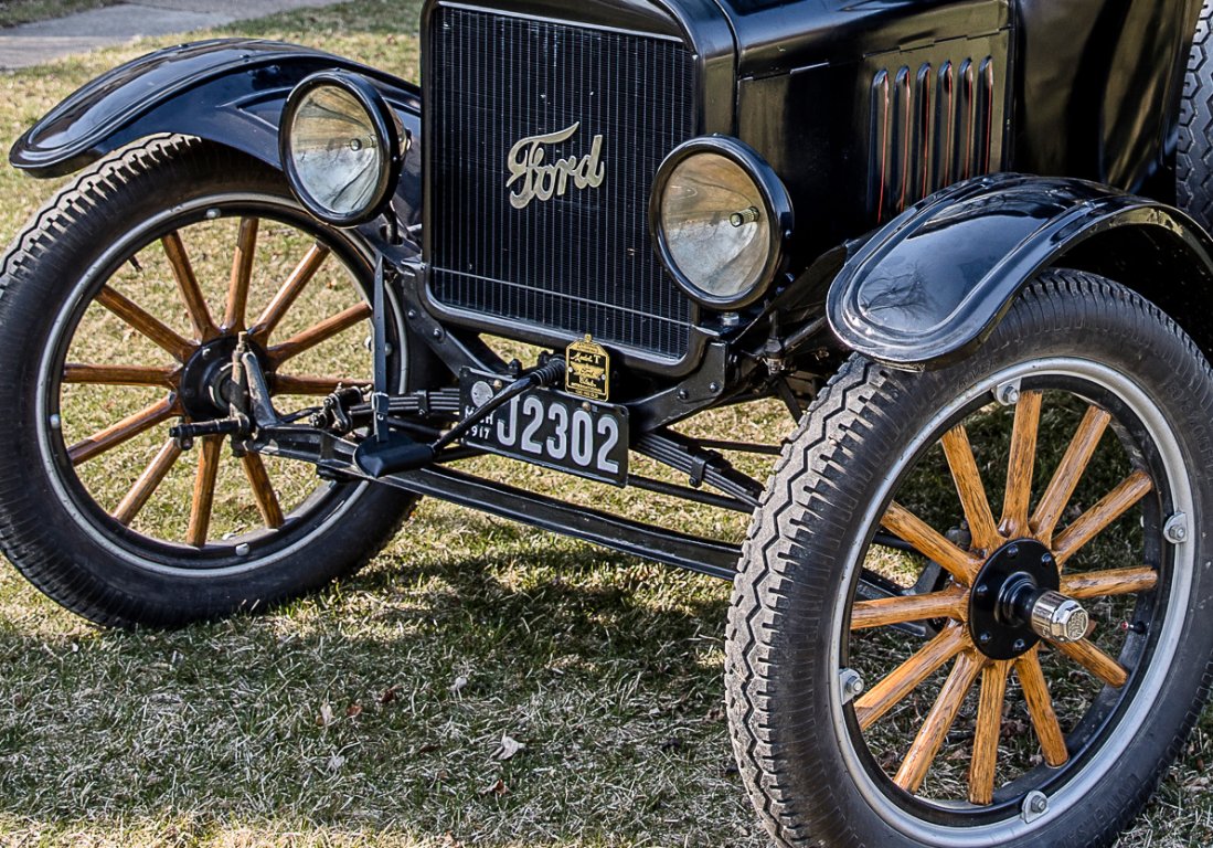

I have a 17 with the upper wishbone attachment. I maintained the original and added a supplementary wishbone attached to the bottom of the axle. Such a "fix" was not uncommon back during the 1920's so adding it is historically correct.

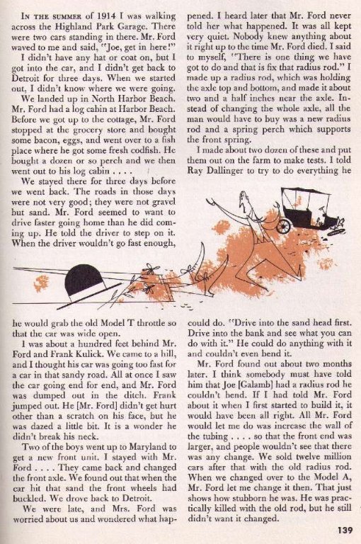

Henry Ford experienced a T going out of control for that reason not far from where I live in the Thumb of Michigan. This article tells what happened to him - I believe the writer may have remembered the year wrong and a failed to remember that the Model T received the improved wishbone in 1919, well before the appearance of the Model A. Also, there is no "Maryland" in our part of Michigan. There is a Marysville but it wasn't founded until 1919. Despite the inaccuracies, you get the gist....

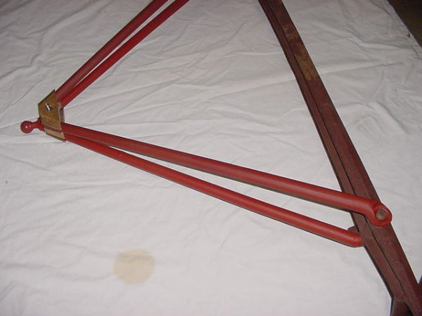

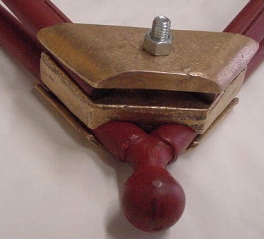

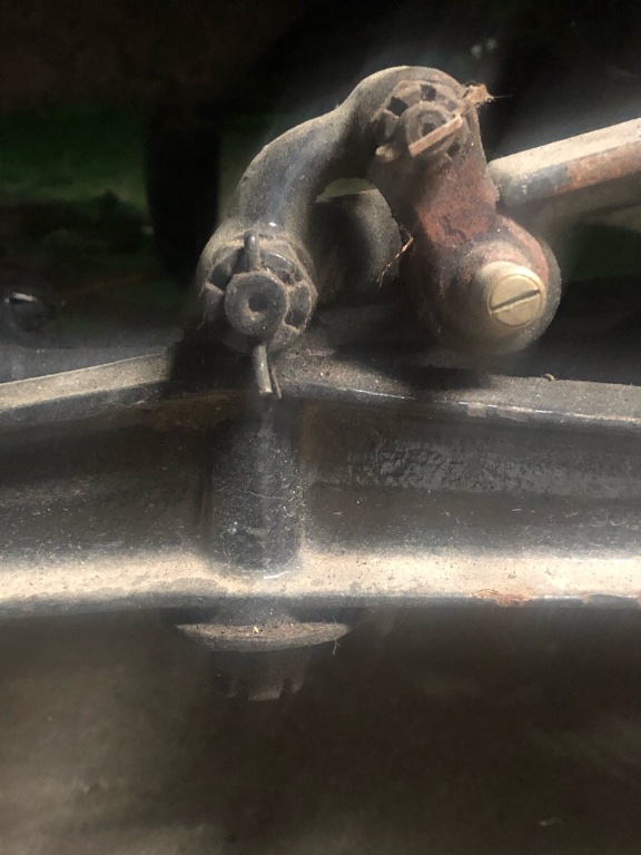

DO NOT USE A LATER AXLE ASSY. That’ll be obvious from a block away. Buy this robust bronze support bracket for an additional under axle wishbone. You’ll need a cheap late wishbone (about $15 each) and cut off the ball end to fit. Then grind down the 2 forward ends that fit under the axle to 1/4” so the early castellated nut can be cotter pinned. Some use a thin driveshaft pinion nut here. This will, in effect give you 2 wishbones - an original + underaxle insurance.

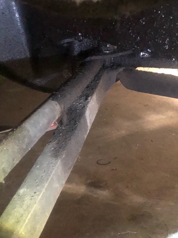

I found an old time adaption for this fix on my speedster. The front axle I found had a later under axle wishbone adapted to do the job. They had ground a goove in either side of the ball so it nestled between the arms of over axle wishbone, and fashioned a clamp much like the brass one shown. It was made from a couple of old cultivator points which had the manufacturer's logo stamped in it. Mounting it this way pushed the wishbone well forward at the front. The solution was simple. They cut off the forged ends, flattened the ends of the tubes, and drilled them to fit the perch.

I used the heavy duty bronze repop pictured in the runabout to the left many years ago with a cut down later wishbone and now need to do the same for the runabout on the right. I think the part came from Califunny but don’t remember where ? Anybody know ?

I use the same bronze wishbone clamp pictured by George House. I ground a chamfer on the nut and in the eyelet that attaches under the axle. I also ran a round file thru the castellations on the nuts and rounded the bottom of the notches. That let me easily tighten the nut and install a cotter key.
Here's what it looks like (Upside down) On the car - unless you know Model T's well, it isn't noticeable.

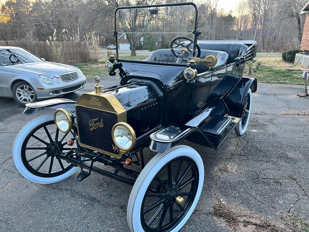

I got the brace from Lang's that was mentioned above for my 1915 Touring. I do agree that on good roads you could go without it but you never know when a pot hole can sneak up on you and why take a chance You could make one however the Lang's brace looks like original equipment and only a T man would know it's there. It comes primed so you will need to paint it and do not forget to order the thinner nuts......its only a 15 minute install so get it and forget it

Thats it Roger ! Thanks ! Looks like price has doubled but that figures in Biden’s inflation.
I’m ordering one today.

I have a over & under wishbone, floating rear safety hubs, disc Brakes, demountable wheels, electric starter, LED lights and a rear brake light. All added for safety and durability. To do so was my choice. I have no issue with people who make different choices about their cars. The argument "If Henry didn't do it" doesn't hold much water with me because we all know he was cheap. What do you think created the huge aftermarket in Model T accessories back in the day? If the cars rolled out of the factory with everything people wanted already installed you wouldn't have had an aftermarket.
Nothing I've done with my Model T has changed the fundamental nature and looks of my car. If the next guy wants to change it back it wouldn't take much to do so. As has been said many times before, "To each his own...."

Jerry, Ford did not offer a retrofit part for the early cars. Ford did recognise there was a problem with the design, and move the wishbone to under the axle. Fitting an aftermarket extra addresses the same need.
